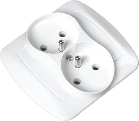

    Hello, I have a 400V socket and I want to make 230V from it. I have a plug for this socket, when I dismantled there are 5 pins: l1 L2 L3 N and some strange sign where should I connect the cable so that there is 230V voltage in the socket ??

    I assume that you have a 5-wire installation in your home.
    You connect the brown cable to L1, or L2, or L3
    You connect the blue cable under N
    You connect the yellow-green cable to this strange sign (the thickest pin), it is a protective one.

    Buddy Aleksander_01 to a 230v socket So how should I connect ??
    Added after 10 [minutes]:
    Because there is a pin in the 230V socket and what color of the cable should I connect?
    Yellow-green to the pin
    on the left brown
    on the right blue
    on the left brown
    on the right blue
    ... and the pin should be at the top or the bottom .....? :)

    Pin at the top.
    Pin at the top.
    ..... and what will such a nest be like ...? :) How to Wire 400V 5-Pin Socket (L1 L2 L3 N PE) for 230V Single Phase Output?

    Buddy Aleksander_01, everything works as it should :)

    Someone noticed that this socket was secured because it cannot be bigger than 16A.
