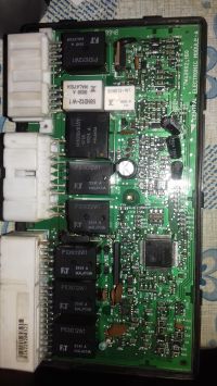

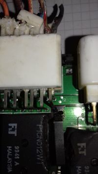

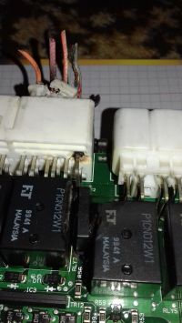

    Ranzou
    Hi. As you can see in the pictures there was some short circuit on the pin from this longitudinal resistor I will add that the right lamp has stopped shining and the airbag indicator is on all the time. I hope the photos are good enough. If anyone knows what problem I have here and what could be the cause of this fault, please answer. If anyone knows which plug-in is responsible for, I will also be grateful. It's best if I knew what devices this smallest plug is going to, I'm afraid to connect the second module a bit so that the second one won't break. Thanks in advance for your help. Best regards. Volvo S40: CEM Module Fault - Short Circuit, Right Lamp & Airbag Issues, Identify Connections Volvo S40: CEM Module Fault - Short Circuit, Right Lamp & Airbag Issues, Identify Connections Volvo S40: CEM Module Fault - Short Circuit, Right Lamp & Airbag Issues, Identify Connections Volvo S40: CEM Module Fault - Short Circuit, Right Lamp & Airbag Issues, Identify Connections

    Poor ankle contact for me.

    PREDAT
    Posts: 525
    Help: 76
    Rate: 141
    Due to a weak contact in the cube, it would not burn the resistor and do not melt the housings of neighboring relays. Obvious short circuit on the cable coming out of the controller.
    Maybe you should start looking for the cause from the lamp not working?
