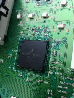

    I have the same problem, CEM-DE51 error came out under VIDA - no communication with clocks.
    Several days the clocks work, some not.
    Meter harness checked, CEM removed and impregnated with Contact.
    The car was with several electromechanics but to no avail ...

    p.wisniewski90 wrote:
    pervaded by Contact
    Let's hope not WD40. I recently had such a case, PCB practically eaten.
    Give a photo of a PCB, I've never done one, but I do S60, V70 and XC90 from 2000-2005 every day, maybe for a similar reason.

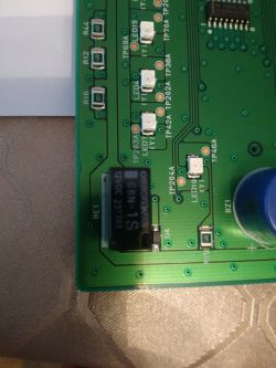

    It's good that a colleague asked on prv, because the problem with the electrode is that when you add something to your post, no one gets a notification.
    At the beginning, carefully transform this ball of yarn. This should solve the problem if you don't let me know.
    You can wash the nail polish, even IPA, but you have to wave a little.

    If coding a new counter board does not help, I will resurrect the old counter :)
    I bought the board itself and after connecting it to the beam I see that it can come out of this after switching the software :)

    So the topic was solved in my case.
    I have a diesel and the plate I bought was from a petroleum engine.
    The whole "program" was copied from old clocks (they were working then :) ) and uploaded to a new board.
    Turnover does not distort and everything works the most.
    If this helps someone, everything has been programmed after the OBD with the SMOK programmer
