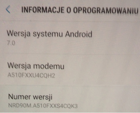

    As in the subject, I had an Android 6 phone and everything worked fine. After upgrading to 7nougat, I lost the ability to turn on WiFi. Not that it does not see any networks, it just tries to turn on "on" and so much on the topic - the slider returns to the OFF position.
    In addition, I noticed that Bluetooth also does not work, for me it is less important, but maybe it has to do with WiFi. With Bluetooth, it sometimes turns on and displays devices, but I can not send anything.
    I've already tried the factory reset, but with the wipe I noticed something disturbing:
    Samsung A5 - SM-A510F: WiFi & Bluetooth Malfunction Post Android 7 Nougat Upgrade
    I also tried recovery from a smart switch, but I have to enter the recovery code I do not know. The phone is from Germany and it turns out that someone was already doing something there.
    I also tried to upload the Polish Xeo Softs from Odin, German DBT downloaded from SamFirm, some progression when I uploaded DBT with Android 6 marshall, because with wipe there was no error.
    Anyway, there is no WiFi, no switching, and my hands are already falling :(

    I do not know if I understand correctly, but when I try to install software with smart switch I get a message that I will install PDA, CSC, PHONE version with CKQ3 terminals.
    After installation, the version number changes to just that, but the modem version remains unchanged:
    From what I read the versions should be identical? It's a damage to the module, it's just weird that after updating the android from 6 to 7.

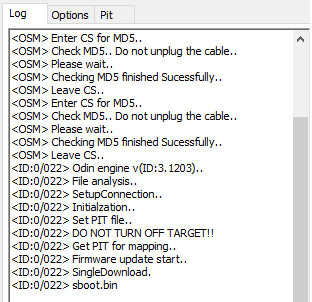

    In the end I sucked in, I started, but from what I see it or the program has hung up, or waiting for PiT?
    Added after 16 [hours] 24 [minutes]:

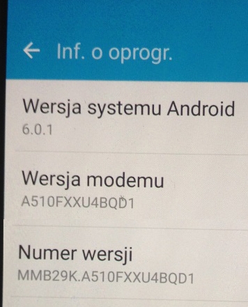

    I have a small problem here, because the file I downloaded from your link did not want to take off at all.
    So I decided to put on the phone system 6.0.1 where the wipe was not an error E: misc partition like from the photo from the first post:
    Here in this system, the modem version has also changed, theoretically correct because the same as the software version:
    The attempt to upload your "recovery" has failed, probably at boot.bin:
    Yesterday I returned to the old "working systems" several times and with each trial I was blurted by the "System Rev. Check Fail" error with the differences between DEVICE and BINARY numbers, DEVICE: 1, BINARY: 0 - and I had DEVICE: 3, BINARY: 4.
    I am currently loading the phone again, because it lay all night on the "Recovery SMartSwitch" display - after charging I will make further installation attempts.
    If you have any suggestions, please write to me if this file from the link is definitely in my A5 version. When searching for a firmware on a sammobile, 3 versions are available for selection:
    My model is A5 (6) SM-A510F or the middle option of choice.

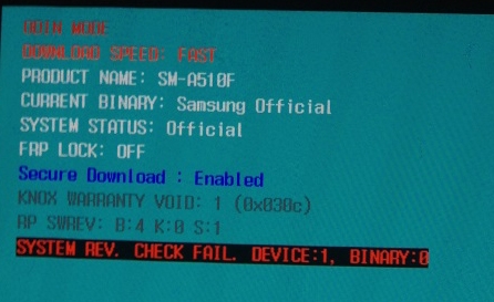

    I can not install this because it is binary secure: /

I see “System Rev. Check Fail (DEVICE x, BINARY y).” What now?
Your phone’s bootloader binary level is higher than the package you’re flashing. Samsung blocks downgrades after a bootloader increment. You must flash same‑or‑newer binary builds matching your CSC. This is normal and protects the device. [Elektroda, wentyl215, post #16886081]
