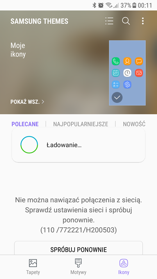

    How can you roll back / reboot Android 6.0.1 that was perfect for my needs completely. 7 is terrible
    If someone wants to know why I want to switch back to version 6.0.1 read my statement below.

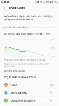

    Hello. Yesterday, an update of my Galaxy J7 2016 (J710FN) to Android 7 popped out. Earlier my phone hung several times for a year. And I didn't have any problems with it. At the moment, i.e. after yesterday's update, the phone has become inoperable. It freezes, it doesn't run smoothly, Wifi has moments when it doesn't work. Packet internet is extremely slow. I am not getting application notifications. The upper beam has become completely useless due to its hopeless appearance. The clock on the lock screen looks like **** I was only able to set the screen brightness adjustment bar to be on top, unfortunately, to press the "outside" button which is useful and intuitively placed in the previous version, unfortunately, but you already have to bother with entering the settings ... And what's funniest yesterday I lay down sleep and connected the phone to the original charger / cable and overnight it is about 6 hours charged a few percent ... which can even be seen in the screenshot Reverting Galaxy J7 2016 (J710FN) from Android 7.0 to Stable Android 6.0.1: User Experience
