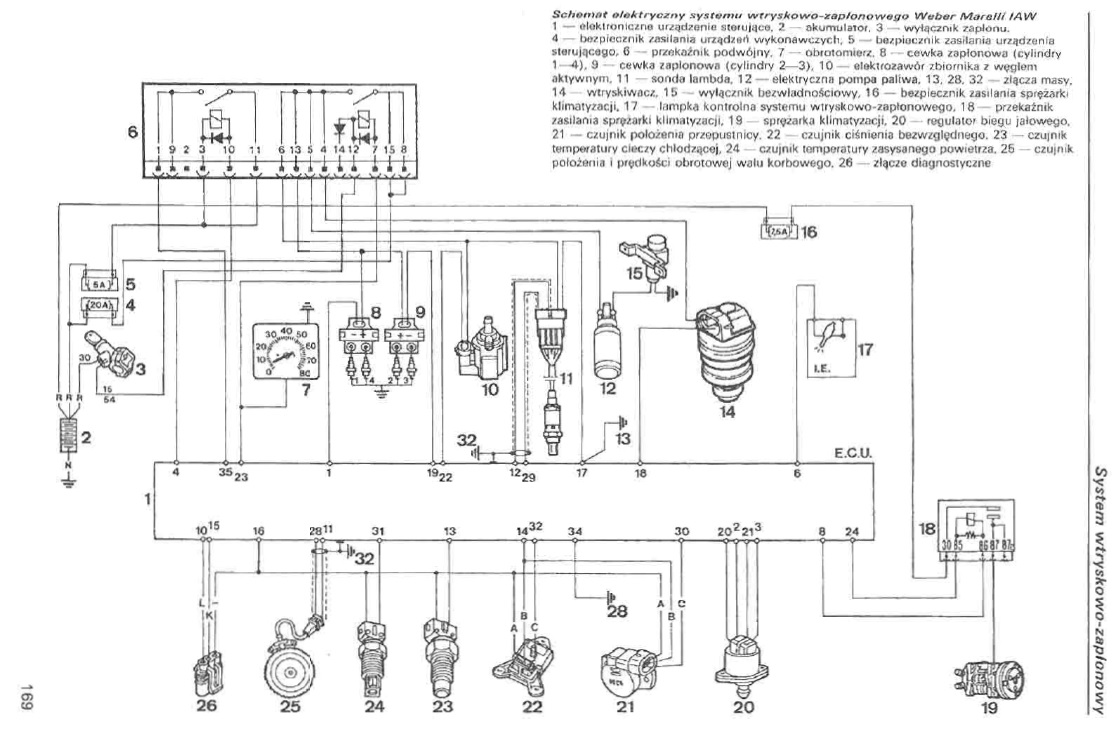

    I need a service for seicento or cinquecento 900 cm3. Alternatively, the electric scheme of the injection system. If anyone has please send. Thanks in advance.

    Hello. And what is your problem when there is one point fuel injection?
    • Seeking Seicento/Cinquecento 900 cm3 Service or Injection System Electrical Diagram - Eric 4784185200_1388249218.jpg (186.93 KB) You must be logged in to download this attachment.

    This diagram is from punto where there is a double relay and such in SC will not be seen (two separate relays in the SC in CC probably only one as I remember)
    However, IAW 6 or 16FM drivers have the same pinology
