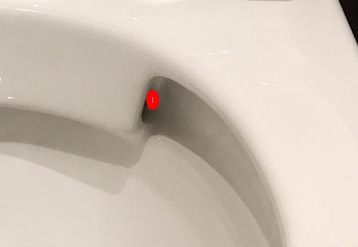

    I have a problem that I bought a new GROHE geberite and the water pressure at the flush is so large that the water splashes out of the toilet around (the toilet without a collar) I wonder if it is possible to adjust the water pressure, but not from the pipe to the tank only from the tank for the water to the toilet. Tory insists that it can not be done and I do not know it.

    I am afraid that there is no cistern with the possibility of regulating the water pressure, there is a regulation of the amount of water to rinse light and heavier things.
    You can try to set a lower level of water filling the cistern tank, this may give lower pressure.
    If this does not help, it will mechanically stop the flow of water from the cistern to the shell.

    Or maybe try to partially close the outlet:
    GROHE Geberite Flush Problem: How to Adjust Water Pressure from Tank to High-Pressure Toilet

    You can change the drain valve, the original Grohe sleeve is used for this, or the cheaper option: 32/25 rubber reduction on YouTube, there is a movie
