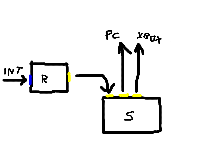

    How can I have more WAN ports now?
    I mean something like this

  • #9 12501803
    shadow4601243
    Posts: 482
    Help: 39
    Rate: 44
    Through the router.
    Write where you got the signal on the WAN.

  • #11 12501987
    salmon
    Posts: 3477
    Help: 435
    Rate: 262
    kryniak96 wrote:
    Directly from the antenna, I think.
    In that case, this "probably" is not enough information to try to mix anything in this network. I repeat - if you have problems with your current router, replace it with a new, working one and that's it.
  • #12 12502172
    shadow4601243
    Posts: 482
    Help: 39
    Rate: 44
    Signal "enters" through WAN and "exits" via LAN. You can't let him go the other way.
    This is how the switch is connected to the router so that you do not have to change anything:

  • #13 12502547
    as-max
    Level 21  
    Posts: 394
    Help: 42
    Rate: 26
    I mean something like that
    Connecting TP-Link Router to Switch: LAN Ports, WAN Port, Device Setup, & Buying Guide
    It all depends on your internet provider. If it gives access to any device plugged directly into the "cable with the Internet", something like this will work, but the PC and Xbox will be in a different subnet, ie the Xbox will get the IP from the Internet provider and the PC from the router. If your provider does not allow multiple devices to be connected to the Internet cable, it will not work.
    And since the router has a working LAN port to which the PC is connected, connect the switch to this place and the rest of the devices to the switch. Of course, the internet to the WAN port on the router.
