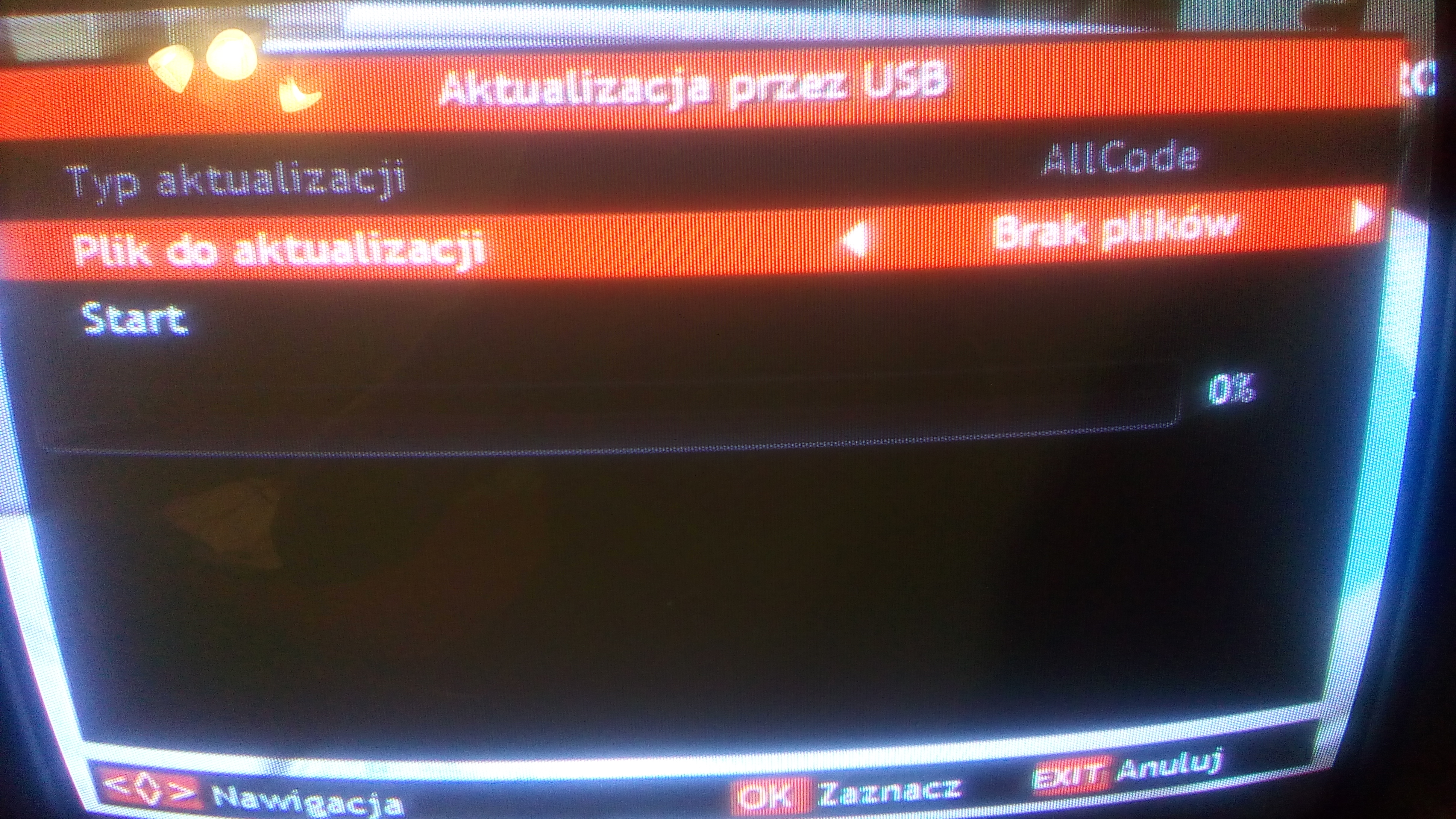

    The file is unpacked and unpacked on a pendrive, unfortunately the decoder cannot see it. Does the file have to be in a specially named folder for this ?? It is true that there is no such mention in the user manual ...
    • Opticum STB HD N1 DVBT decoder - I am looking for a software update IMG_20171217_154218.jpg (4.33 MB) You must be logged in to download this attachment.

    Format the flash drive to FAT32, preferably with a small capacity (flash drive).
    ... Place the unzipped software file in the root directory of your USB device and insert it into the USB port on the receiver ....

    After extracting to a USB stick a clean file without a folder. USB stick no more than 4GB
