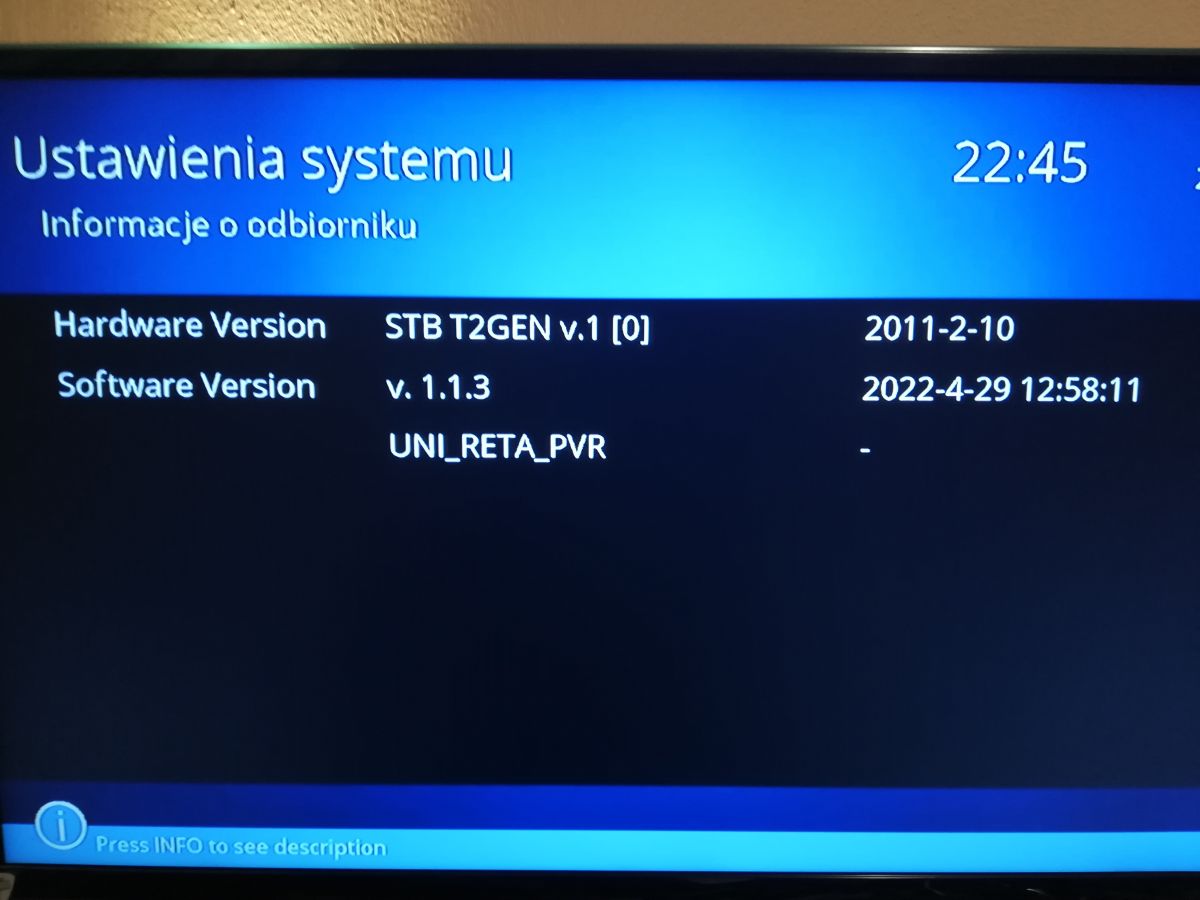

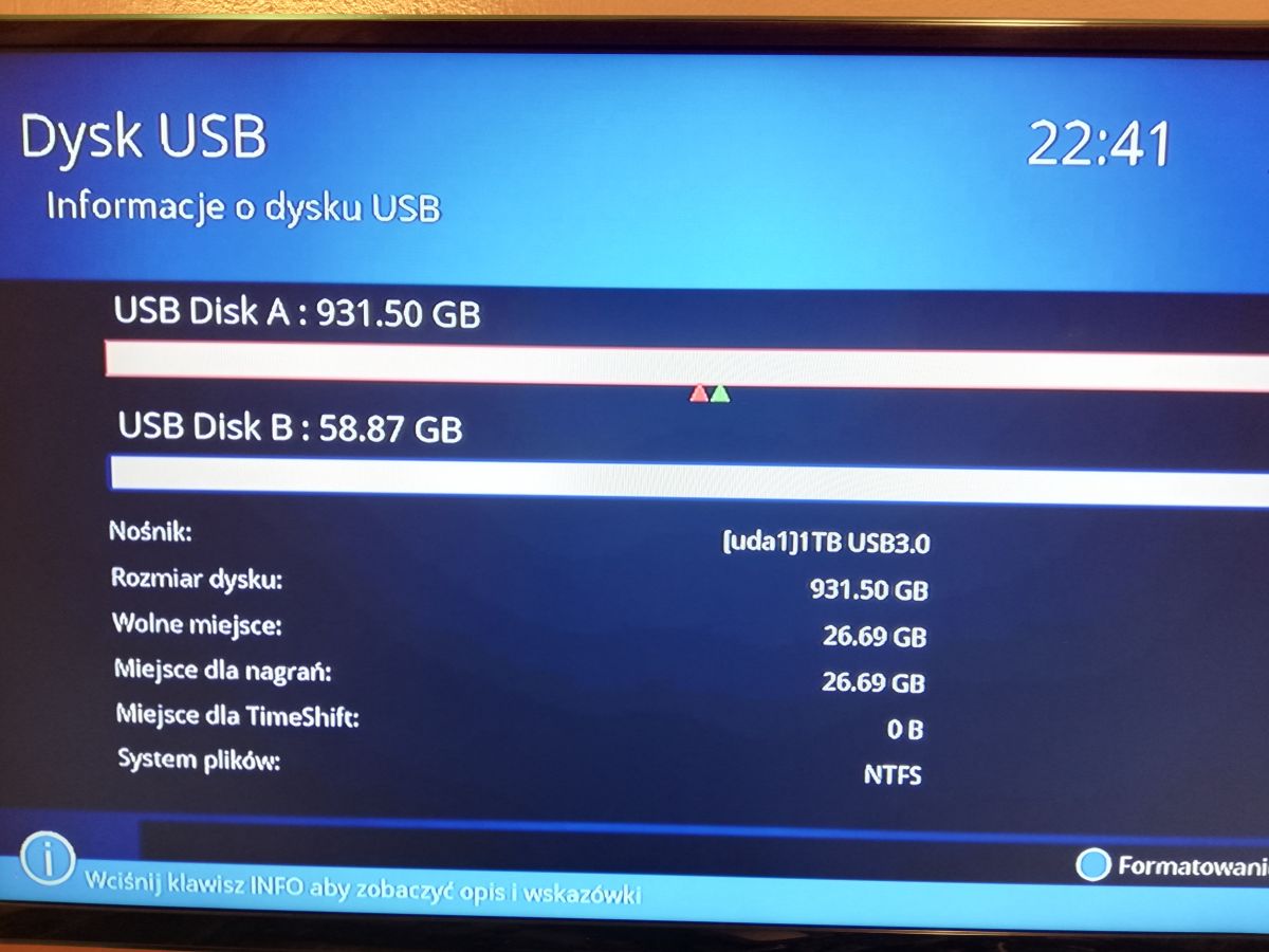

    You can try to use a USB HUB with its own power supply so that it takes over the drive`s power supply.
    Unfortunately, I don`t have the same decoder as yours, but I have another one with the same processor and I uploaded it to it
    skaymaster software and decoder support USB HUB.
    I`m attaching a photo from the info menu from Dyku
    SKYMASTER STB M265 Decoder Update Issue - Menu Option Grayed Out
    Here we have a 1TB Samsung drive and a 64GB Pendrive connected
    software version on which I checked it
