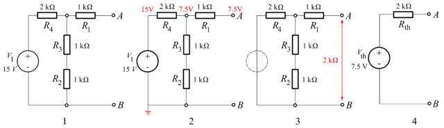

Why Is R1 Ignored in Thevenin Equivalent Calculation With Open Circuit Between A and B?
228 6
  • Open-circuit condition makes R1 carry no current

  • R1 affects only the Thevenin resistance calculation

  • Two-step Thevenin reduction including R1

  • Thevenin equivalent gives 7.5 V and 2 kΩ

  • Correction of typo in Thevenin explanation

The discussion clarifies why resistor R1 is initially ignored when calculating the Thevenin equivalent voltage across terminals A and B in an open-circuit condition. Since no current flows through R1 under open-circuit conditions, there is no voltage drop across it, making it irrelevant for the initial Thevenin voltage calculation. Thevenin’s theorem involves two steps: first, determining the open-circuit voltage (Thevenin voltage) where R1 does not affect the voltage; second, calculating the equivalent resistance by shorting voltage sources, where R1 is included. Once both Thevenin voltage and resistance are found, the complete equivalent circuit accurately models the original circuit’s behavior. When a load is connected across A and B, current flows through R1, and its effect becomes significant. Alternative approaches include shifting the reference point beyond R1 to incorporate it into the equivalent resistance before recombining the circuit. Practical measurement considerations, such as using a digital multimeter with high input resistance, support the theoretical open-circuit voltage findings. The discussion emphasizes the importance of understanding the stepwise process of Thevenin equivalent derivation to reconcile the apparent omission of R1 in initial voltage calculations.
