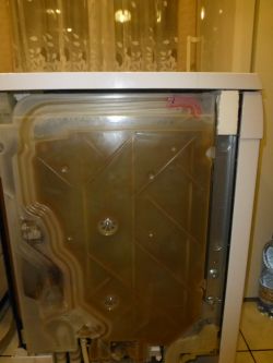

    I have a dishwasher, like the title, with a plastic bottom. I have to get to the pump (it doesn't heat the water). But there are no screws and I'm afraid to open the door to break something.

    A bit not this department :D :D :D . As far as I know, in this brand's products we do not start to disassemble the dishwasher from the base (bottom).
    Maybe a manual of a similar model from this manufacturer will be helpful for you. Compare this type of dishwasher with yours.

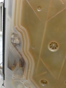

    Thank you for the quick reply, but I have a completely different type of dishwasher. I have already dismantled two sides. On the left is a water jacket. In general, the dishwasher showed error code E8 (mismatch indicates too low fluid level in the sump). During this failure the circulation pump does not work and the water is not heated (so much in the description of this error that is why I need to get to this pump). By the way, can anyone advise on how to clean this water jacket because it is seen that it is contaminated.

    The type of dishwasher is different, but the construction is similar to a similar chassis. In general, you should rinse the dishwasher with mineral-free water and impurities using a functional filter at the water connection. You can add the right amount of regular table salt and soda. Appropriate mixed DHW water can be used. Repeating this procedure several times should help. Certainly do not use organic acid solutions.

    You will get to the other side. Alternatively, the bottom can be unscrewed to put it "on the head".
  • #7 17211206
    renatan
    Posts: 20
    Replacement of the module where salt is poured and the washing machine works. I'm closing the topic.
