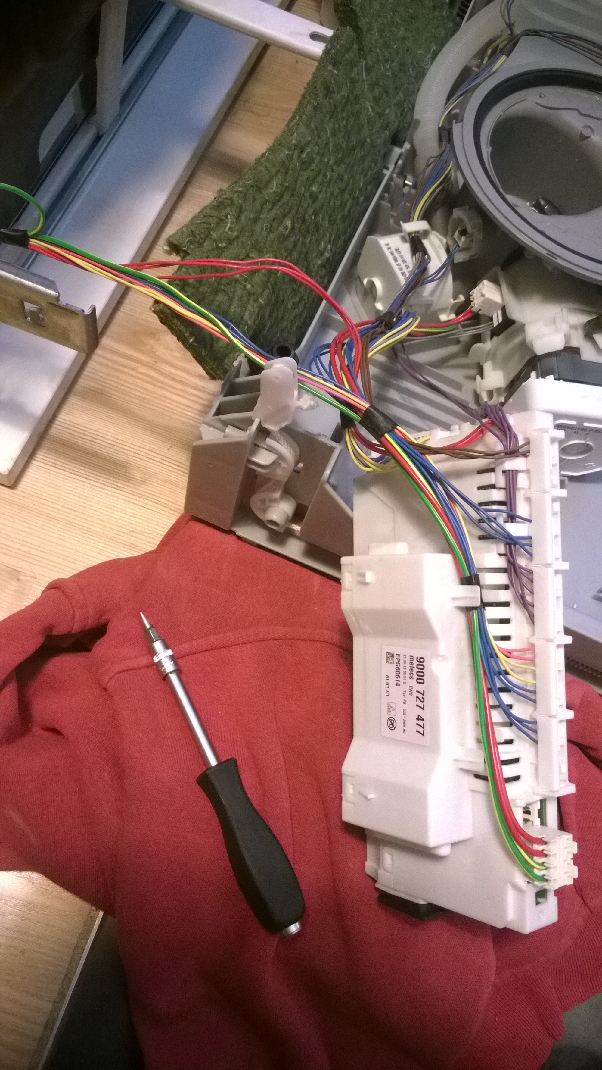

    OK, I can handle this measurement somehow (I have to get a meter) but the problem is that I do not know where the heater is, if I only had a diagram with an exploded view, where which element is located would be easier, and so it is a bit after in the dark ...
    So at the beginning I took a photo of the right side (photo 2) (looking from the front) of the dishwasher, on the left side there is a whole water jacket (photo 1), it seems that it is ok, it is not very dirty, at first glance the elements are unobstructed.
    Bosch SPV50E00EU Dishwasher: Water Not Heating & No Drying - Possible Heater or Relay Issue Bosch SPV50E00EU Dishwasher: Water Not Heating & No Drying - Possible Heater or Relay Issue
    The box with the relays and the pump are probably OK (in the sense of nomenclature), the rest are still hidden. Today I tried to get deeper ... First I tried to take out this white box, but somehow reluctantly, as if there are two latches (visible in the photo) ... One and the other released, but something is still holding, and I do not want to break off. I will see tomorrow, or maybe someone has a diagram?

    I added a photo of the cable layout. Maybe it will be useful to someone.

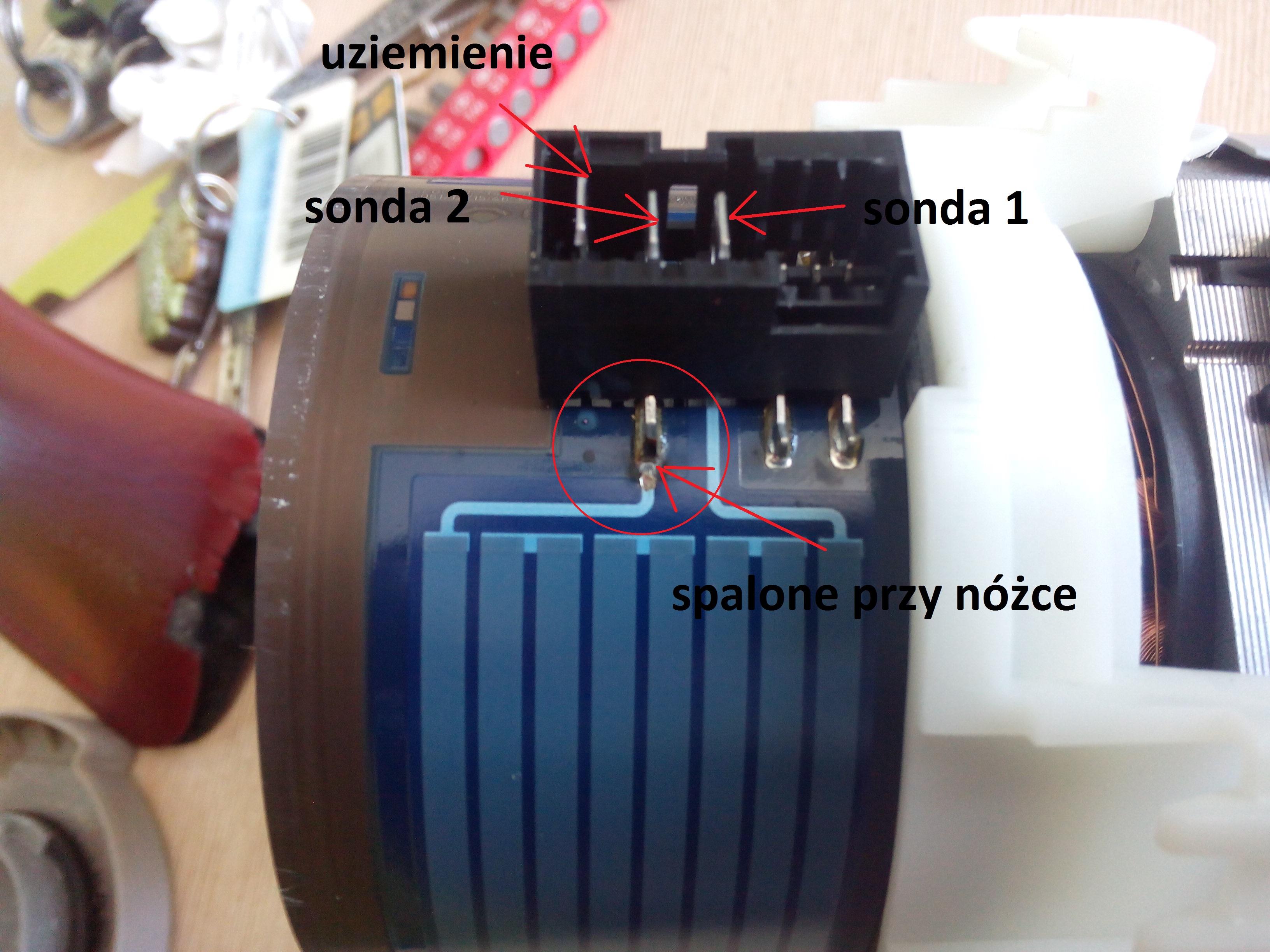

    There is a heater inside, which in my case was damaged. More precisely, the solder marked in the photo (pogalka.jpg) has burned out. After the burnout, traces of soot on the body were also visible. . From what I was able to find out, most of the heaters fall in the same place. After soldering this place, the heater was repaired. However, I decided to buy a new pump because I had doubts about the quality of my solders ...
    Hello, I have a question, how did you assess that after soldering the old heater was repaired ??, did you measure the resistance ?? or something else...??
    Today I disassembled the dishwasher according to your instructions, but after soldering the same path as yours (maybe I soldered badly, but it seems to me that I branded it well), unfortunately the dishwasher does not heat up ..... I was not too surprised because I measured it before assembling with a multimeter, the heater's resistance where the plug enters and nothing twitched on the display, I put the 1st probe where the path on the heater begins, i.e. to the pin in the plug and after the heater runs around, it ends at the second pin several times, because the third is from the ground. ..and nothing: /, a day of work in vain: /.
    In addition, I checked the board where the relays are placed, there are no cold solders for my eye, maybe something else with the heater relay wrong but ... I doubt, I think it's the heater's fault ... because zero resistance in the indicated places, maybe completely the heater is broken ... and soldering will not help, unless I'm doing something wrong ..., advise something.
    Below is a photo of the heater:

    After soldering, I just checked the resistance on the contacts you marked in the photo. For me, the current began to flow after soldering :) in a sense the meter showed resistance. If the meter still does not show anything, it means that you need to continue trying to resuscitate the heater.
    I am not an expert in soldering, unfortunately, it is difficult for me to advise something on this topic, I will only add on my part (as the heater somehow managed to solder) that I put a new solder along the entire length of the exposed path (from the place where the blue coating ends to the leg) . It seems to me that you can also try to reveal this path by peeling off the blue coating, but I didn't do that at home. Perhaps the coating melts under the influence of the temperature of the soldering iron, but as I mentioned before, I am not an expert and you probably need to check it or maybe someone else has the appropriate knowledge about it :) .

    OK, thanks for the hint ... probably the solder is wrong: /, so you can only put some effort into it .... it warmed :) I won't fight anything again. Thanks again.

    Can you connect the heater to the socket outside?
    So probe 1 to zero, probe 2 for 230V?
    I would like to check if it heats up. The meter shows that the circuit is closed.
    Nothing was soldered. Dishwasher with error 09.
    Photo from a colleague from the post above.
    EDIT:
    I replaced the heater with a pump for new ones.
    365 PLN, has been operating for over a week.
    The contacts were good, only what was visible was burnt on the one side of the heater with the plastic housing ..
