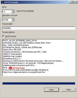

    @pidar Are you sure you format the 64GB card?
    Convert Samsung EVO+ 4K 64GB SDXC Card from exFAT to FAT32 for Camera Compatibility
    The program will not support the 64GB card.
    Out of curiosity, I tried to format it with a 64GB / FAT32 card (previously formatted with the FAT32format program) and an effect like on the screenshot.
    And that's what FAT32format did :)

    Forgive me that I did not specify what camera I am doing.
    ReadLeaf SJ5000 + (codification in the link: http://www.redleaf.pl/redleaf_sj5000.html)
    It supports 64GB card, otherwise it would pop up a message about the lack of a card, there is only a problem with choosing the resolution as I wrote earlier.
    I'm just doing the full format in the FAT32 Format program and it's 15% and time 1h 45m to the end, we'll see how it goes.

    What for
    Chines88 wrote:
    full format
    It is completely unnecessary surgery!
    Chines88 wrote:
    It supports a 64GB card, otherwise it would pop up a message about the lack of a card
    Nonsense!
    This is how it is when you do not read the instruction manual, only advertising gibberish.
    Like a bull in the instructions:
    http://www.redleaf.pl/download.php?files,641.html

    Probably the camera does not detect the 64GB card correctly. Insert 32 and check.
    However, class 10 is the minimum for this camera. I would buy a V60 or V90 card.

    Thanks for your help and advice, too much of everything sometimes to sit down and read, now with this 32GB card will not be a problem and I will use it for something as I wrote.
    Oh, the instructions are written up to 32GB , but in the manufacturer's specification is max 64GB and that's what I suggested.

    The 64GB card is not supported by the webcam driver, 32GB has been purchased and the problem has disappeared.
