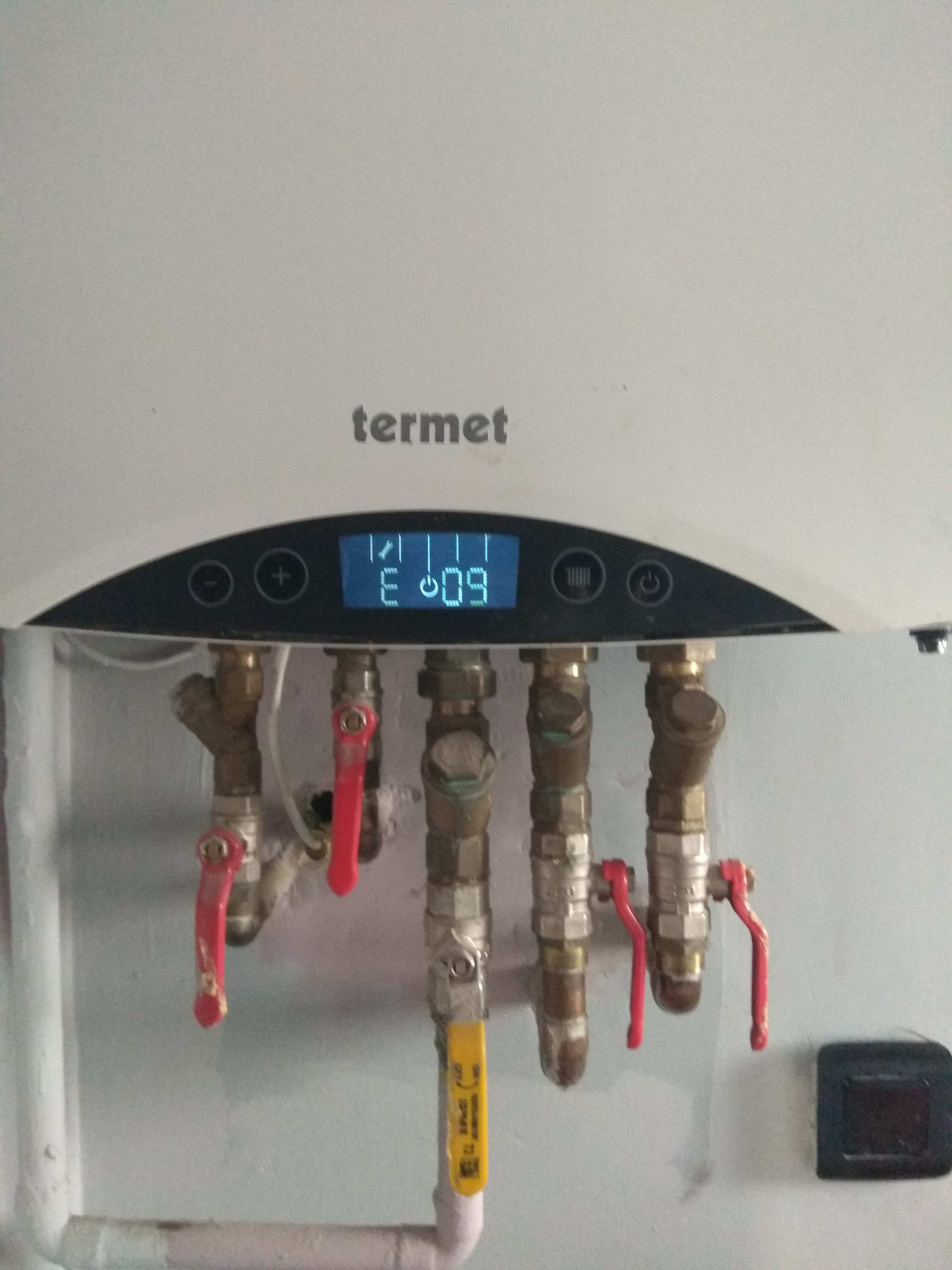

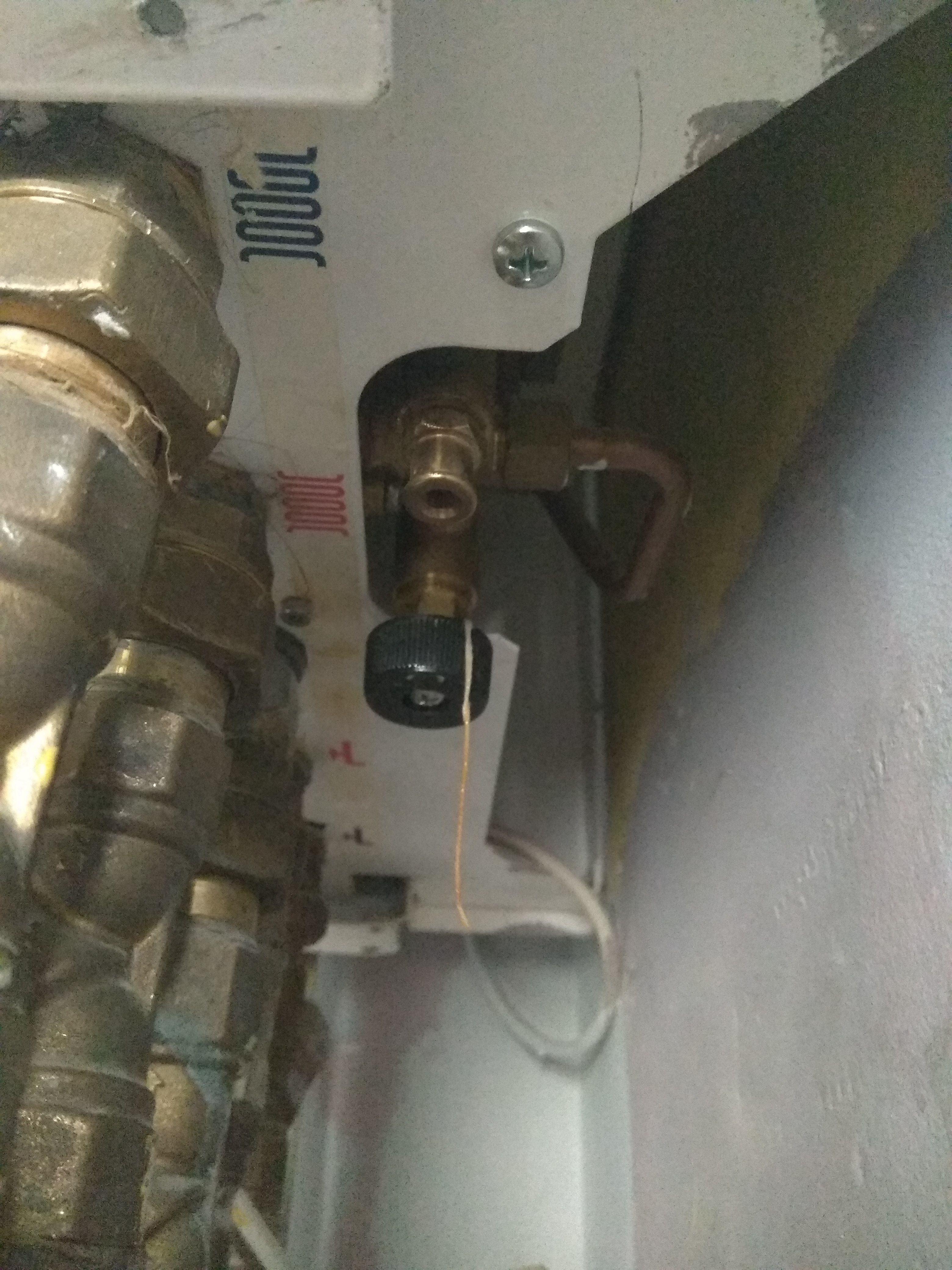

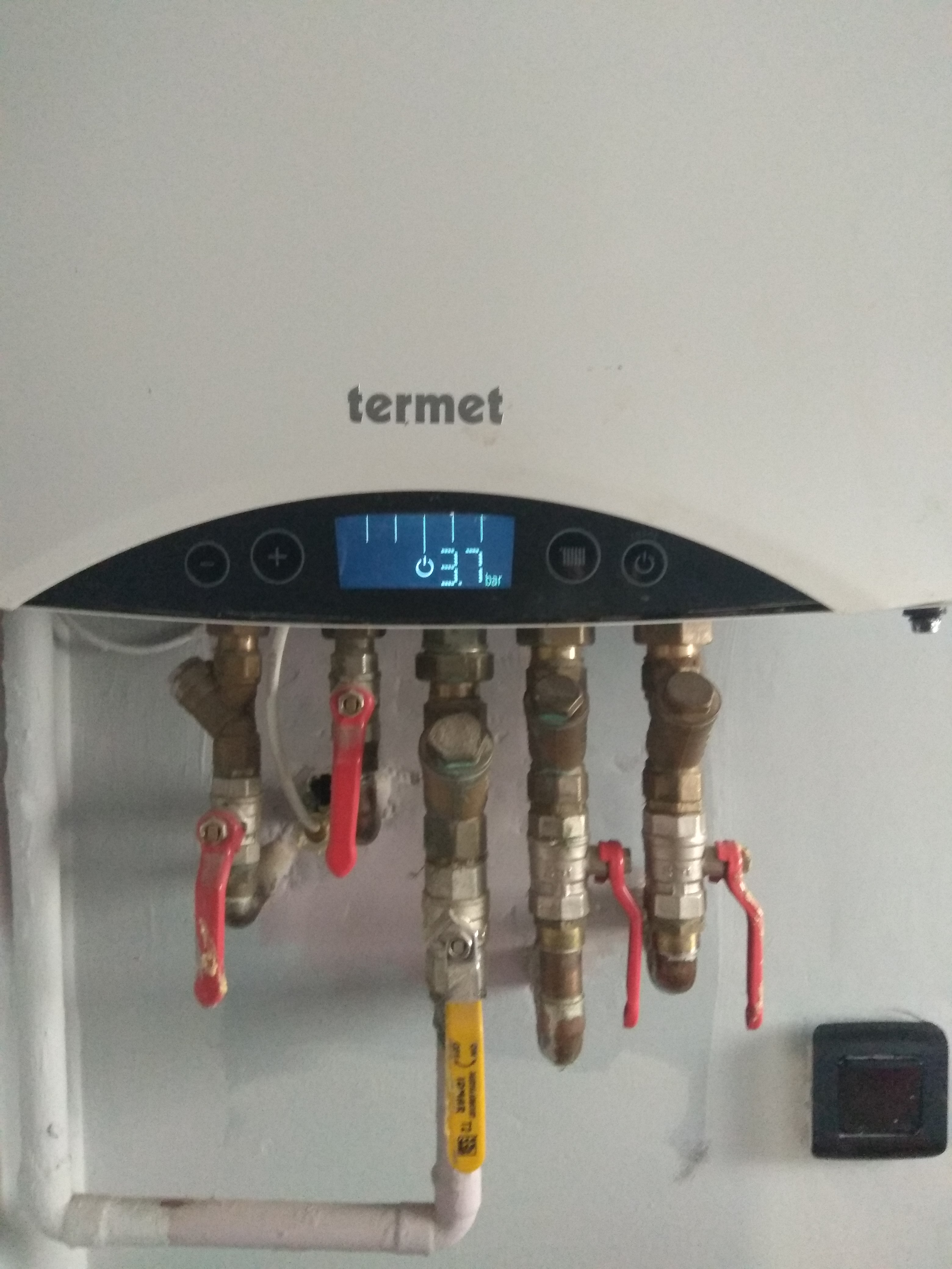

    Welcome,
    I would like to ask for quick help. We have the second day of Christmas and my oven broke down. Error E9 is displayed and pressure 3.7 bar is indicated. Sometimes the furnace caught 'failures' when the pressure was too low and you had to unscrew the valve for a while.
    I have no idea how to deal with it, and the apartment is getting colder.
    Adds some preview photos. I am asking for quick help.

    The manual says what is this error !! Too low or too high pressure. It should be in the range of 0.5 to 2.5 bar. Drop water from the central heating installation. If the pressure continues 3.7 bar, it indicates a damaged pressure transducer. By the way, a diaphragm vessel to be checked.

    Drain the radiator through a manual vent. However, I suspect a damaged transducer. Normally at 3 bar the safety valve should open and release excess pressure.

    Check the operation of the safety valve in the boiler. Before you can also drop the water pressure in the installation
