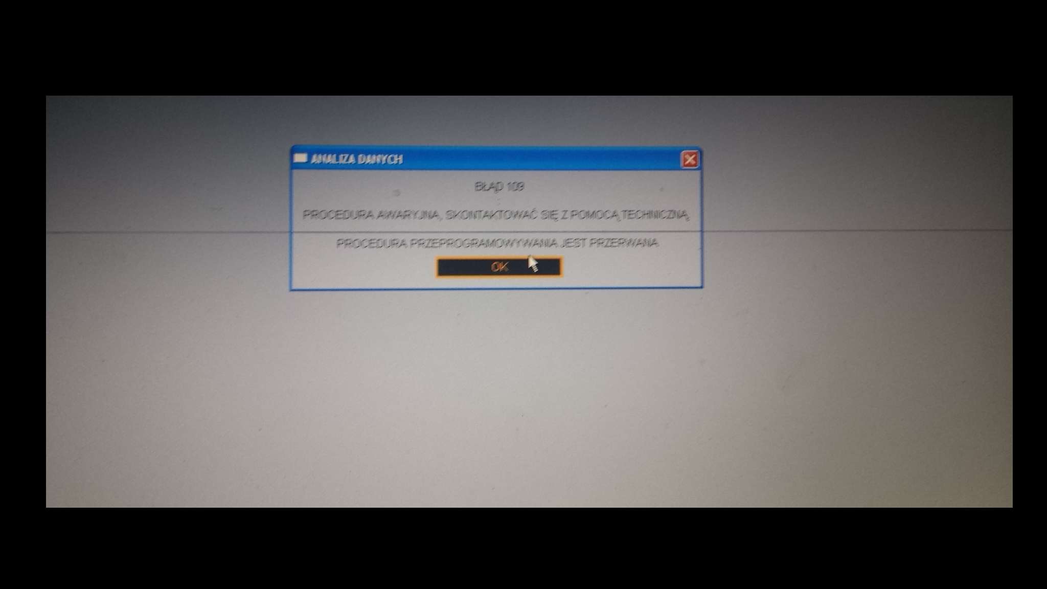

    A probe fell while updating the handbrake software. The brake is deactivated since then. Clip does not detect it during the multiplex network test. When you try to re-threshold the message as in the attachment. I understand that you need to remove the module and program it "on the table". Can you help in this case? Maybe there is another way out?
    Thank you in advance for any help.

    Are you doing it with the same probe or the other?

    Another, of course. It is stable, it coped with the injection computer re-threshold without any problems.

    Does anyone have or know where to look for the Renault Grand Scenic II brake module charge?

    You have to select "with" manual

    Could you elaborate on the statement? I suspect you mean setting up a multiplex network, but I'm not sure. As far as the network is concerned, it is obviously configured "with" a brake.
