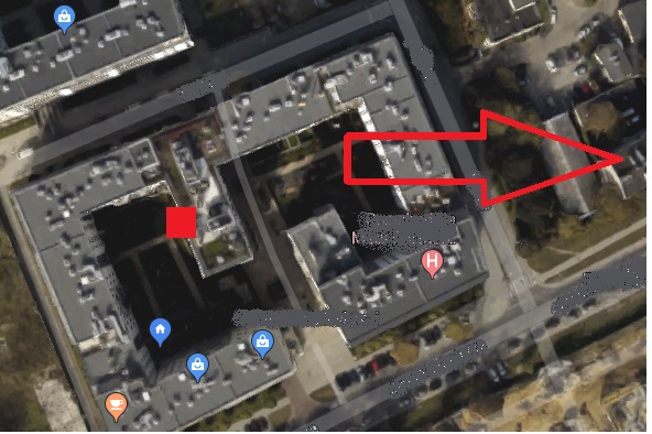

    Hi,
    I have:
    TV: Samsung ue40mu6472
    Terrestrial / indoor antenna: Konig KNT-DBVT-IN20
    15 dB, DVB-T
    VHF: 174-230 MHz
    UHF: 470 - 790 MHz
    Transmitter towards the Palace of Culture and Science - about 4 km.
    ERP power [kW]: 17
    Polarization: horizontal
    Antenna height: 218 m above sea level
    Transmit channel: 7 (191.5 MHz)
    Azimuth: 79 degrees
    Unfortunately, I am limited by the walls of the building (attachment) - a wall, a staircase, another wall + the next floor of the building.
    3rd floor in the 6th storey. ul. John Casimir
    Square: window
    Arrow: transmitter direction
    The room antenna catches only 12 signals, of which they receive 4 (Metro TV, WP and other crap - TVP, TVN, Polsat are missing, etc.)
    On the coaxial cable it catches the same channels.
    It seems to me that the ancestor is too weak. Will it be better if I invest in a more powerful indoor antenna or maybe I buy an external broadband and look for the signal to the north - but I'm also limited by the building (I have a patio view)?
    Or do it yourself from a cable and a piece of wire?
    A neighbor wrote that he was catching a signal from Raszyn on an ordinary cable, but I assume he has a window to the south.
    Any suggestions ?

    External antenna.

    If the mesh is rather without an amplifier. There is no chance of a stable reception in this well. Probably the antenna needs to be thrown on the roof.

    And there is no cable TV in the block with a social package for a few zlotys?
    If not, then the antenna is outside, mesh and try to get something from the reflection from Raszyn.
