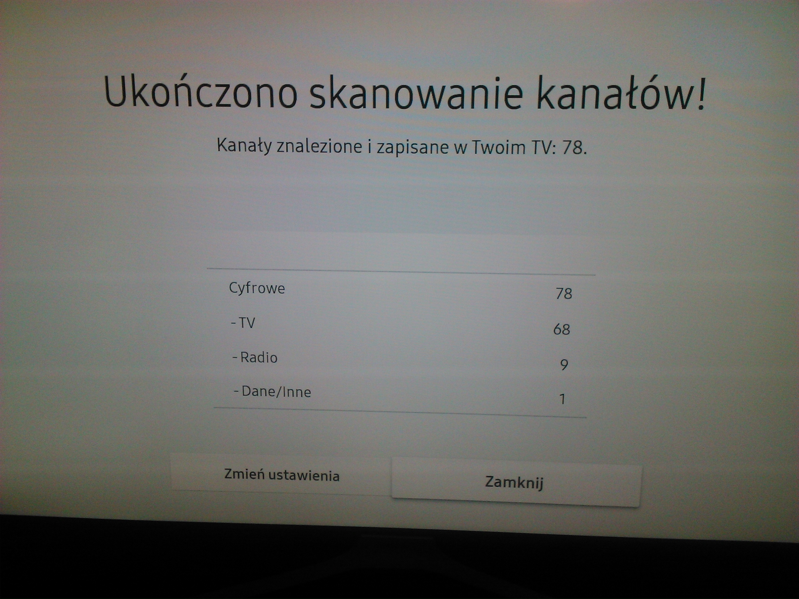

    I bought a new Samsung UE32M5572 TV that has a built-in digital terrestrial tuner, with the intention of connecting a directional antenna. I live in the Silesian Voivodeship, the antenna is directed to the south.
    After searching for the automatic channels, it turned out that the TV set found only 8 channels plus some test channels.
    The antenna I use is a DVB-T YAGI 21-69 outdoor directional antenna with a balun. Coaxial cable connected directly from the antenna balun to the TV socket.
    So far, on an old CRT TV with an external Ferguson Ariva T65 decoder, I caught almost thirty channels plus a few Czech channels and a few test channels on the same antenna, in the same setting. The only thing I changed was the antenna coaxial cable from the old set-top box to the new TV set.
    I tried to search for channels on the new TV several times automatically and in manual mode by entering the channel number - to no avail. The antenna is attached outside the third floor window pointing into the free space between the blocks. I turned the antenna a few degrees in the range of about 20-30 degrees again searching for programs. The effect was that I caught one or two new channels on the new TV and lost the others. Let me remind you that by connecting the old decoder at this point, I still catch all the channels from MUX 1, 2, 3 and 8.

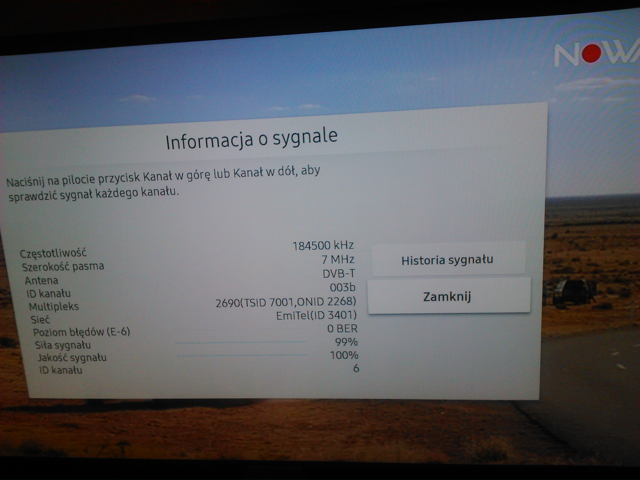

    When checking the signal quality on the same channel on the TV and in the old set-top box, I can see a significant difference:
    Samsung UE32M5572 TV - does not search for channels despite a good signalDSC_02..JPG (1.21 MB)You must be logged in to download this attachment.
    signal strength 3%, signal quality 16% on the new Samsung TV,
    Samsung UE32M5572 TV - does not search for channels despite a good signalDSC_02..JPG (696.52 kB)You must be logged in to download this attachment.
    80% signal quality on the old Ariva decoder with the same antenna orientation.
    I suspect, however, that the signal is not as weak as the information suggests because the image is perfect and there are no signs of a weak signal - no colored squares as in the case of errors in the reception of the digital signal. Some channels that I receive on the tuner of the new TV show the signal strength of 100%.

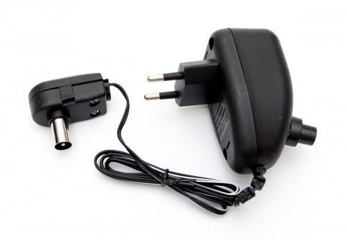

    So, could I connect a 5V or 12V switching power supply to such an amplifier in a box? The cable would have to be long. Is it possible to somehow supply this voltage to the antenna plug, as the Ariva decoder does?
    I will try to take this plate out of the box tomorrow and connect the antenna itself. I wonder if if it really is an amplifier, then replacing it with a balun will improve the situation.
    In other similar topics I read about adding an attenuator, but it probably works if the signal is too strong?
    The easiest thing would be if the TV could also power the antenna, as Ariva does. I read that TV sets usually do not have such a function, but someone else wrote that Samsung from certain series have such an option, but it is deeply hidden in the menu. If this is the case and someone would be able to help me navigate, I could find it at home.
    Last question, how does such a device work? I can't see any power.

    Ariva powered the amplifier with 5V, so you can use a power supply with a separator instead of the antenna plug on the TV, e.g. https://sklep.delta.poznan.pl/zasilacz-antenowy-5v100mas-zol_l1_p9192.html and then the amplifier will be powered like from Ariva.
    We do not know what symbol the amplifier has in the antenna box, it is very possible that it should be powered with 12V https://sklep.delta.poznan.pl/zasilacz-antenowy-12v100mas-gol_l1_p9012.html
    For the "device" (amplifier) there must also be a 12V power supply with a separator (as given above in the link).

    You have an amplifier on the antenna and Ariva had the power on and therefore was receiving. Buy a power supply, preferably with a regulation, and connect it to the TV. Samsung UE32M5572 TV - does not search for channels despite a good signal

    Thank you for your help. Now that I know the solution to the problem and I know what to look for, I can see how many times I had the answer under my breath while browsing the internet.
    There is actually a 12 V amplifier in the box, when I was buying the antenna I thought it was a balun because I didn't know each other. Today I bought a 12V antenna power supply for ten zlotys. I connected the antenna cable directly to the TV and I am shocked - he found over 60 TV channels although half are Czech programs. I removed the Czech and the test ones, there were 31 Polish ones (32 with TV are on ;-) but without exaggeration).
    Samsung UE32M5572 TV - does not search for channels despite a good signalDSC_02..JPG (1.24 MB)You must be logged in to download this attachment.
    The signal strength from three percent on the new tv channel increased to one hundred percent.
    Samsung UE32M5572 TV - does not search for channels despite a good signalDSC_02..JPG (1.3 MB)You must be logged in to download this attachment.

    As colleagues from the forum advised, I bought a power supply for the amplifier that was in the box because this TV did not power the antenna, unlike the old Ariva decoder. It also turned out that the amplifier itself was not necessary because the transmitting antennas are close to my place of residence - replacing the amplifier with a balun solved the problem of signal clipping. The only thing that had to be done from the beginning was to buy a balun for PLN 4 and install the antenna in the box.
