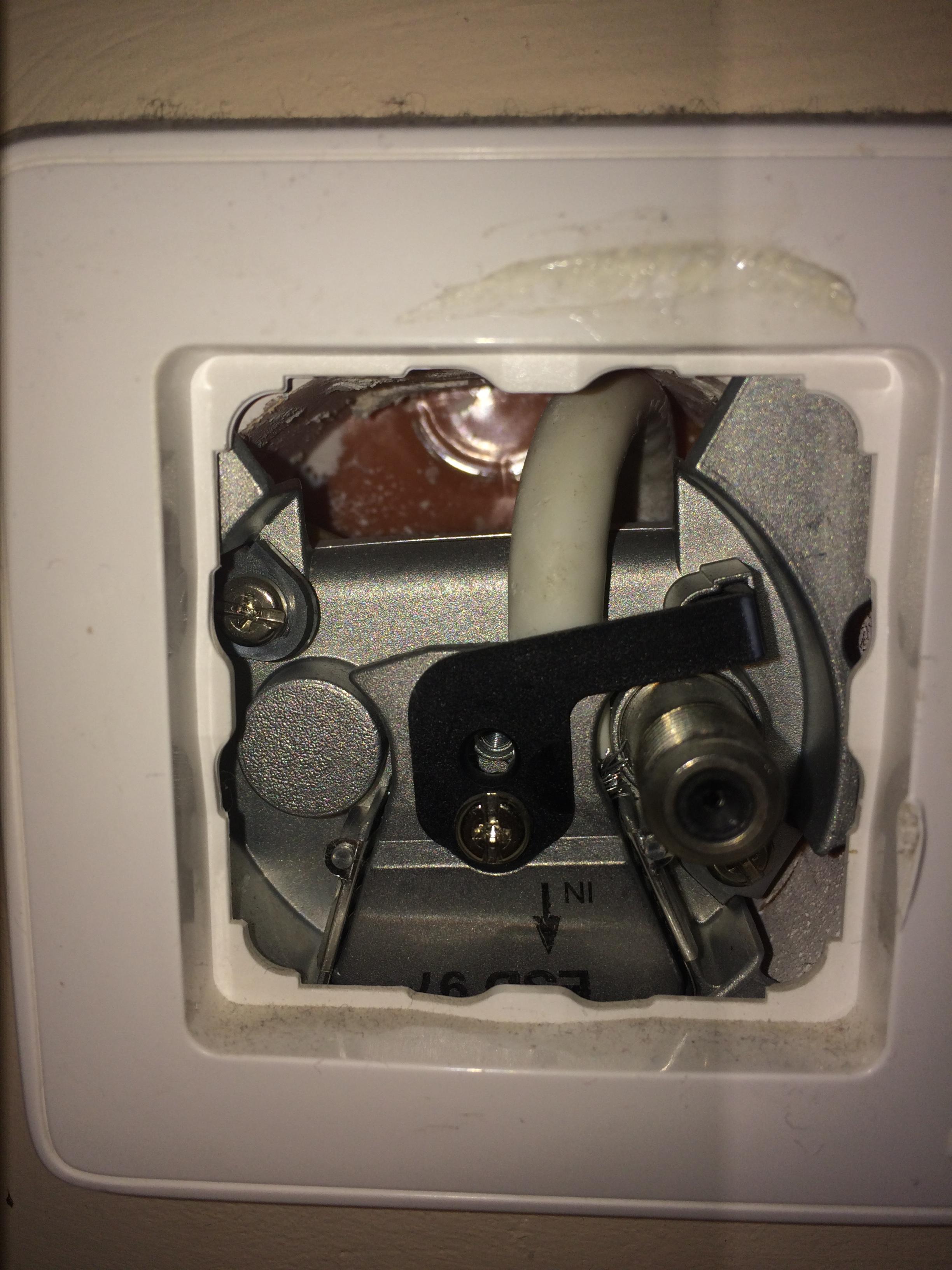

    Welcome back,
    The socket looks like this (threaded end) as in the attachment. Earlier, UPC was active, while digital TV was not connected.
    Any tips on replacing the socket or the outlet should work?

  • #8 16919538
    headshot
    Level 20  
    Posts: 875
    Help: 32
    Rate: 128
    So I suspect that it is not a cable assembly.

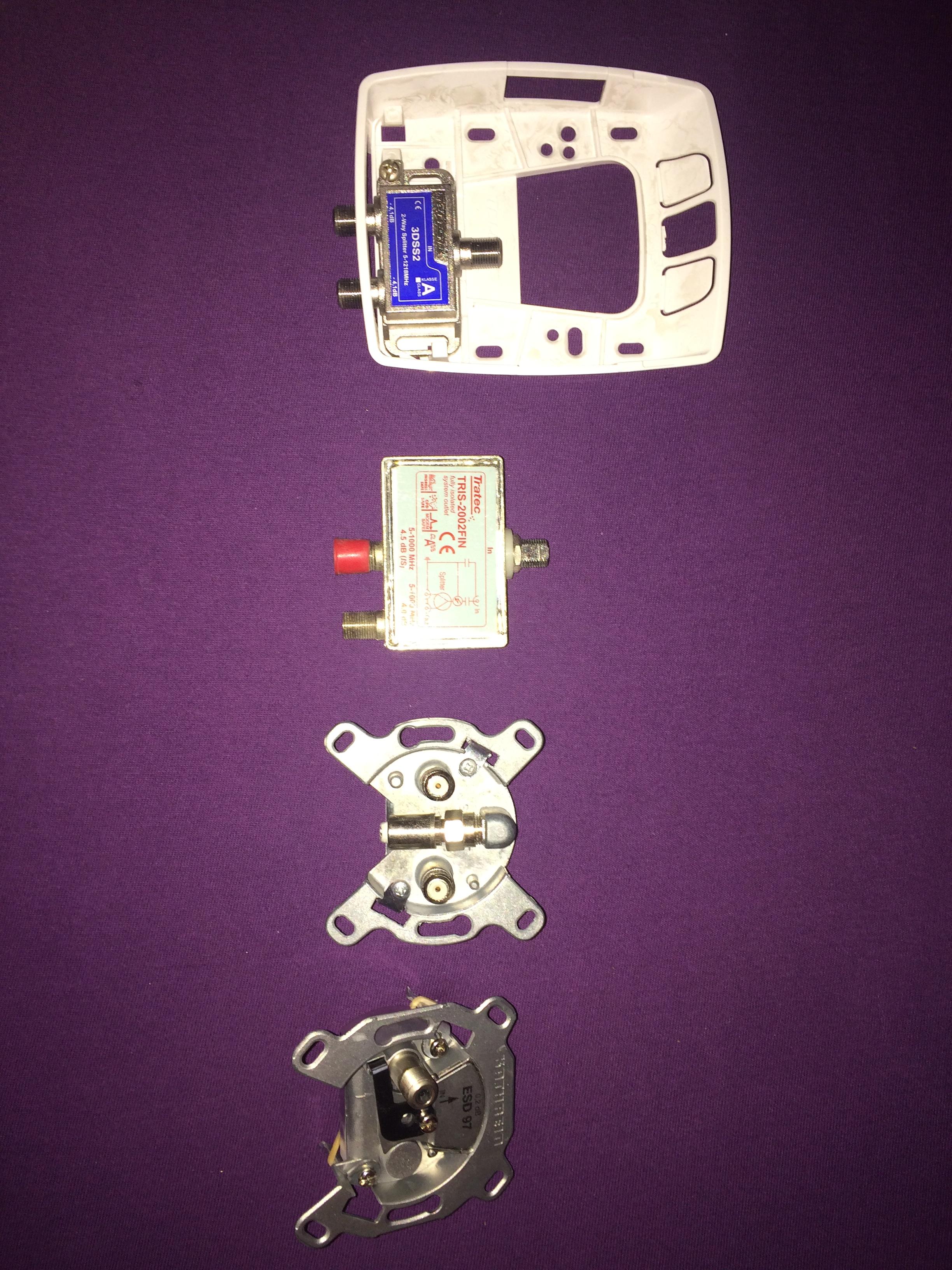

    I still have other sockets and a splitter (attachment). But there is no information from the input on TV or SAT.

    Cable TV mode and adapter needed
    #10 16919544
    wiertacz
    Level 35  
    Posts: 1940
    Help: 312
    Rate: 384
    In my opinion it is the cable TV socket you mentioned.
    Perhaps the operator provides a package of free programs. My sister has got a cable with upc and she does.
    You need a cable which on one side has a second phase threaded plug, a standard antenna plug or a cable with both ends, type fi one adapter for a standard antenna plug that you plug into the socket on the receiver.
    You need to choose Cable TV instead of terrestrial mode. Perhaps the TV will be asking for the frequency and other parameters of the cable TV then you have to look for them on the upc site, taking into account your residence or find out with your building manager.
