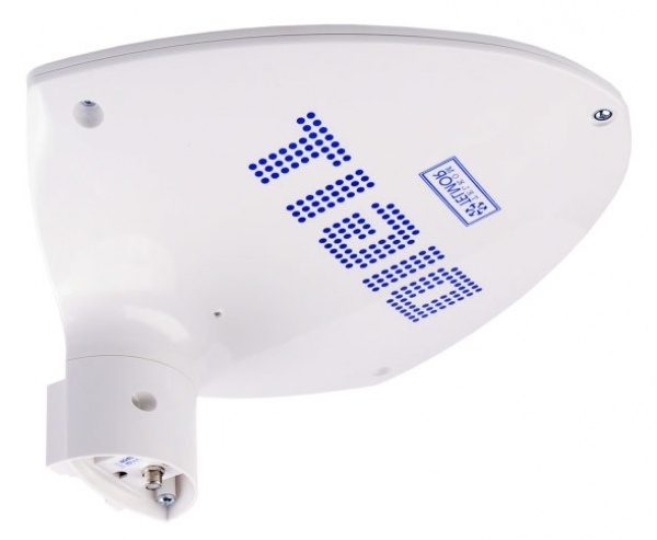

    My problem is with MUX-2. I am receiving a signal from RTCN Poznań "Śrem". I live within 5 km. Antenna: TELKOM-TELMOR. All other MUXs work fine. On the other hand, periodically on MUX-2 (TVN, Polsat, etc.) the program can not be received. It hangs up, breaks. Mostly in the evening. Sometimes the reception is very good. Surely this is not a decoder issue, because I tried with different ones. Also TV with a built-in decoder.
    Could it be a matter of some disturbance? weather influence?

    Passive terrestrial TV antenna Telmor DIGIT Passive
    - Full HD
    - UHF (channels 21 to 69).
    - Uniform signal amplification in the whole frequency range
    - Profit / effectiveness - 4 dB
    - Strong attenuation of GSM signals thanks to the appropriate shaped characteristics.
    - Good fit (WFS pound: 2.2).
    - Discrimination of back radiation
    I have so much in the description of the antenna
    Antenna in a horizontal position, just like on a photo. It hangs on the 4th floor.
    I understand that he "sees" the transmitter?

    In the place where the antenna is hanging, the signal is insufficient.

    They receive mux-y on low channels 23 and 27, no reception on k.39. It looks like a weak signal.
    So the questions remain
    Włodzimierz Wojtiuk wrote:
    how placed?
    Is it mounted outside? What cable and what length? Are the connectors correctly made?

    The antenna sees the transmitter. However, the signal goes along the block. And so I think, is there any interference from neighbors? Cable about 1.5 m. Installation repeatedly checked.
    SNR - 22.2 dB to 26.1 dB
    Signal strength -76,0 dBm to -78 dBm
    At the moment there are such results and the reception is excellent. Unfortunately, I can not give other data, because now everything is ok :-)
    Feebly. A head with very good sensitivity if it is still receiving something. It is only about 31-33 dBuV, with the minimum required 45-47 dBuV (-64 / -62 dBm).
    dyspozytor wrote:
    Signal strength 48.0 dBm
    dyspozytor wrote:
    it's always ok
    Hence, good reception (-48 dBm = 61 dBuV).
    It would be better if it was ? 30 dB - just like you have on mux-3.

    MUX-1
    32.9 dB
    49.0 dBm
    MUX-2
    24.1 dB
    77.1 dBm
    MUX-3
    33.1 dB
    48.0 dBm
    MUX-8
    33.0 dB
    52.0 dBm
    Does this mean that the antenna is weak? Why is it that only the MUX-2 receives so little? Is there any possibility of healing this situation? What can you do in this situation?

    You will not do anything with this antenna. I would suggest you buy an antenna with an openable standard can, so that you can replace the balancer with an amplifier, e.g. link .
    Or ask kol @ Telmor if they have amplifiers for your antenna on sale.
    Well, sometimes it happens that one mux "sticks out" from the others.
    Start with a slight change of direction. Often a small shift of the antenna vertically or horizontally causes a dramatic improvement. Experiment by observing mux-2 parameters. It may also be that it will improve and the remaining mux deteriorate.

    Added after 18 [hours] 56 [minutes]:
    I set the antenna so that the results are optimal (averaged in individual MUX). For now it's ok. The reception is great. We'll see what will happen. Thank you Kolegom once again for helpful comments.
