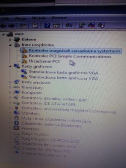

    Kolobos, however, I have a problem with the drivers. You could look at the picture and tell me which ones rudders drivers are missing? I can't install the graphics.

  • #14 16929112
    Kolobos
    IT specialist
    Posts: 85178
    Help: 17171
    Rate: 10455
    You probably see what you miss?
    Install in this order:
    https://downloadcenter.intel.com/download/207...ice-Software-INF-Update-Utility-?product=1145
    https://downloadcenter.intel.com/download/230...l-Management-Engine-Driver-1-5M-for-Intel-NUC
    Unpack and install the nvidia drivers manually from the device manager, selecting updates.
    For some devices, the drivers are also on Windows Update, so install them, and download the rest from Google, just enter the ID and download from any page.
