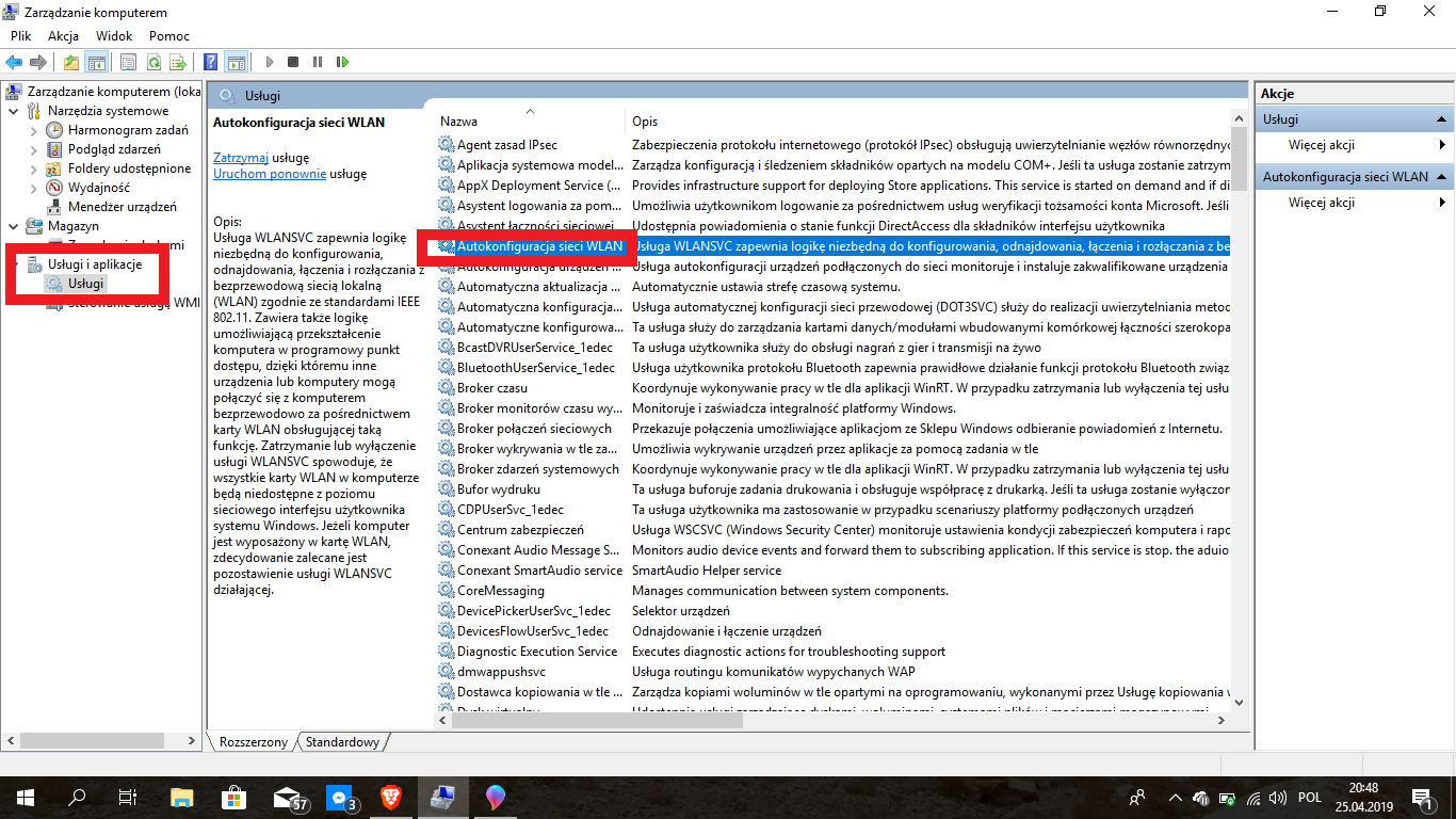

    Everything failed, but I was able to fix the problem.
    Right-click on the Win icon and select: Computer Management. Then we choose: services; services and applications and click 2x on: WLAN auto-configuration: select the type of startup - manual and click run. Then we approve ok and it's ready :)
