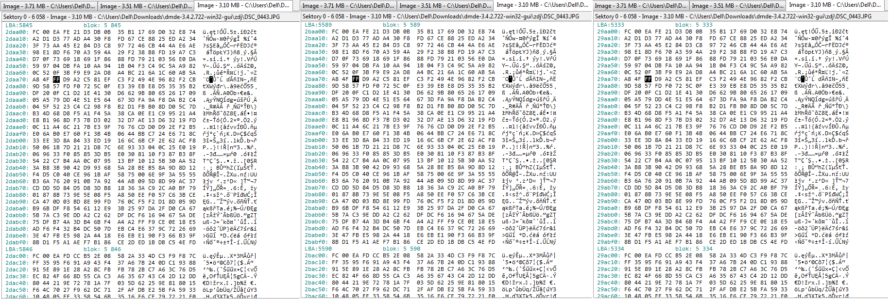

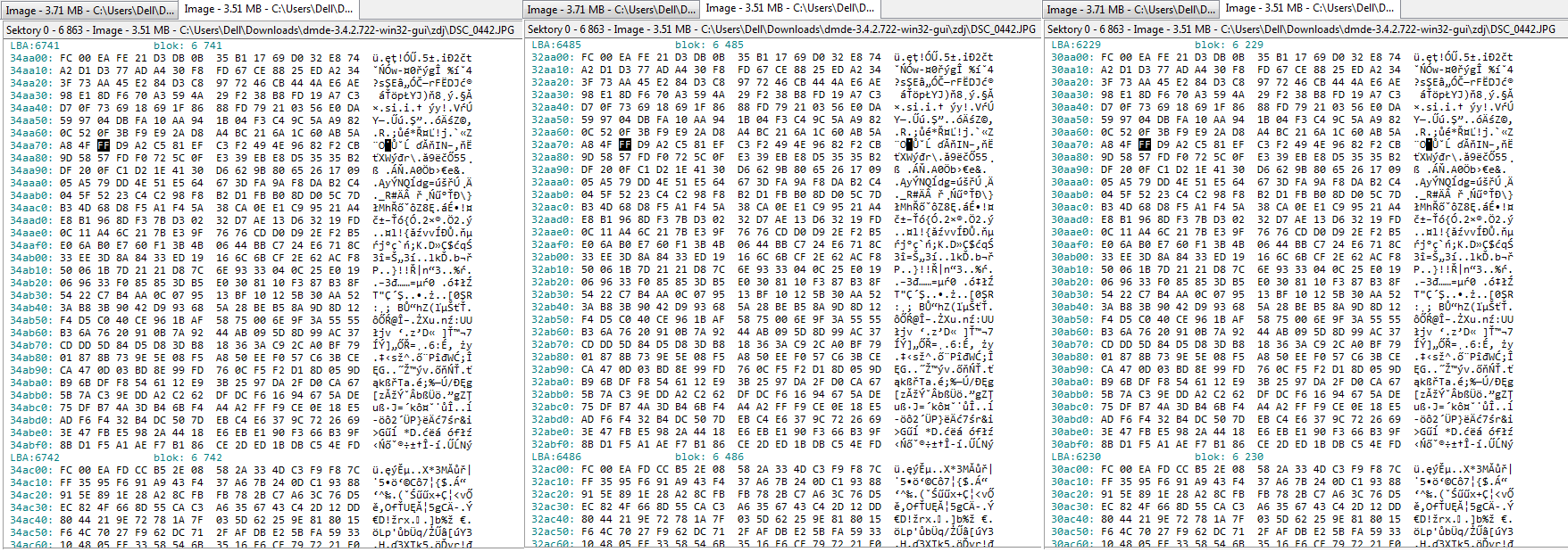

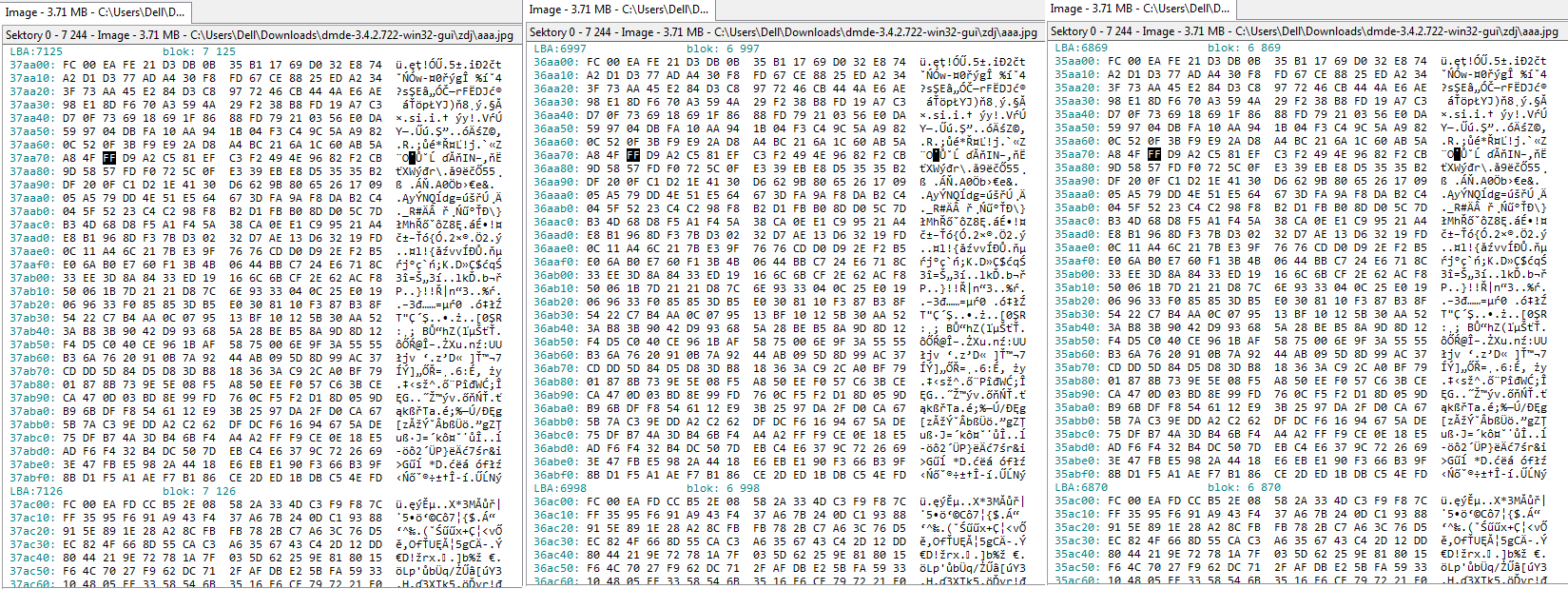

    To which device the files were transferred and the next question that arises is why the files are looped every 128 sectors? If it was a different number, I think that the number 128 is so typical in computer science that maybe we are dealing with damage to the medium to which the files were transferred or, for example, a fake SD card or USB flash drive. This is for the first file. The second one also has repetitions of the same as 256 sectors, and the third file contains the same as the second even.
    Confirmation below, nothing can be recovered from it:
    File 1:
    Repair Damaged or Too Large JPG Photos: Solutions for Camera Files & Programs to Use
    File 2:
    File 3:
    You have to try to recover from the device you transferred it from.
