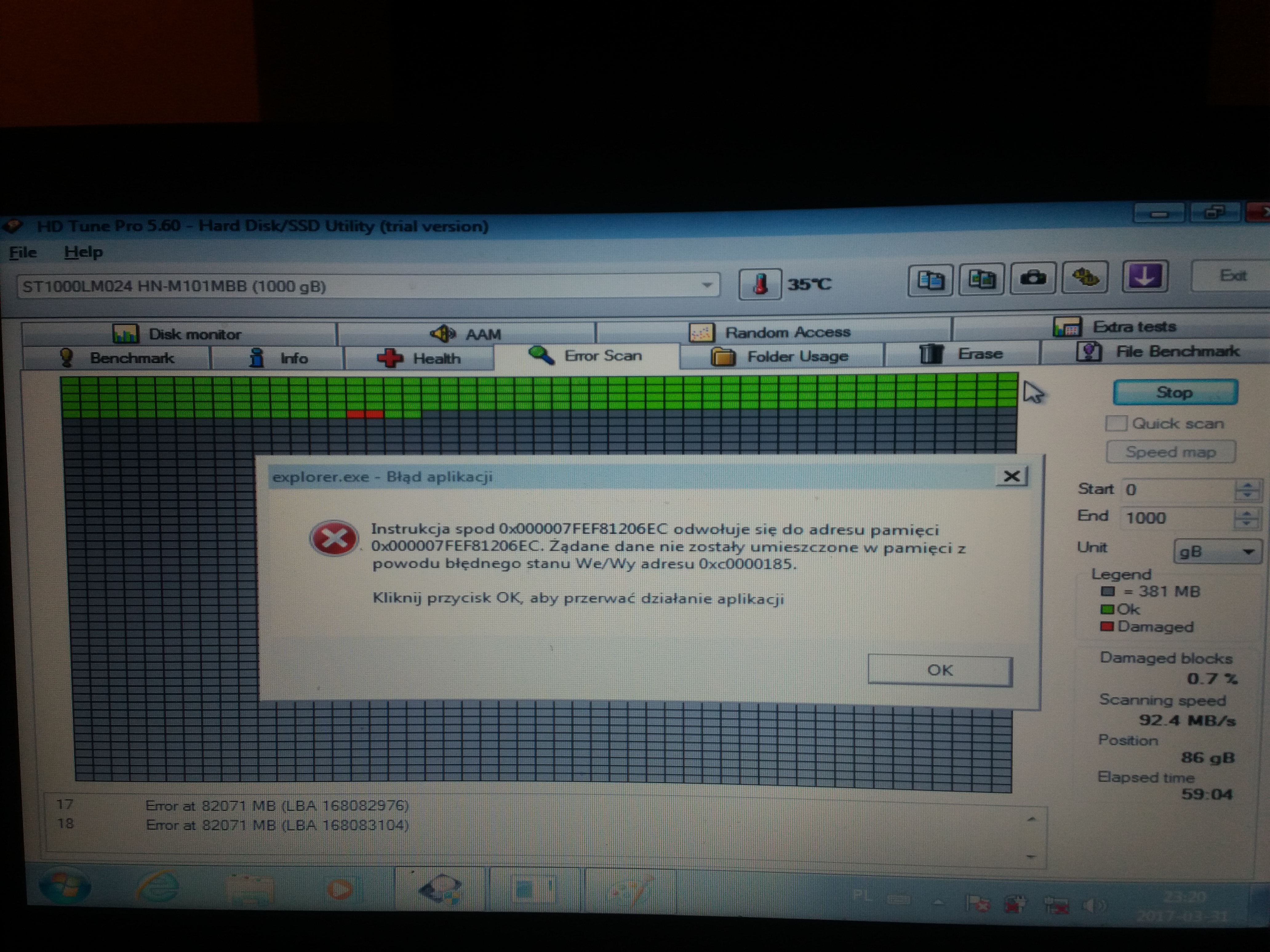

    I typed chkdsk d: / x
    https://obrazki.elektroda.pl/8186096900_1490877278.jpg

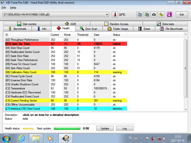

    How do you cut bad segments from a disk and leave only the good ones? I will add that I do not care about files anymore
    Added after 14 [minutes]:
    Corrupted folder on the disk, after entering it, the computer freezes.
    Added after 15 [minutes]:
    This message pops up and stutters.

    Disk replacement was necessary
