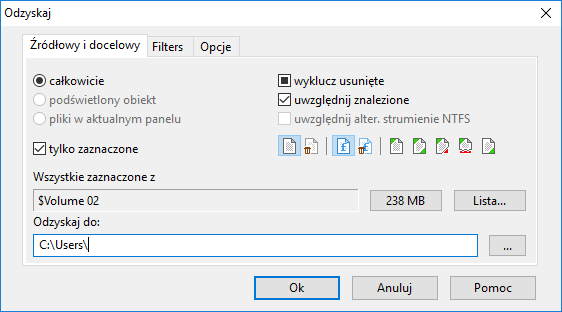

    I installed the Windows system image recovery program on a 500 GB external drive. Effect - 32 GB formatted as ESD-USB. The rest invisible.
    After thorough scanning, DMDE shows the result as in the picture below
    Recover Lost Data from 500GB ESD-USB External Drive: DMDE Scanning Results and Steps
    What to do next to recover as much data as possible?
    When selected, recover shows the size of only 238 MB and the number of 232 files, when after scanning there were almost 20 thousand.
    Recover Lost Data from 500GB ESD-USB External Drive: DMDE Scanning Results and Steps Recover Lost Data from 500GB ESD-USB External Drive: DMDE Scanning Results and Steps
    Thank you in advance for any help.

    Sorry, but data recovery only by file signatures.

    Then do not recover from the partition, just double click on jpeg and recover all types of extensions known to the program. Some will be damaged, because they are also the remains of previous and deleted data, and lost as a result of overwriting the partition.
