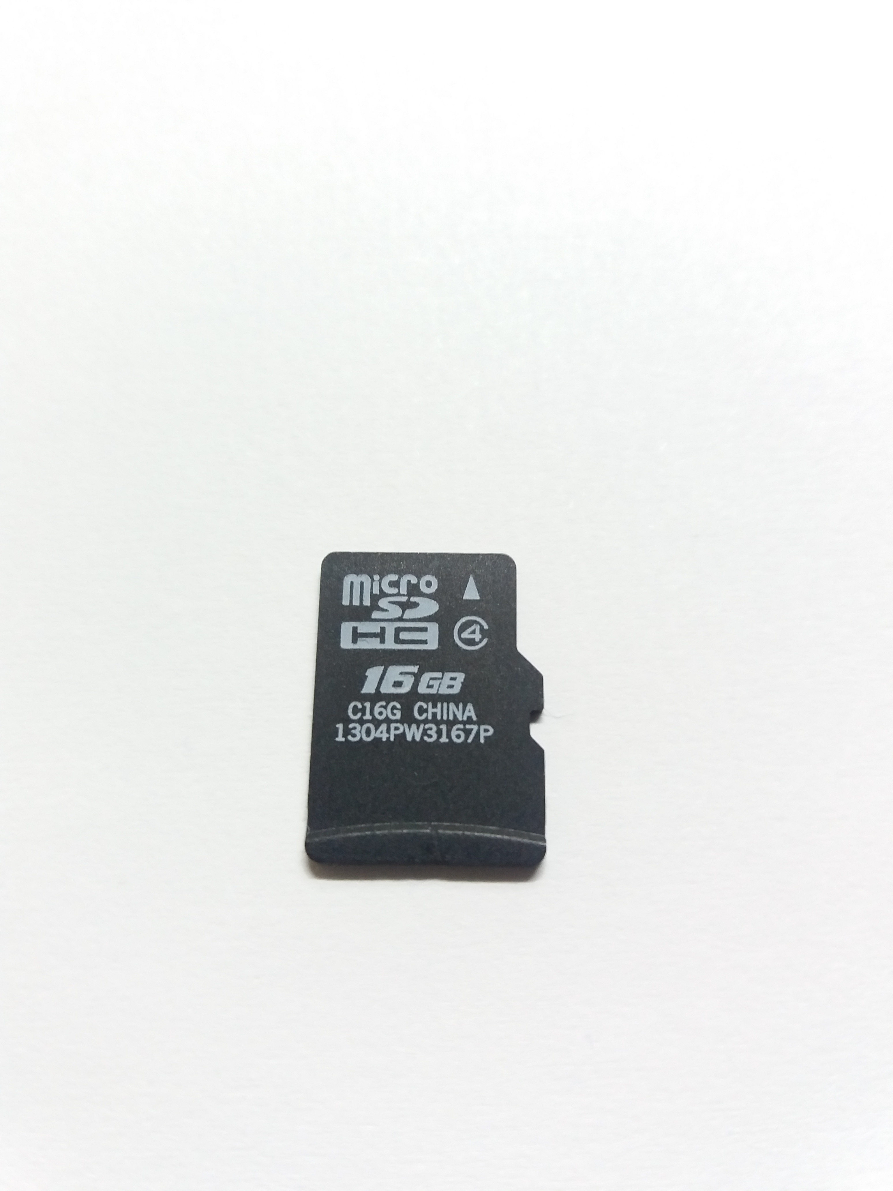

    Hello. I come with the following problem:
    In my phone (Samsung Galaxy J5 2016) I had a 16 GB micro SDHC card. I bought it some two years ago. This is a class 4 card (Now I would not buy one). Her photo for accurate recognition ???
    Data recovery from a possibly damaged 16 GB micro SDHC card.
    One day when I wanted to see my photos taken a few days ago, but they were not in the gallery. The card was also not displayed in the file manager. After translating it to another phone, it was also not visible. I also tried on the computer via a USB adapter. And here the situation was slightly different. After inserting the adapter with the card into the USB port, the card appears for a second or two and disappears. This happens several times a minute. I would like to restore only photos (I do not even think about saving the card). Is it possible in any way?
    Thank you in advance for all the answers :D

  • #5 16950229
    KodIT
    HDD Recovery specialist
    Posts: 657
    Help: 90
    Rate: 82
    Exactly 0B is not a tragedy in properties.
    Check if the DMDE or Photorec program will see it when connected to the correct capacity.

  • #10 16954743
    Rosoft
    Posts: 17
    I'll try and let you know later :)
    Added after 2 [hours] 13 [minutes]:
    Unfortunately, linux does not detect the card at all: /
  • #12 16958562
    michal_aniol
    Posts: 1651
    Help: 182
    Rate: 100
    KodIT wrote:
    Unfortunately, you will not do anything about it :(
    Not a home way, but there is a chance to recover data in the lab bypassing the controller. Memory modules should be functional, very rarely damaged.
  • #14 16959334
    Rosoft
    Posts: 17
    Thanks for the hints, gentlemen :D Do you know how much such a thing can cost?
  • #15 16962052
    michal_aniol
    Posts: 1651
    Help: 182
    Rate: 100
    It depends on the lab, but usually prices from 1200 net up. Call and ask.
