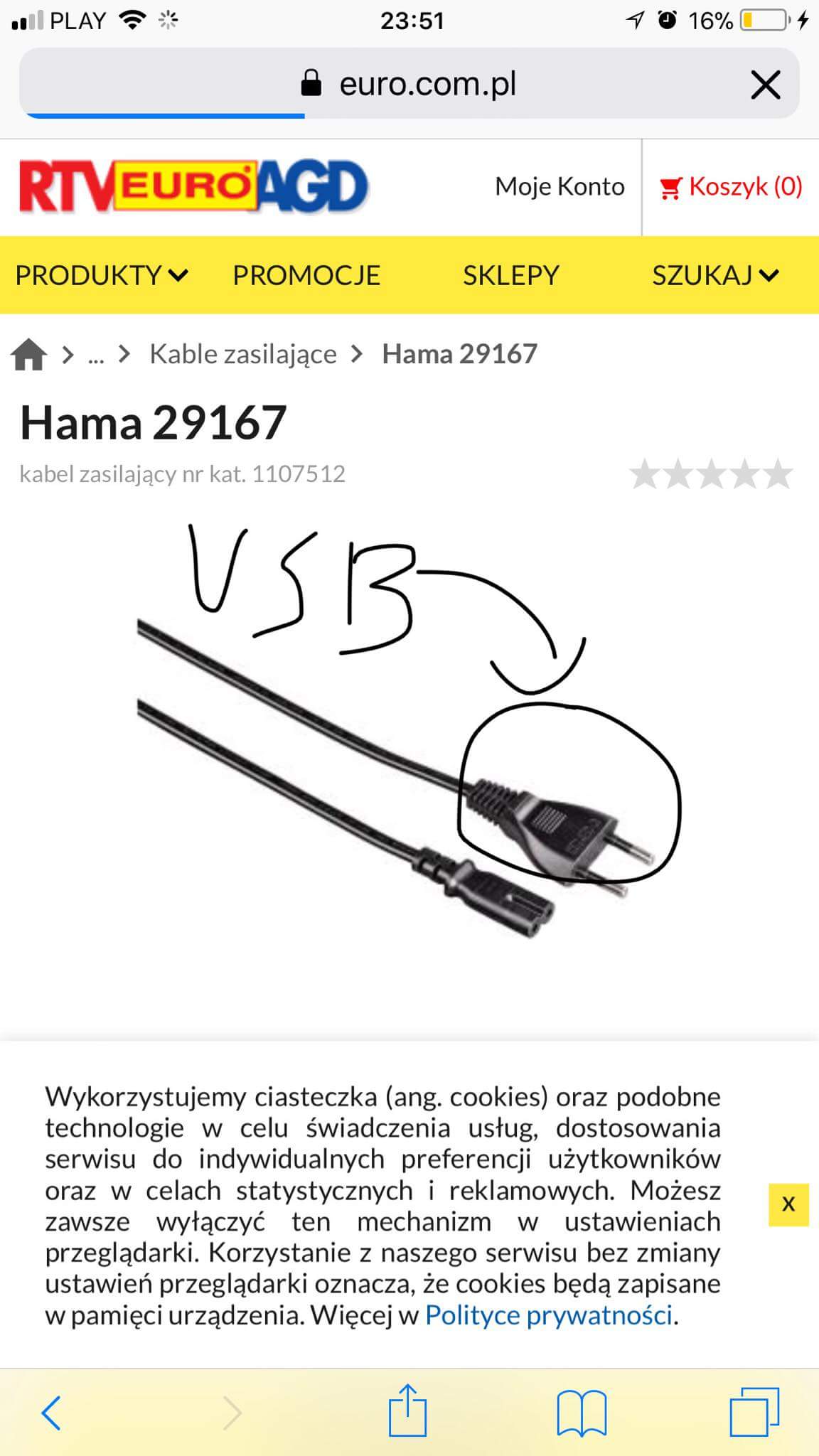

    I have a question if there are any cables that you could charge your laptop via USB powerbank.
    I mean something like the picture unless there is another way out.
    • Powerbank to Laptop Charging Options: USB Cables, Adapters & Compatible Models received_1404032589706332.jpeg (119.96 KB) You must be logged in to download this attachment.

    You can't do that. :cry: USB is 5VDC with a capacity of 500 mA and laptop battery charging is 15-20 VDC and 1-4 A.

    Nonsense. NOT via USB! You can build a "powerbank" even on the basis of batteries from Kamaz and charge it. Only that through a dedicated laptop socket.

    Relax, read the topic that you have linked to carefully. If you don't understand, ask.
    Do you have a ban on Google? And you can't check the simplest information like sunen s23000 power bank or 19V output voltage of this power bank.
