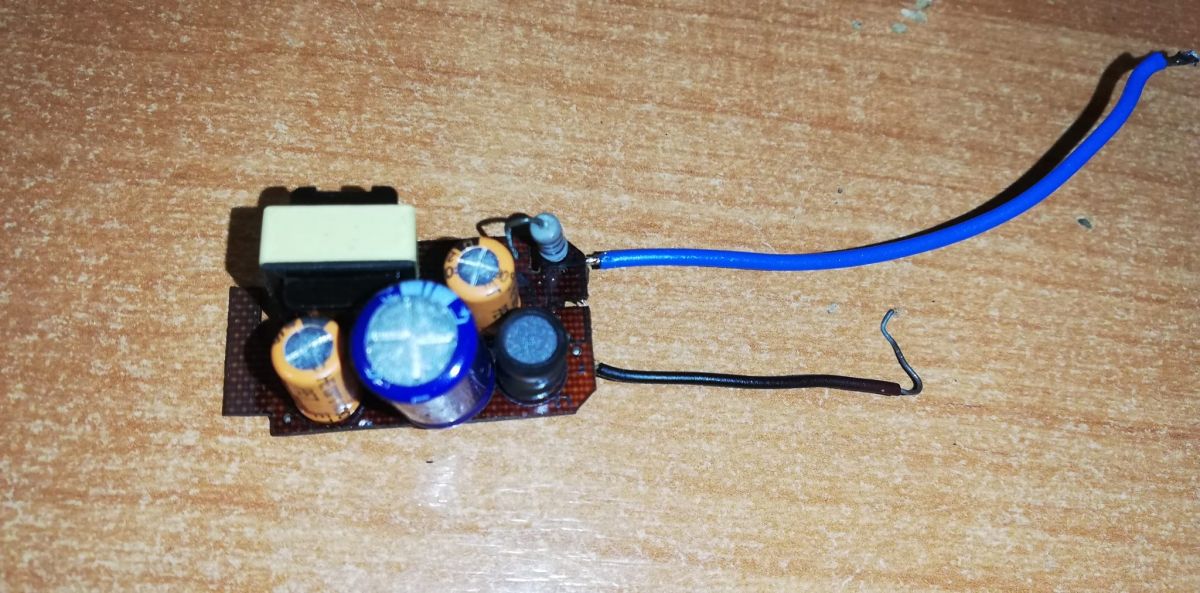

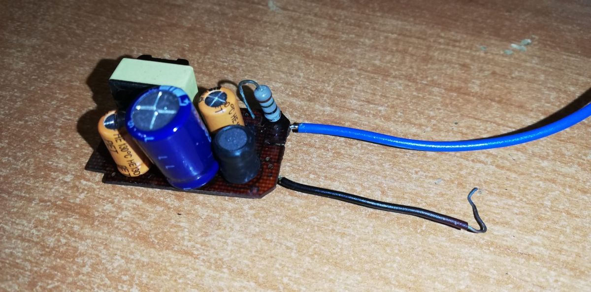

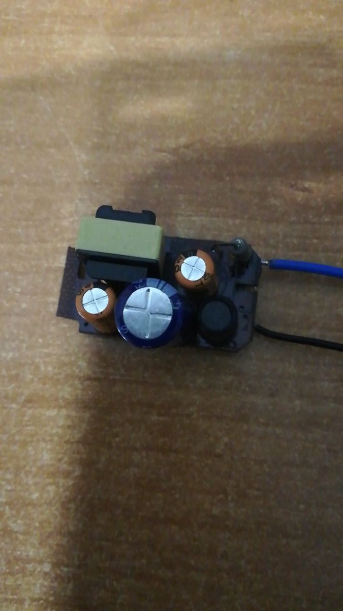

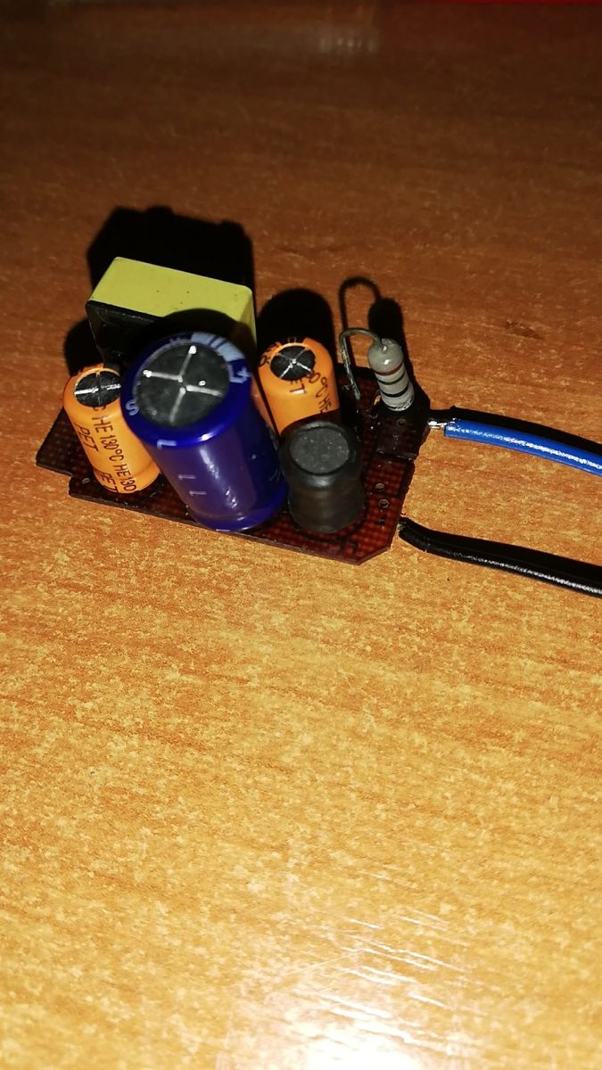

    A request for tips on how to check step by step what is damaged in the power module of the led diodes in the bulb (LED bulb thread e27 power supply 230v, power about 12W).
    The module is attached in the pictures. After connecting the module to 230V power supply (and disconnected board with LEDs) at the 'output', i.e. connecting the module to the board with LEDs, the meter shows a direct voltage of over 300V.
    Since I have about 10 such damaged bulbs, I would like to try to repair (repair or replace the module)

    Are you sure the module is damaged and not the LEDs?
    There is LED current stabilization, not voltage.

    The main argument for stating that the damaged module is just the incorrect output voltage from the module to the LED board. I assume (maybe I am wrong) that the LED board should receive direct current with an order of magnitude smaller than the one tested in the board.

    This type of driver must not be turned on without load on the output! These 300V is the peak voltage of the network. Show the tiles with the LEDs first, then we can do something. And again I warn you - do not turn it on without load because it is nice to get hit with a fragment of an exploding capacitor.

    You have a faulty capacitor. (First picture first from the left from the bottom)

    This is known, but this is not the reason for the lamp not working. I bet one LED in the row is broken. We will see photos.

    "it is known"? Somehow no one wrote about this colleague. I agree that one diode may be damaged. I suggest checking the diodes and replacing the damaged capacitor (the other two are convex if they need to be replaced)

    The first signs that the capacitor is damaged is that its upper part is convex. You can measure the capacitor with a meter, but the meter must have a range for measuring capacitance. If you want to check the diodes with a meter, set the meter to measure the diode or test the continuity of the circuit. You measure each LED twice. When you put the red cable of the meter to the positive pole of the diode and the black to the minus, you should have a reading on the meter. If you change the polarity then it should not be read. Then the diode is theoretically weldable. However, if in each case you have a reading or you do not have it, then the diode is damaged.

    The controller is a current stabilizer, it will increase the voltage as long as it reaches the set current or its capabilities and gives the maximum voltage. If you have no load, the controller gives max voltage, which in turn can cause electrolyte death at this converter output.
    Generally, if it turns out that it is a diode, it is worth reading the mark of the chip in the inverter and determine which resistor is responsible for the value of the given current for the diodes. It is worth choosing its value to reduce the current flowing by about 10%, the light will be slightly less, and the service life will increase significantly.
    But as it turns out, it is the diodes that are replaced by an inexperienced solder need not be so simple ;)

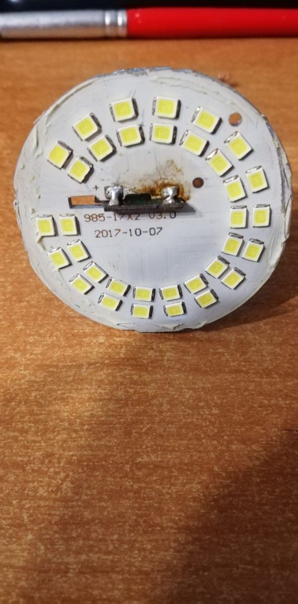

    Not every diode can be checked with a meter, because sometimes one housing houses several structures connected in series and the test voltage of the meter may be too low. First make a visual assessment - if a black dot is visible in the structure, then such a diode is 99% damaged. Then measuring with a multimeter on the diode range: red wire to the anode, black to the cathode. If the diode has one structure inside it should light up slightly. Check it out with a few taps. If none of them lights up, it is likely that they have several connected structures. Then you can try to light them individually by connecting + the power supply through a resistor (1 ÷ 10k? ;) to the anode, and - to the cathode. The power supply should have 12-15V, although I encountered diodes that started to glow only above 18V. With such tests, do not change polarization because high back voltage can damage the structure.

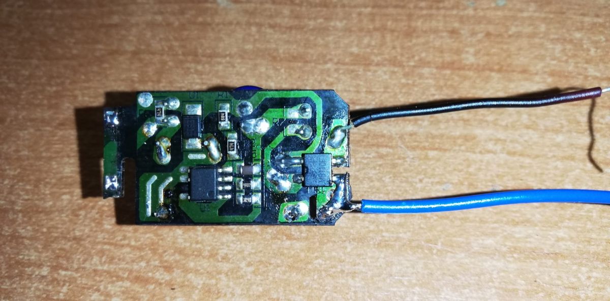

    I attach photos of the board with up / down LEDs (one of the diodes damaged by me) and the module from below. The board with LEDs is powered by the connection in the middle (these two February)

    The fourth counting clockwise (starting at 12 o'clock) looks damaged. Desoldering it should not be difficult, but desoldering it from a working plate and soldering into place is not so easy. You need a hot air station and some experience.

    Also check this element in the black heat shrink if there is a break

    First, swollen electrolytic capacitors for replacement.
    The LED driver is the BP9916 chip and it probably has been damaged.
    This is a fairly common damage because the cooling conditions are poor.
    The system can be bought on ebay and Aliexpress.
