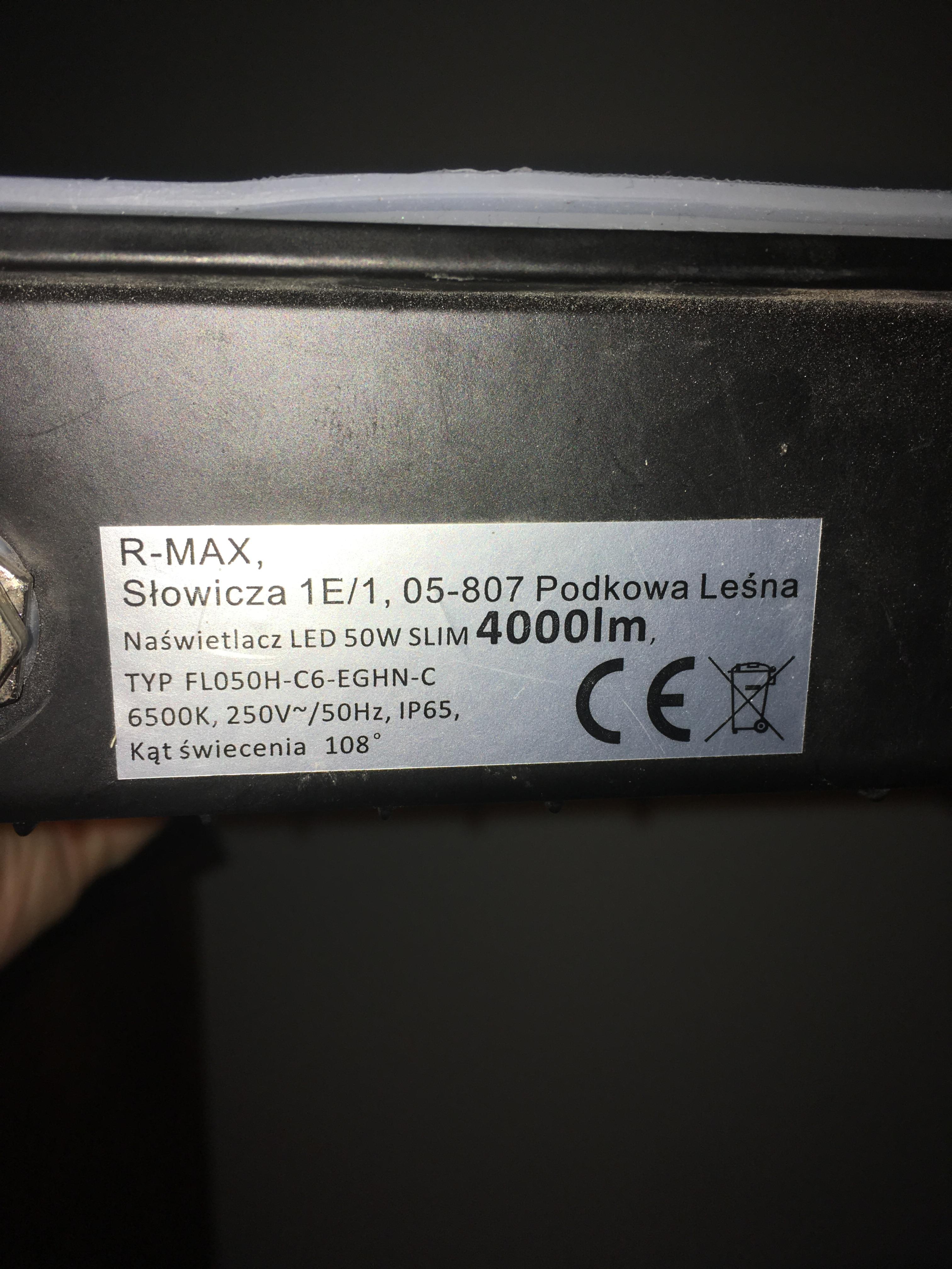

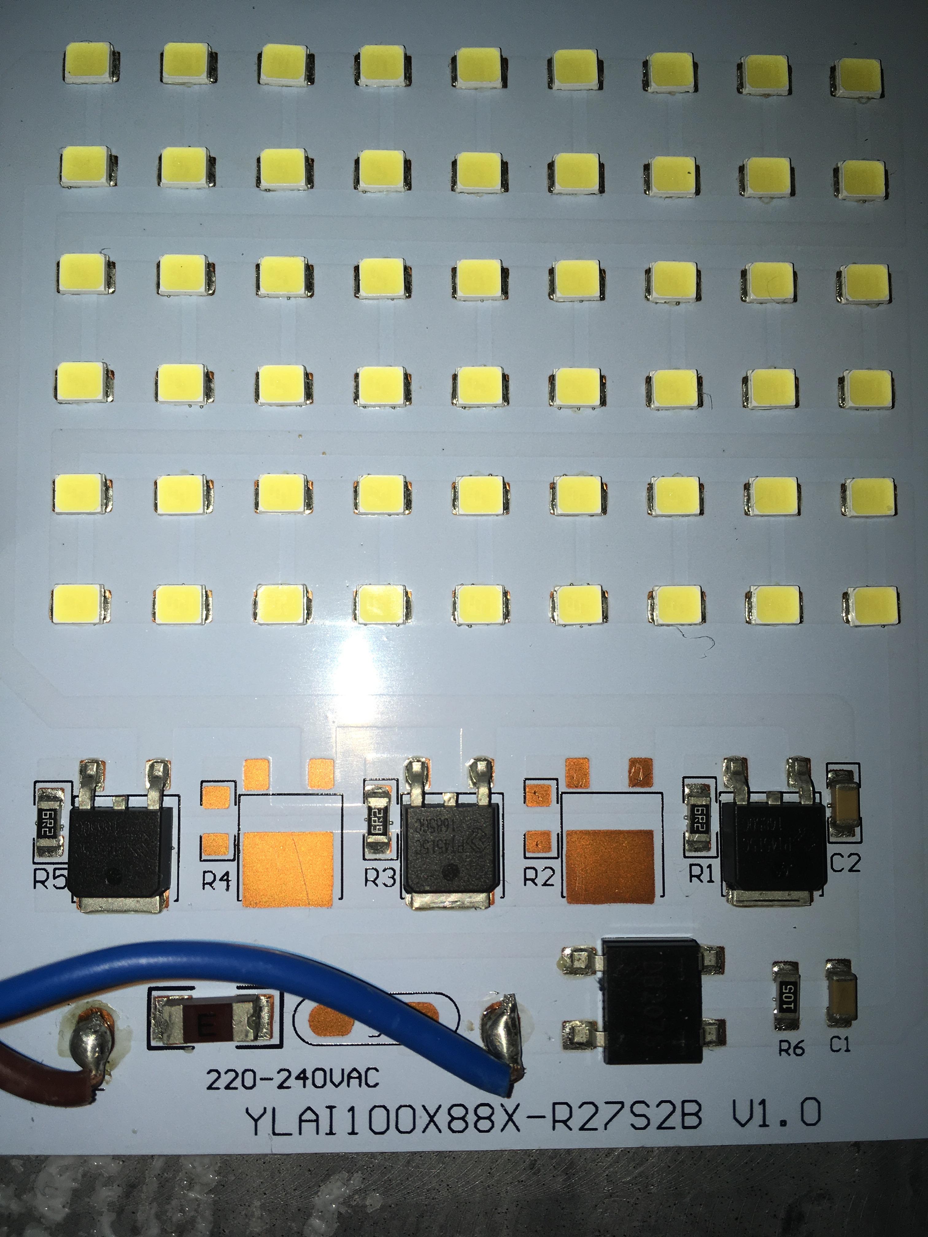

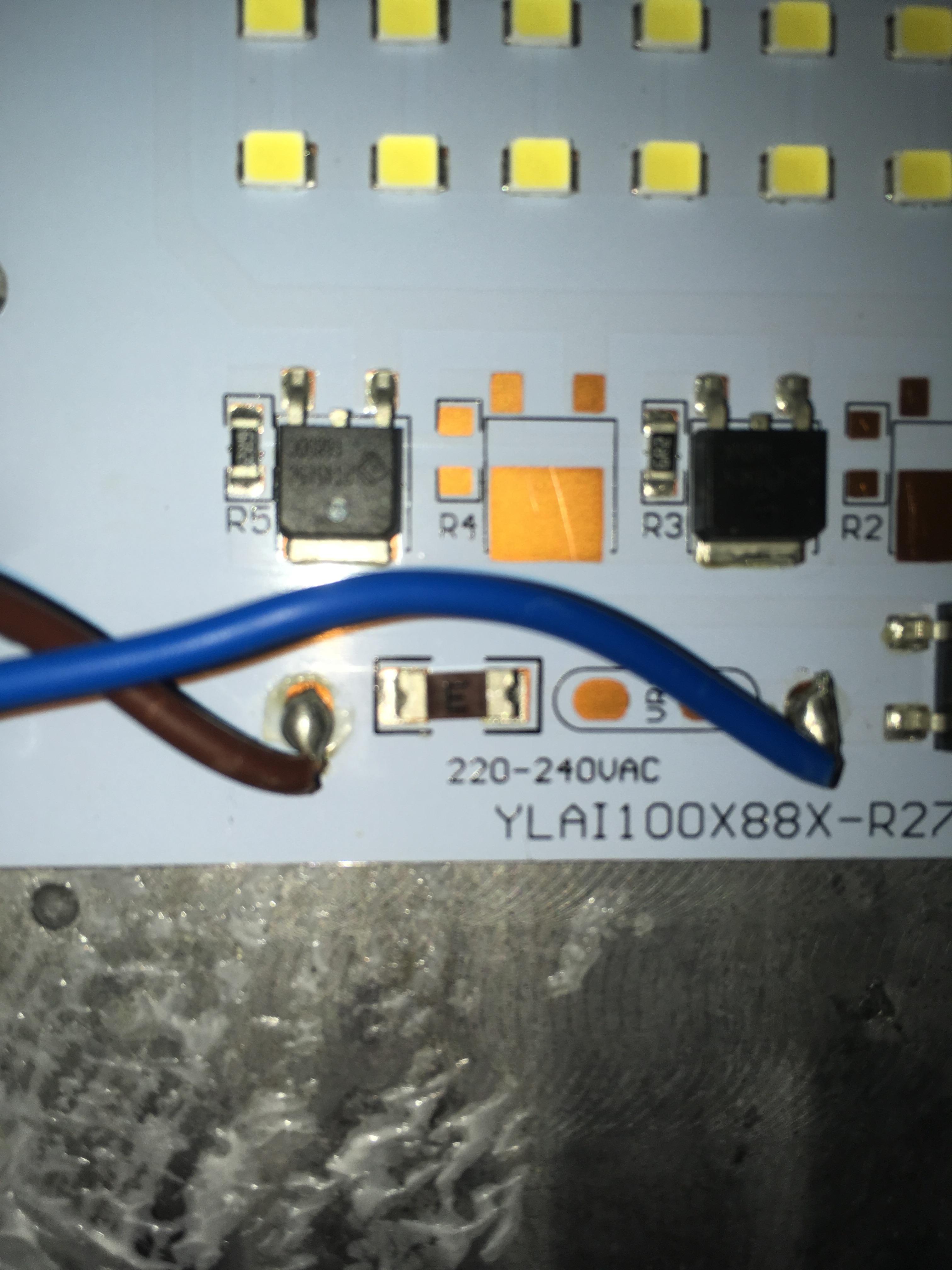

    Hello. A colleague tossed me this LED floodlight. So I'm writing here because I don't know where to start. Maybe someone will direct me where to start checking with a multimeter. Thanks in advance :)
    From determining the beginning and end of the diode chain, and measuring the DC voltage between these points.
    Voltage is - diode (diodes) on
    Voltage out - converter damaged.
    Be careful - you work with an uninsulated device from the network.

    On a good day I would not connect this floodlight to mains voltage! As you can see from the attached photos, the topology of this LED matrix is 2P27S, i.e. two LEDs in parallel connected in a 27-element series. Do all the LEDs emit light? I assume so. Probably one of them fell ('the weakest link'), the other went twice as much current, which immediately damaged it. Hence the break in the series and the lack of light emission.
    On a good day, a multimeter in the paw and checking each of the LEDs - from experience I know that this is the most common cause of failure (especially if the floodlight cooperated with a motion sensor). In addition, it is also worth checking the input fuse resistor (Fuse Resistor). The next step is to verify the power supply system of these diodes.

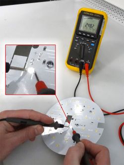

    I would suggest to check each pair of LEDs separately by setting the diode test mode on the multimeter. Each of them should emit light. Missing is either a break or a short circuit. Use a marker to mark those that are inflexible.
