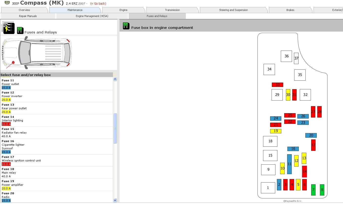

    As in the topic. Needed description of fuses and relays with setting power supply to the engine computer. No communication with the ECU, no starter operation. In other modules, a clear communication error with the engine ECU.
    Regards.
    Chris

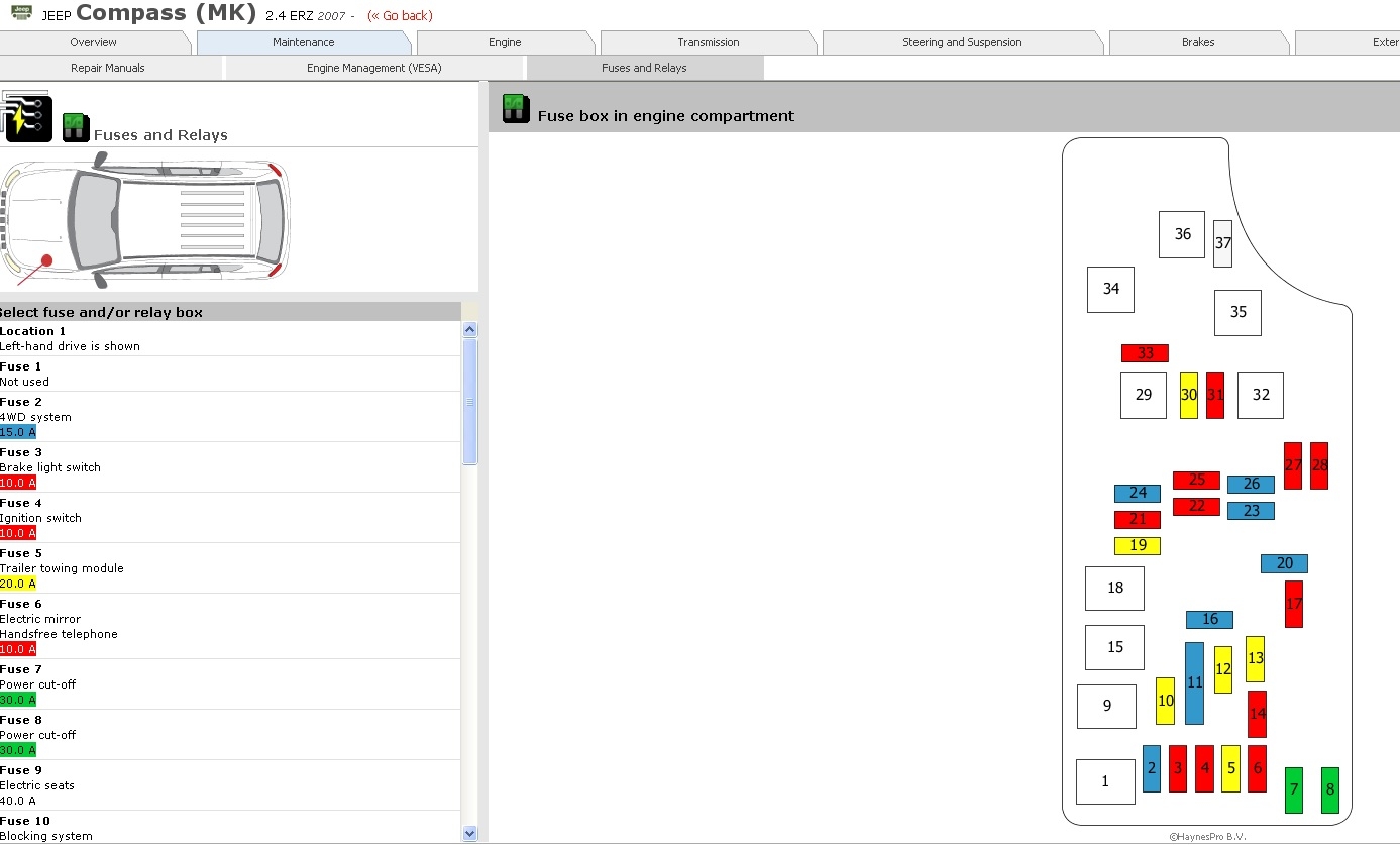

    maybe these will be good
    Jeep Compass 2008: Seeking Fuse and Relay Descriptions for ECU Communication Jeep Compass 2008: Seeking Fuse and Relay Descriptions for ECU Communication Jeep Compass 2008: Seeking Fuse and Relay Descriptions for ECU Communication Jeep Compass 2008: Seeking Fuse and Relay Descriptions for ECU Communication Jeep Compass 2008: Seeking Fuse and Relay Descriptions for ECU Communication
    greetings kris

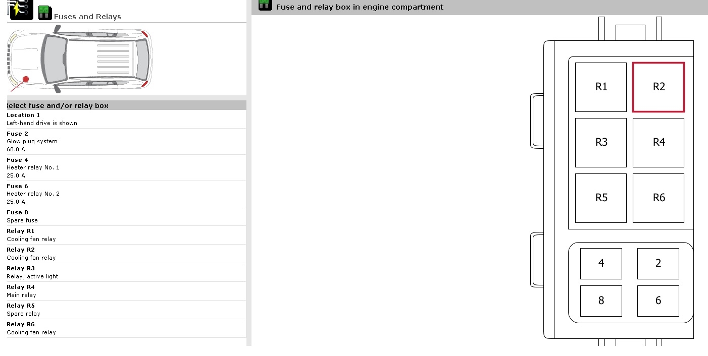

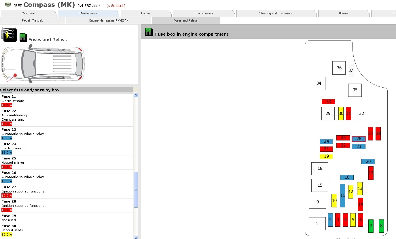

    Thank you for the schematics, but I think I have another version with the bsm module under the hood. The EDC16U31 driver turned out to be damaged. Power supply in the same places as the VAG group controller ... I added 2 pieces after bdm and after trouble.
    Regards.
