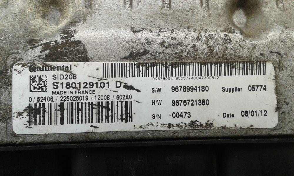

    I think the computer is different, it has 2 connectors 53 pins and one 48 pins.
    I found the pins responsible for CAN connectivity. The cables go to BSI. BSI is connected to the OBD connector. Is there any possibility if the ECU does not have a k line, connect to the ECU bypassing the BSI?

    write the computer number

    The computer looks like the pictures.
    Continental
    SID208
    S180129101 D.
    Seeking Diagnostic Connector Diagram for Engine ECU in Jumper III 2.2HDI 2008 Seeking Diagnostic Connector Diagram for Engine ECU in Jumper III 2.2HDI 2008 Seeking Diagnostic Connector Diagram for Engine ECU in Jumper III 2.2HDI 2008
    Added after 14 [hours] 5 [minutes]:
    I checked the beam, the CAN network is ok.
    For diagnostics, I tried to skip BSI, cutting off the ECU and connecting them directly to 6 and 14 OBD, but I do not know if in this configuration all the power supplies on the ECU were available, because the CAN from the ECU was cut off from the BSI, but it was still impossible to connect to the ECU

    Looking at your middle picture and plugin first on the right
    5.39 power supply
    3 Weight
    10 and 11 can.
    Sure, who did the engine overhaul and was left without a bonnet and plugs in the computer. Check if there is water in it
