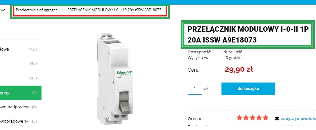

    On the electronic wholesale website, the iSSW Schneider switch is in the category of network switches - aggregate - hence my question.
    The installation is under reconstruction but will be on 3 wires, L - N - PE.
    I have the entire installation on Schneider components, therefore for aesthetic reasons the question arose about this switch.

    kanareczek89 wrote:
    On the website of the electronic wholesaler the Schneider iSSW switch is in the category of network switches - aggregate
    Various nonsense write ... this switch is single-track and you have to disconnect L and N from the network, so it must be 2P if the power supply is single-phase.
    another matter is the rated current of this switch or the preceding protection is not higher than 20A :?:
