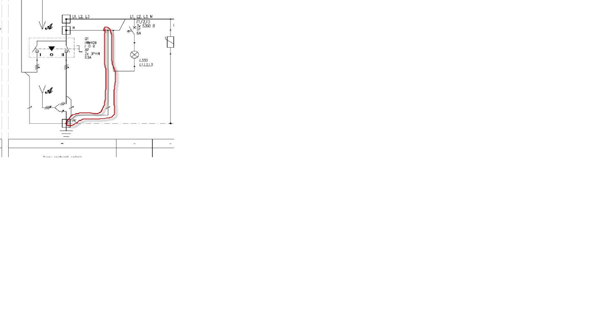

    Hello, I want to modernize the electrical installation of the relay station (installation of the network/aggregate switch). The problem is that the power cable of the station has a permanently connected N wire to the terminal strip in the cable connector (behind the power fuses - reworking is not an option). In normal cases I had no problem, because the power went to the meter, then to the switch and from the switch (together with N) to the receiver. I have doubts about this cable.
    Will the assembly diagram that I quickly drew in a well-known graphics program be suitable?
    N stands for neutral wire
    Please help, suggest Mains-Generator Switch Diagram: Modernizing Electrical Installation, Relay Station, N Wire

    I don't luv this drawing at all :/ a diagram would be better, not such a painting. The mains/generator switch must isolate power from the mains and from the generator. The question is whether it is a manual switch or an automatic one

    I'll try to draw something in the right program tomorrow if I have more time. Manual switch for information.
    Like on this page:
    link
    Generally there is a problem with the neutral wire. In this situation, it is not separated by a switch.

    You should have no problems with connecting the wires to the switch if you have the knowledge and you need to do something with the neutral wire, I'm skipping the issues of the aggregate and what about fire protection. of this device

    Hello, problem solved. The diagram I drew is correct. The neutral is not separated by the genset mains switch. This solution is accepted by the power industry due to the fact that a separate line with a transformer is connected to the ZK and is located right next to the medium voltage station. The previous assembly was incorrectly performed.
    Weird way of mounting the switch. I encountered this for the first time.

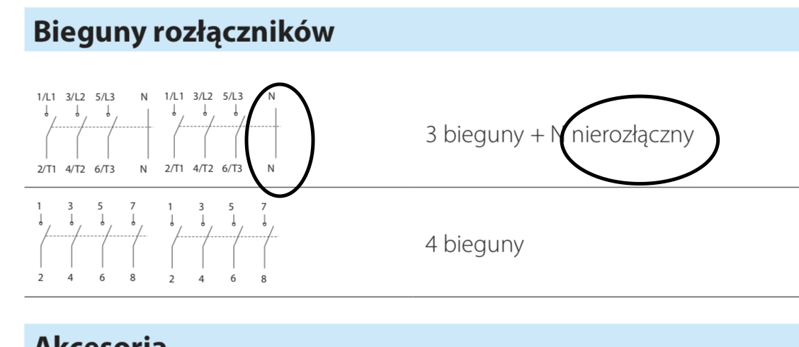

    Thanks, in fact, this HIM406 is 4P and not 3P+N, I was confused by the description in the diagram, now if I understand correctly, this connection makes sense because the author of the installation project used a 4P RCD for 1P circuits?
    The second case - for TN-CS installations where the division into PEN into PE and N is in the ZE connector and then WLZ 5x10mm flies into the building, i.e. it flies as TN-S, I understand that for installations where RCD 4P are applicable only to 400V and RCD circuits 2P are applicable only to 230V circuits, I understand that I can try to disconnect the N track?
    I will add that the ZE told me that in my case (PEN division in their connector) it doesn't matter to them, because it is already on my side of the installation.

    This is not true, the installation switch or the 3P+N power switch is designed to disconnect the N line, in this case N is connected first before the phase contacts and disconnected last, only such a disconnector should be used to disconnect N in a 3-phase system.

    e.g. hager SF463
    MartinezVip wrote:
    usually manufacturers say 3p+N then N is inseparable
    OK, N is unbreakable and there is information about it
    • XP1_SF463_6S5503D.PDF (298.29 KB) You must be logged in to download this attachment.

    with you Hager, the manufacturer does not provide anything except that it is 4P, i.e. N disconnected, I will not mention that the manufacturer does not mention anything about this order of switching on / off N, so we predict?

    After all, we have a description: Modular power switch 3P+N I-0-II 63A 400VAC
    MartinezVip wrote:
    I will not mention that the manufacturer does not mention anything about this order of connecting / disconnecting N, so we are telling?
    There was already such a topic, my friend's dilemmas were discussed in it, friend emigrant he bought it himself and proved that the SF463 works as I wrote, the representative of Hager could not answer whether this camera works like that.
    I got bored of rolling .. 4P vs 3P+N disconnectors there is a full one on the electrode, let everyone rock with this problem himself ;)

    usually manufacturers, as they say 3p+N, N is inseparable, even the famous SAMPEL:
    https://www.elektrykasklep.pl/towar/przk-3063n-w01-spamel-przelacznik-zrodla-zasilania/
    And is it possible that a person typing on a keyboard can make a mistake and the crowd can repeat it unconsciously?
    Designation: 3P+N - principle of operation: link
    So how is it with this 3P+N at all?
    Do you have this in Spamel's switch diagram?
    In the will of accuracy - on the diagram I GUESS there is an error with a given HIM406 switch model. At the stage of creating the schematic, calling Hager's technical support, the advisor presented this solution as 3P+N - that it was supposedly a mistake in the marking and that's how it went. 3P+N or 4P - theoretically, the difference is not visible when looking at the housing.
    I will not physically buy this apparatus and I will not check out of curiosity whether the track connects/disconnects first/last or evenly with the phase ones.
    emigrant wrote:
    I will return to the subject of the aggregate a little, but not completely. Hager SF463 power switch arrived today. In another topic (https://www.elektroda.pl/rtvforum/topic3350913-60.html) the topic of this switch was discussed, specifically whether the N pole has a time delay or not. Since there were any objections to this, I simply wrote to the Hager company, whether it is a 3P+N switch, where the N pole has a time delay, or a 4P one. I contacted twice and each time got the answer that it is a 4P switch, all poles turn on and off simultaneously. Even people from Hager Polska contacted some engineers, etc. Blah blah...
    I checked in a rather simple and even crude way whether the N pole has a delay. It took 2 multimeters and you can see when the contacts are connected. In addition, by switching up or down we have such a double-click. There are like 2 stages of switching and you can feel it at hand. The N pole is activated first, followed by the phase poles. This gap is quite large, suggesting only "wajcha". Some ~10 mm still need to cover the arc paths to connect the phase contacts.
    It's strange that the manufacturer himself misleads the customer. They do not have exact knowledge of their product. Even the blue marking of the N pole suggests that it is or could be 3P+N and not 4P.
    Now the question is, was this adviser telling the truth or lying? Was he a good and underrated technician or was he from a round-up? Does he still work at Hager?
    I will not answer.
    PS Not everything that is written in the catalog cards is true. There are often mistakes because the order went to print and the cost of not completing it is much higher than the value of the order. Also, is there a bug in this case ... I still don't know.
    Do not look at what manufacturers write, but at general technical knowledge and accepted principles. When you find a babola, pick up the phone and call the manufacturer with a question.

    Spamel presented 3 new modular network-aggregate switches -> https://www.spamel.com.pl/pl/produkty/modular-aparatura
    Hmm, in 4P the N track probably simultaneously shorts and opens with the phase phases. :/ Although the 4th pole is not marked as N. The question is what is the purpose of such a 4P switch ...
