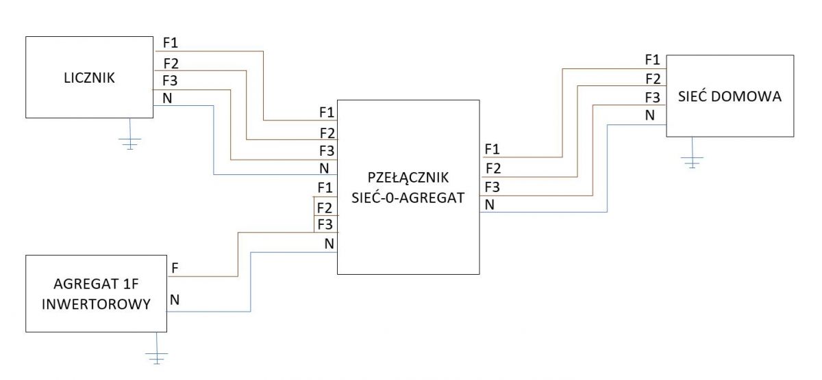

    I wanted to connect the house to the 1f generator. There is a 4-pole switch network-0-genset. The generator is grounded. An electrician came and stated that he would not bridge 3f to one (in the case of connecting the generator) because the 3-phase differential would not let it pass. I read on the net that the differential balances the amount of input and output current. Reacts in the event of a shortage (leakage) regardless of whether the phases are different or not.
    Please give me your opinion.
    edit. below is a diagram. I hope it will be readable - I did in Word.

    Obviously the genset is small in power - up to 2kW and I am aware of that. It is to run selected lighting and a fridge, maybe boiling water. The house installation is to replace extension cords.
    Additional question, how will the induction hob behave when connected to one phase? It is now connected to 3, but from what I remember it also had the option to connect to one by primitive bridging.
    Conclusion - I need to look for another electrician.
