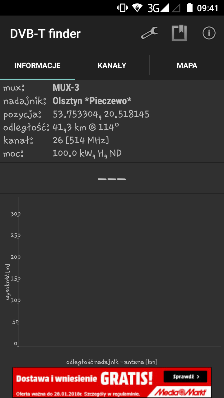

    Hello, my mesh antenna is completely broken. And because it is on the balcony, it will often be tapped and moved. I am thinking of buying the xenic av9003c antenna. Such an antenna is enough for 40km?
    • Xenic AV9003C Antenna: 40km Range Enough for Broken Mesh Antenna Replacement? Screenshot_2018-01-24-09-41-02.png (143.39 KB) You must be logged in to download this attachment.

    I'm afraid it may not be enough as the terrain is hilly and wooded.
    It's best to buy the most ordinary Yagi antenna of several elements and set it to Olsztyn-Pieczewo.
    A cheap, simple and effective solution.
