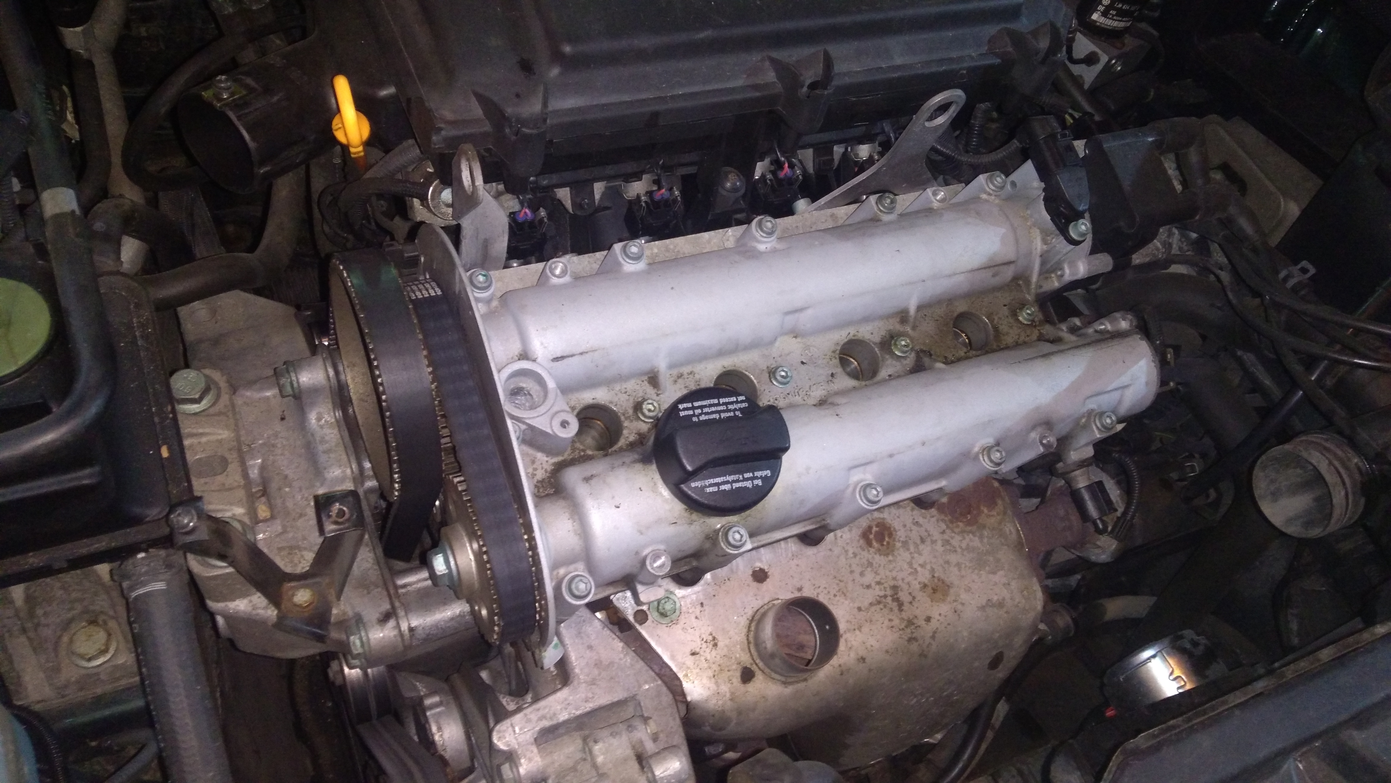

    Hello. I would like to take off the VW Golf 4 valve cover. I am not sure I have to unbutton the valve as well? Has anyone can info, step by step, what with what? I need to glue the gasket lightly, because the oil "flies" to the candle.
    • VW Golf 4 1.4 16V: Valve Cover Disassembly & Gasket Repair - Step by Step Guide 15169624273591181015366.jpg (2.92 MB) You must be logged in to download this attachment.
    • VW Golf 4 1.4 16V: Valve Cover Disassembly & Gasket Repair - Step by Step Guide 1516962376760786475373.jpg (2.84 MB) You must be logged in to download this attachment.

    The lid is at the same time the housing (bearing) of the camshafts, you must remove the toothed belts. Do not put on silicone, use a special sealer, eg AFD 2000 Elringa

    As far as I know, this cover is immediately attached to the rollers.
    If I take off gears then how to set the timing?

    You download the lid.

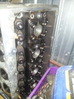

    That's how it looks without the rollers and horses, and one.
    You download the top cover or cover it as you call it.

    It's already time, two drill bits 8 block the shafts, shaft on sign and download the pillow and then the tensioners and straps, cool.
    Added after 10 [hours] 3 [minutes]:
    For the first time it was not easy but it went, I recently unbuttoned the timing in VW 2D 1.6 and it was 10 years ago. It's a bit different here, but if you ever need a hint, I'll help. Thank you for previous hints.

    It's best to replace the timing with a new one, but there are those who only exchange the belt and drive. I cover and the heads have been roughened and I gave a car silicone. Nothing leaks. After all, I did not even have any gasket, what I saw was just some glue.
