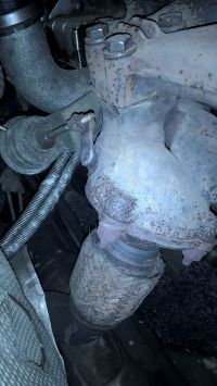

    Or maybe this barbell is standing? Because with me it looks like this:

    Check manually that the bar is moving.
  • #6 16845200
    ZdzisekChytrusek
    Posts: 38
    I checked the barbell and it moves, but it is rather light, minimal.
    I don't know if it's supposed to be like that? should she walk smoothly and strongly?
    If I take the key, I don't know, is it probably 10? flat - then I can pull the bar a bit, will it all go apart and the turbine or the engine will crash?
    Due to the different pressure etc?
    Obviously not drastically somehow, one turn the bottom and top nut.
