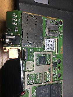

    nygus_ek
    Posts: 39
    Rom downloaded, unfortunately option # 1 from the guide did not help.
    Cable with resistor made, one end soldered to ground.
    Question 1: Where is the test point?
    Question no. 2: Maybe a bit silly, but this is the first time I do it. Is it done with a battery?
    I attach photos
    best regards

    #4 16997333
    nutergsm
    Posts: 8429
    Help: 1034
    Rate: 1665
    I do not see such points here, you would have to disassemble the tablet more and insert more detailed photos.

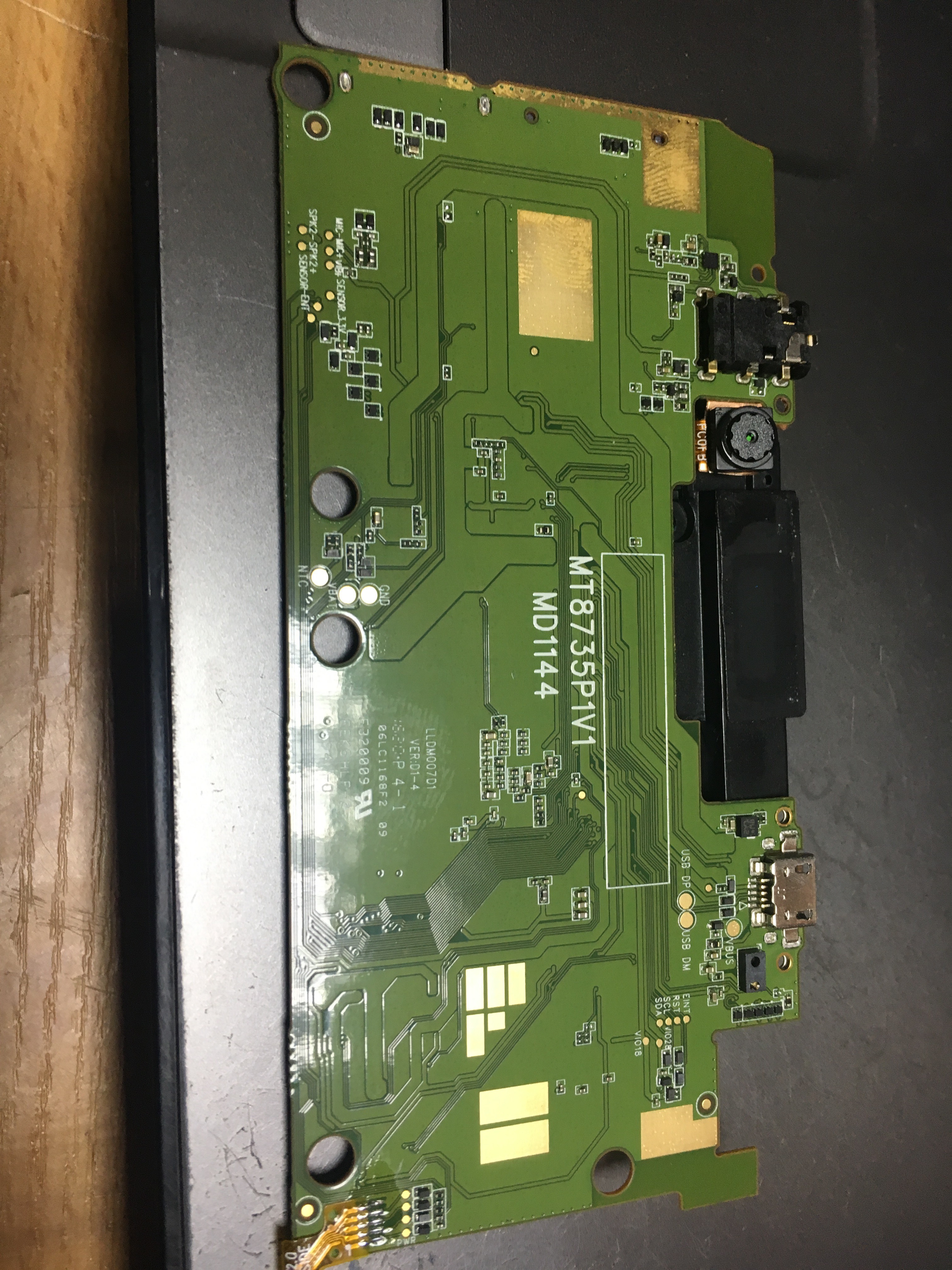

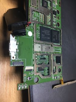

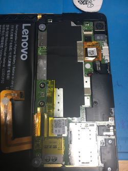

  • #5 16997408
    nygus_ek
    Posts: 39
    Lenovo Tab2 A8-50L Bricked After ROM Upload via SP FlashTool - USB Ammeter, MediaTek Drivers Lenovo Tab2 A8-50L Bricked After ROM Upload via SP FlashTool - USB Ammeter, MediaTek Drivers Lenovo Tab2 A8-50L Bricked After ROM Upload via SP FlashTool - USB Ammeter, MediaTek Drivers Lenovo Tab2 A8-50L Bricked After ROM Upload via SP FlashTool - USB Ammeter, MediaTek Drivers Lenovo Tab2 A8-50L Bricked After ROM Upload via SP FlashTool - USB Ammeter, MediaTek Drivers
    Are the photos enough? Do any element be done in more detail?
    best regards
    I ordered a new disassembly board - cost about PLN 100 for a 3-month warranty. Thanks for trying to help :)
