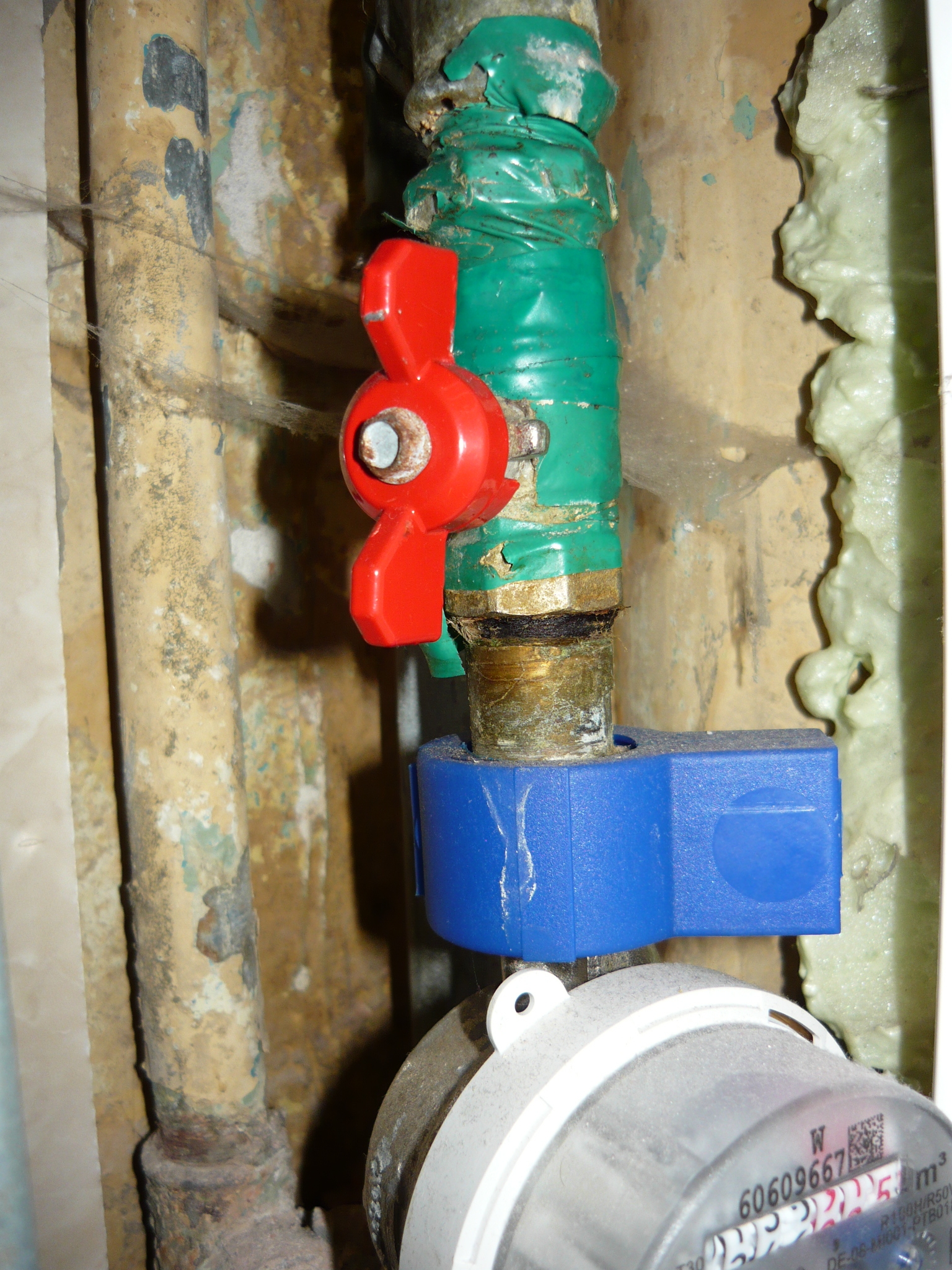

    Let me use this topic. I have a water ball valve with a butterfly installed before the cistern. Now, after almost 10 years, it is difficult to turn with a butterfly, and it is almost impossible to turn without pliers. Is there any way to relieve it without disassembling it?

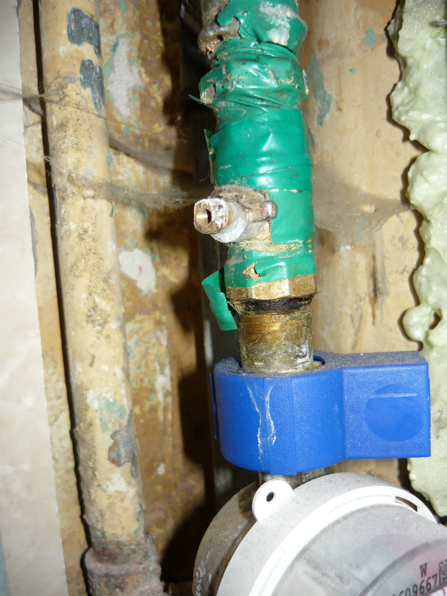

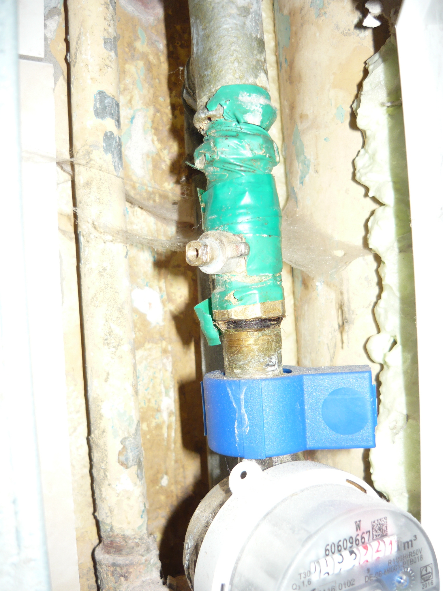

    Photo present. The flush ball valve does not want to turn.

    That is, an exchange. I won`t do it myself, because I would have to close the vertical and for that I need the consent of the cooperative. After removing the butterfly, I don`t know if there is a choke there, it`s hard to tell, I cleaned it a bit but I still don`t know.

    The valve needs to be replaced and that`s it. Over time, sediment has built up there and there`s nothing you can do about it.
    You simply have to close and open it once a month. :)
