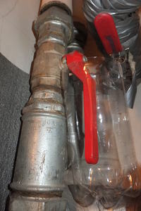

    I started to leak a 1 1/2 inch ball valve without a gland after 10 years.
    The cost of such a new valve is quite significant. The repair would involve disassembling it and replacing the gaskets on the shaft of the handle. The question is, will it last just as long? Replacing or repairing the valve involves draining some of the water from CO.
    I have a question, what are you advising me? Replace the valve with which one? To fix? Has anyone repaired such a valve and how was it durable?
    Below is a photo of the valve and a temporary leak protection.
    1 1/2 Inch Ball Valve Leak: Repair vs Replacement - Longevity, Cost, & Gasket Considerations 1 1/2 Inch Ball Valve Leak: Repair vs Replacement - Longevity, Cost, & Gasket Considerations
    Regards

    Yes, some valves are made incorrectly, because the eccentric in the middle is too tight and it pushes against one of the axle walls and destroys the O-rings.
    So when you take it apart, make some slack in the eccentric and replace the o-rings and you have years.

    Don't rummage, just try to file a claim with Valvex. After all, they boast 25 years of warranty, I wonder how they will react.

    101pawel wrote:
    It all depends on the role this valve plays in the installation. If it is there "for the sake of principle", or if you perform the closing and opening operation once every few years (?), The repair would be limited to removing the knob and putting a rubber stopper on the protruding pin, and then tightening it with a pin. The plug must have a slight recess, possible to be drilled, so that it fits snugly onto the pin. It used to be like this in heating nodes, when it became fashionable to replace mushroom valves with ball valves, and these were made only with an O-ring seal; - sometimes it leaked after 10 years, but after 10 days. If, on the other hand, you use the valve often, I think you should rather buy a new one - of a better design. This cut bottle does not look too bad, it adds color to the installation ;)
    The valve is not used very often. But I don't like makeshift. It is likely to run more. The bottle works in this position. It does not fulfill its task when the valve is closed.
    The valve, which is more often used, Valvex 1 1/4 without a gland, I replaced it 2 years ago, so it lasted 8 years. However, I have a rule that if a device breaks down, I never replace it with a device from the same company as shown in the photo on the handle of another valve. I recommend this rule to everyone . If not repair, what valve do you recommend to me?

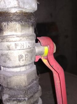

    I am new here and I would like to hook up to the topic. Namely, I have a similar problem of a leaky valve without a gland.
    My question is whether I can replace the valve head without unscrewing the valve from the installation. Second thing if I have to replace the entire valve, is it necessary to drain the water from the heating system?

    Friend, if you are sure that the shown valve does not have a gland, you checked after removing the handle. It looks to me that these valves have stuffing boxes. greetings.

    I also had the impression that this valve has a throttle. You would have to tighten it. But if there is none, then you will not need to unscrew the valve and drain the water. Theoretically, such a valve can be repaired, you need to unscrew it, remove the ball, then the spindle with o-rings and replace the rubber o-rings. However, I would not install the valve without a gland in a place where a lot of water has to be drained to replace the valve.
    I will just add that I still have not replaced my valve, unfortunately it has started to leak for a month.

    roman18 valve does not have a gland, it is valvex but is 15 or more years old. If he had a gland, there would be no problem because the leak is between the handle and the valve. And of course I was removing the handle, moreover, whether the valve has a gland or not visible and without removing the handle. Besides, there is no thread inside the valve.
    Sstalone I will not play with the repair, the cost of the entire valve with a gland from Invena is about PLN 35-40. So of course I'll buy a new one. There is a gravity check valve next to the furnace, when there is no electricity and the pump does not work, it lets off water. I do not know about the construction of this valve, but I thought that thanks to it I would not have to drain the water from the entire installation .... thank you for your interest and suggestions, best regards.

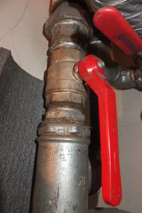

    Maybe it will be useful to someone in the future. At my exit from the boiler, the valve started to leak. Little used valve, so it makes no sense to drain the water, flood, bleed again, etc. I rolled out a polyurethane (elastomer) gasket and put it between the valve and the levers. I turned it with a lever screw and in the third season there is not even a drop. That's it. Fota will say more than describing, so I attach a photo.

    Tip. Ball valves are reliable, better than mushroom valves, but you have to choose the ones with a throttle, not just the cheapest, the worst. In the case of a valve with a throttle, it is possible to perform a simple repair (replacement of the O-ring).

    You can get a doctorate in any field, yes, you can stand and watch your hands. But it is a bit difficult for "Kowalski" to make a doctorate out of everything. However, it's hard to disagree that many things are made with cheap components and the flowers come out after x years. A temporary solution - instead of putting bottles or buckets on it, it is enough to seal it and there is no problem. Replacement for such a valve with a throttle yes, but by the way, not immediately. The valve I showed is at my outlet from the boiler in front of the central heating pump. The second is behind the pump. They were to serve as a possible shutdown of the system in order to replace the pump. The pump has been in operation for 20 years and one valve is leaking. Life .......
