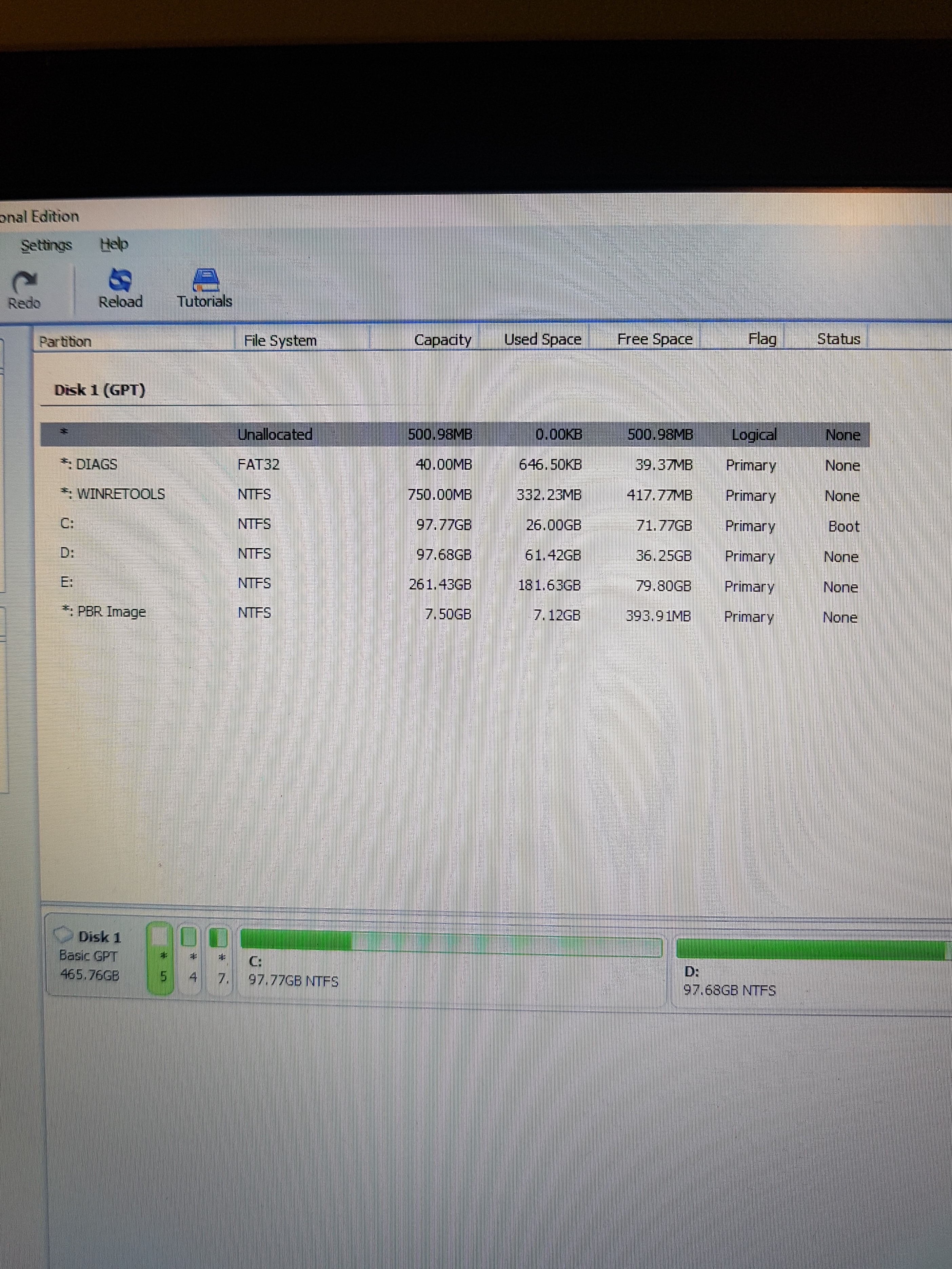

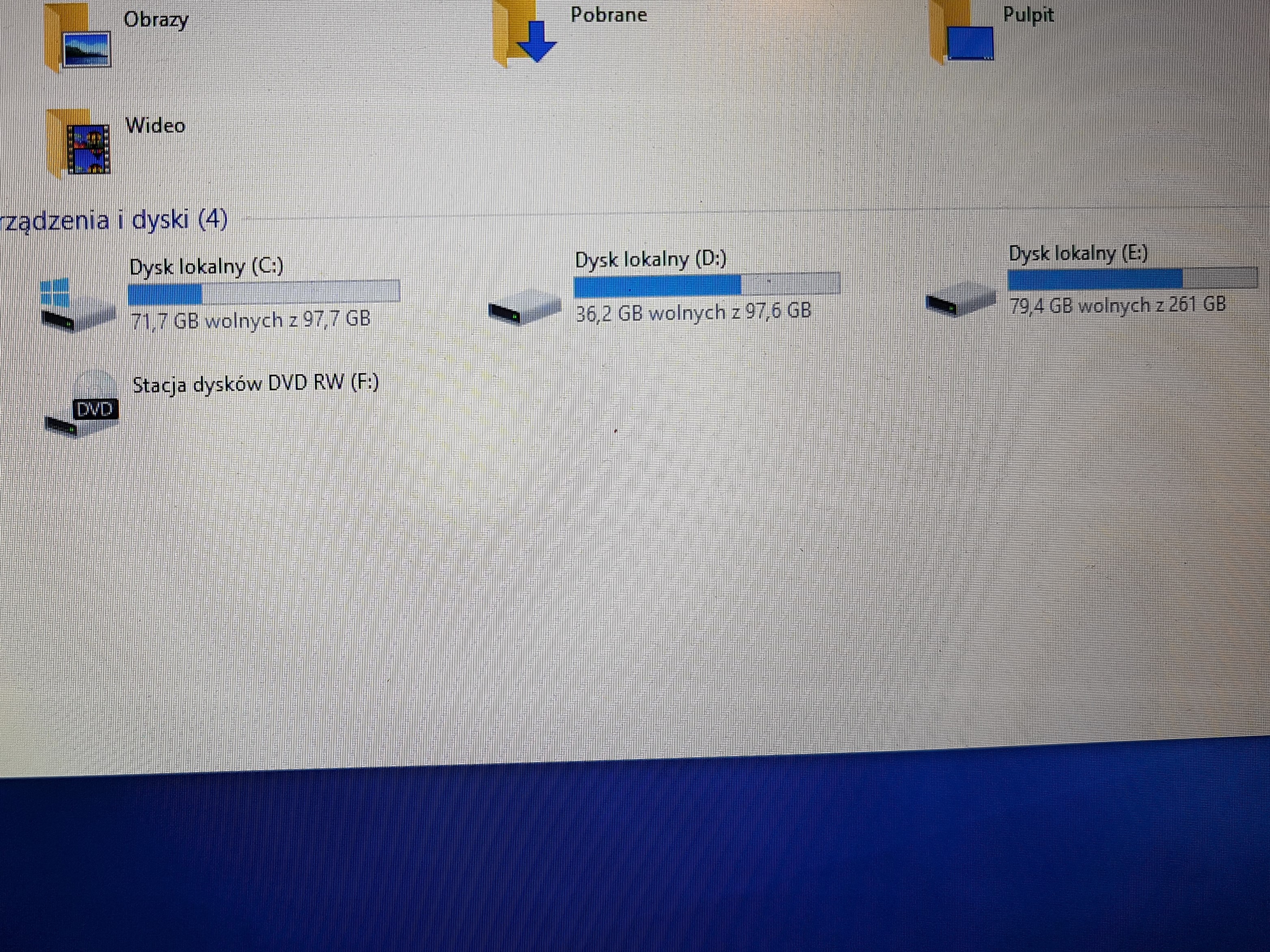

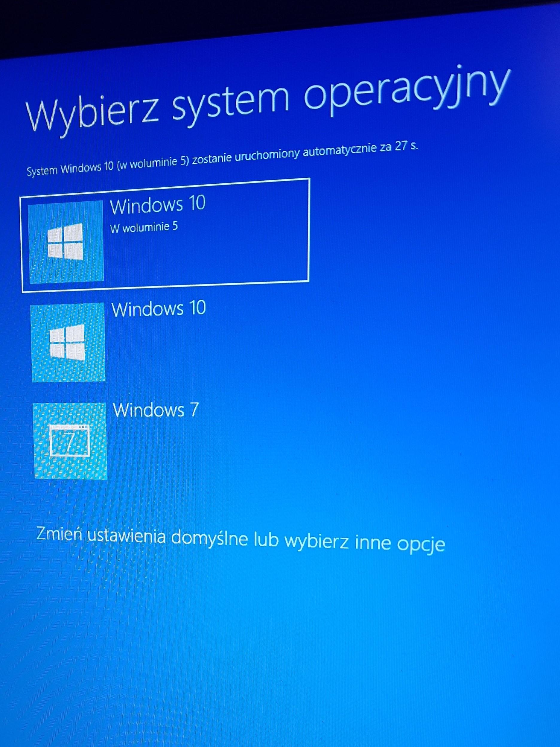

    Hello, I installed a Windows 10 64 bit disk on which Windows 7 is and was Windows 10, but I formatted this partition before installing Windows 10 and there was a problem because when I started the computer, a window with three systems pops up (with one win 10 which is not there) and this installed on volume 5. How to clean up these partitions. Please help,

    mayday28 wrote:
    I installed on a windows 10 64 bit drive which is windows 7 and it was windows 10 but I formatted this partition before installing windows 10
    It's on the "disk", have you installed the new W10 on the partition?
    You have GPT, so booting is UEFI.
    As you can see, simply reformatting the partition with the old system is not enough.
    Entries to the BCD remain stored on the ESP partition.

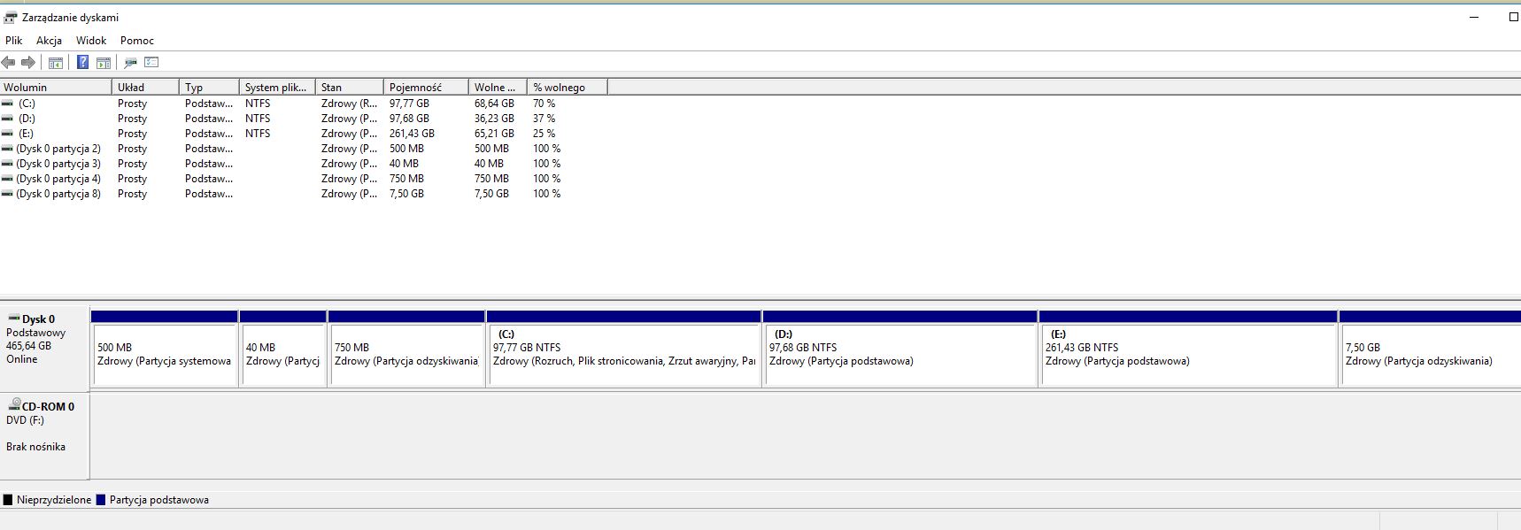

    this is what it looks like I don't know what's going on with these partitions 2,3,4 8 generally on C there is windows 10 on D windows 7 and on E: a data partition, I can delete these partitions 2,3,4,8? or not because there's a boot partition somewhere

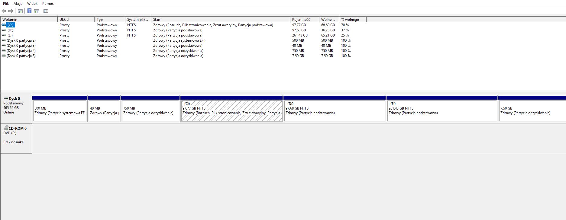

    this is what it looks like when stretched

    As you can see, partition 2 cannot be deleted because it is an ESP system partition.
    4.8 partitions are recovery partitions - they can come in handy but you can delete by of your own discretion.
