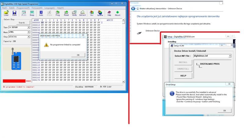

    Hello, a friend bought EZP2010 and asked me for help in starting the programmer, but despite many attempts we were unable to install the device. On Windows 7 (64bit), neither 32bit nor XP does not connect to the computer: "No program linked to ...." It does not help to manually point to the drivers on the CD, the manager shows "Unknown Device" despite "Windows has determined that the software for this driver is up to date "
    I am asking for any suggestions on how to run the programmer, maybe some links to the instructions, tutorials?
    The programmer only worked on the first connection on Windows 7 32bit - read the content from Atmel, uploaded a new one, there was no problem until the computer was turned off. Later, multiple attempts on the same and three other computers failed. I have no idea how to move it. All packages with Electrode drivers do not work.

    Try these drivers. I had problems running on Win7 x64 from what was on the disc.
    • EZP2010 v.3.0 Programator win 7 x64.rar (3.02 MB) You must be logged in to download this attachment.

    Unfortunately, the conflicting messages themselves, the exclamation point in the manager and the wizard, that the current driver. Files from the source above did not help.

    C:UsersB***DesktopEZP2010 v.3.0 Programator win 7 x64EZP2010 v.3.0 Programatorenglishusb driverDriver_EZP2010vDriver_EZP2010v3_x86_x64EZP2010.inf
    Windows 10 64 - all is OK.
