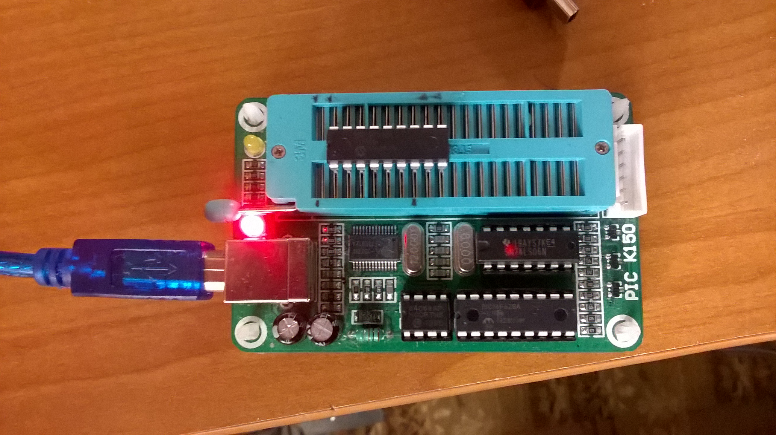

    I have a problem with the PIC K150 programmer supported by the microbrn program,
    I am using win10 on the earlier win7 was working fine.
    To make it funnier, I have the same program on another winXP computer. It was working normally before and not now.
    There is a 1.jpg image when you turn on the programmer.
    I put the processor in the 2.jpg programmer.
    Then the 4.jpg screen appears
    I have no idea what to do (attempts with other processors also fail).

    The symptoms are as if the programmer cannot see the CPU. This would mean that the ZIF was not properly inserted into the socket, but it is not the case. The programmer itself is damaged. But I don't see the reason.

    I checked my friend's computer (win7) works. I checked with my USB cable.
    Added after 1 [hours] 3 [minutes]:
    On the profilic.com website I found an instruction which shows that the PL-2303XA / HXA chip does not work under win 8/10. But to make it harder, there is the same chip in the satellite cable and the satellite software works with it.

    Uninstall this COM port and try to install the driver from the attachment. Also try to set the COM port to a higher one, eg COM3. In addition, I also had errors when it comes to communication with this programmer, but surprisingly, when I put the chip (12F508), it read and programmed it correctly. Maybe it is similar with you ...? :-)
    Ultimately, if you are going to stay with Win 10, I recommend you install VirtualBox and then Win XP in it and try playing in a virtual system. VirtualBox supports the USB port.

    Thank you for your response . I ran on XP and everything works.

    You should not let Windows update drivers. After updating the driver does not work with error code "10".
    Regards and I close this thread.
