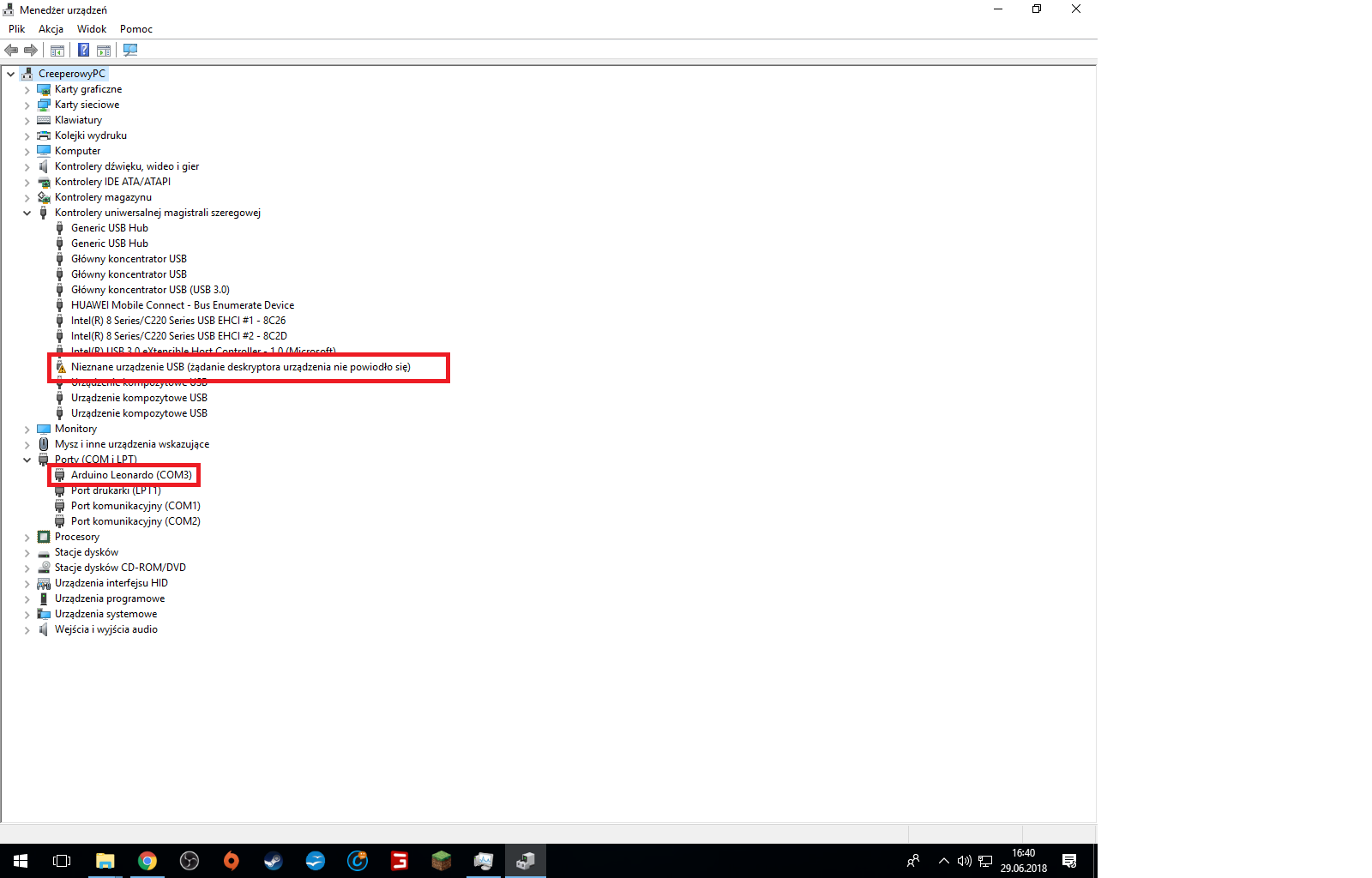

    I bought a usbasp programmer and I have a problem with drivers. I downloaded drivers from www.fischl.de, installed mkAVRCalculator and also with the help of the zadig program. In all cases, this error crashes me:
    Arduino: 1.8.5 (Windows 10), Board: "Arduino / Genuino Mega or Mega 2560, ATmega2560 (Mega 2560)"
    C: \ Users \ Admin \ AppData \ Local \ Arduino15 \ packages \ arduino \ tools \ avrdude \ 6.3.0-arduino9 / bin / avrdude -CC: \ Users \ Admin \ AppData \ Local \ Arduino15 \ packages \ arduino \ tools \ avrdude \ 6.3.0-arduino9 / etc / avrdude.conf -v -patmega2560 -cusbasp -Pusb -e -Ulock: w: 0x3F: m -Uefuse: w: 0xFD: m -Uhfuse: w: 0xD8: m -Ulfuse: at: 0xFF: m
    avrdude: Version 6.3, compiled on Jan 17 2017 at 12:00:53
    Copyright (c) 2000-2005 Brian Dean, http://www.bdmicro.com/
    Copyright (c) 2007-2014 Joerg Wunsch
    System wide configuration file is "C: \ Users \ Admin \ AppData \ Local \ Arduino15 \ packages \ arduino \ tools \ avrdude \ 6.3.0-arduino9 / etc / avrdude.conf"
    Using Port: usb
    Using Programmer: usbasp
    avrdude: Warning: cannot query manufacturer for device: No such file or directory
    avrdude: Warning: cannot query product for device: No such file or directory
    avrdude: error: could not find USB device with vid = 0x16c0 pid = 0x5dc vendor = 'www.fischl.de' product = 'USBasp'
    avrdude done. Thank you.
    Error loading bootloader.
    I tried on two computers and the same. I am asking for help because I do not know what to do anymore, and I need to program the Aruino mega for a 3D printer

    The driver files have the * .inf extension, try to install from the Device Manager.
    Michal1848 wrote:
    and i need to program Aruino mega for 3D printer
    Arduino on what ATmange do you have?

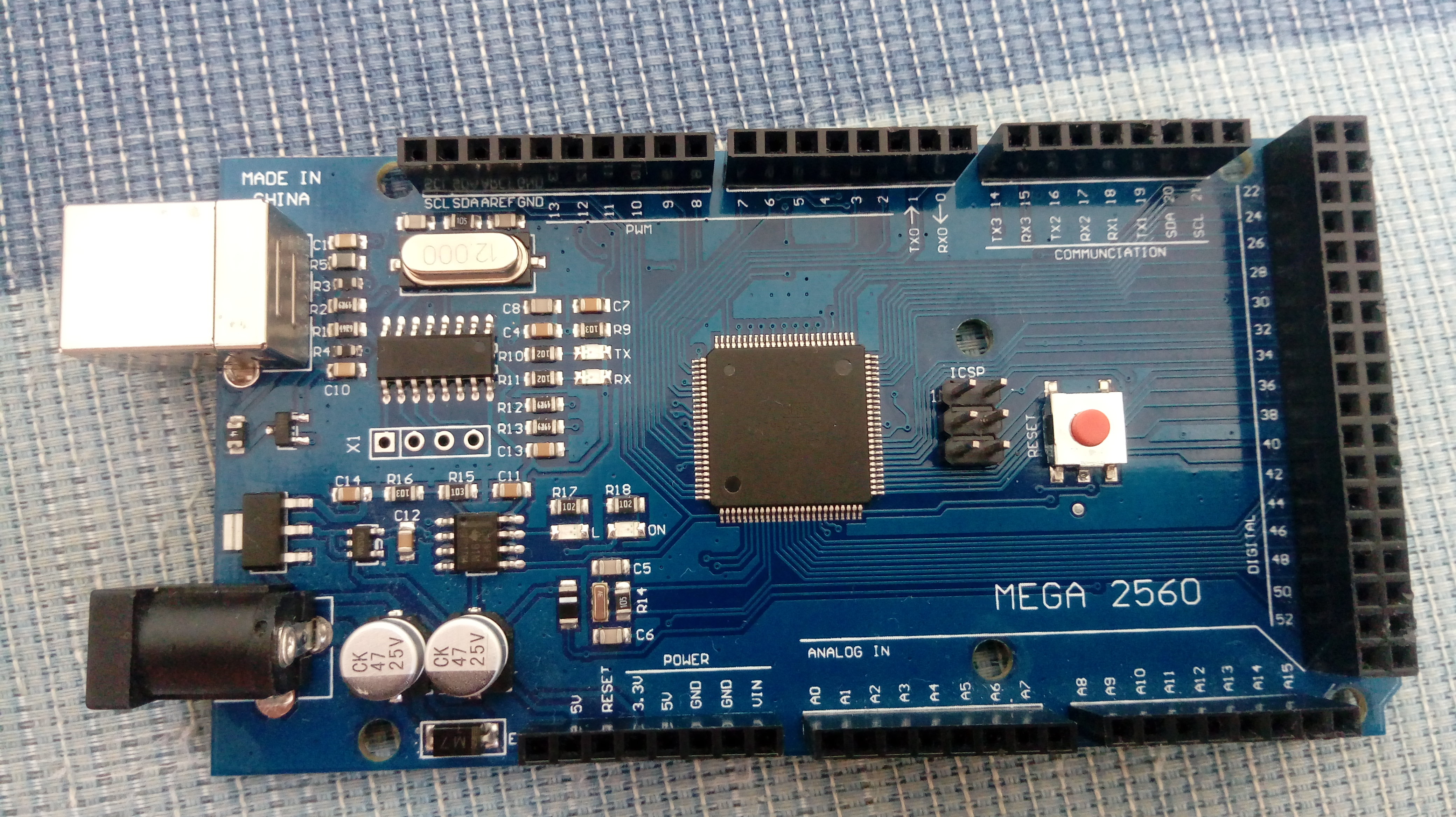

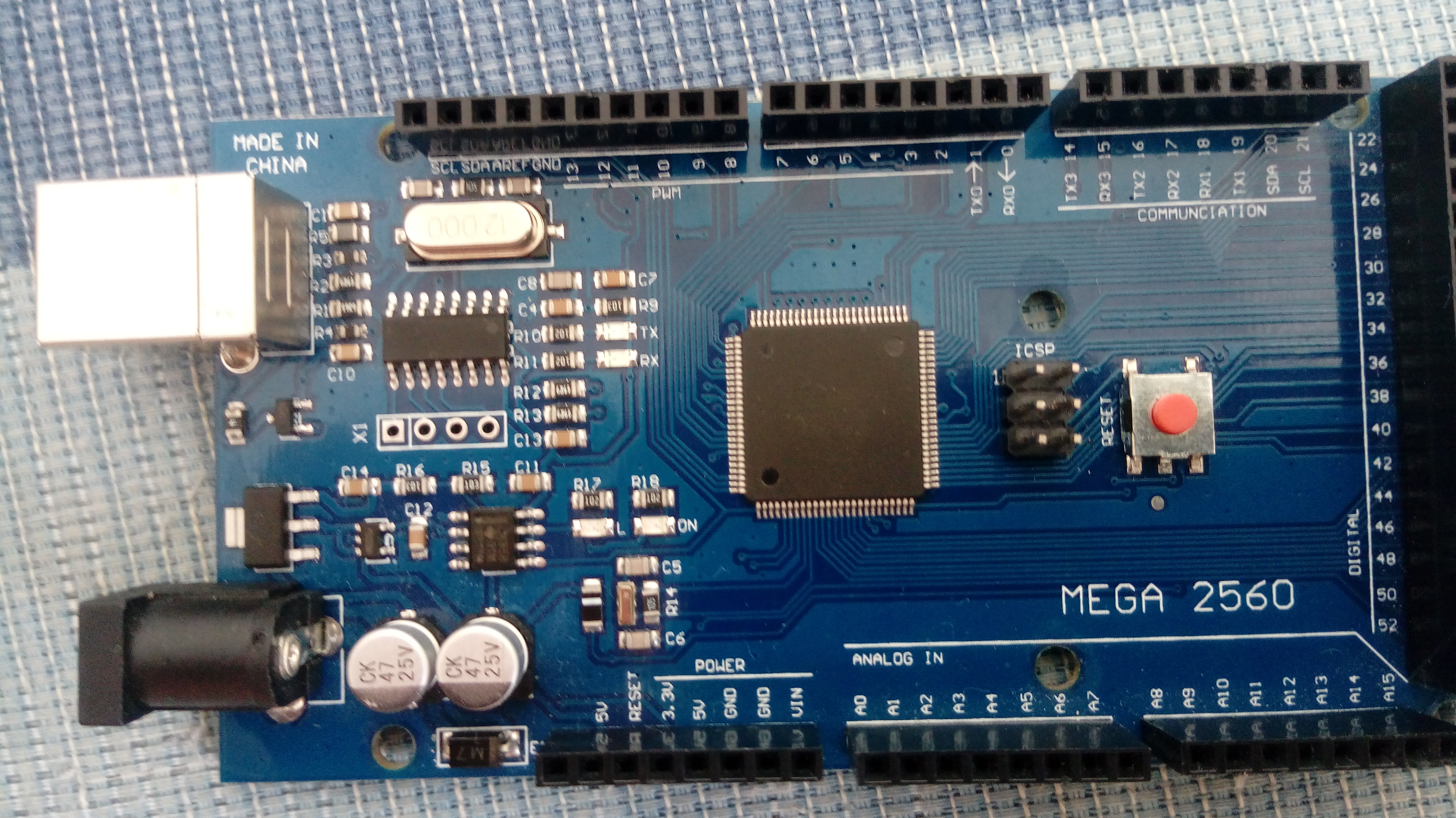

    I have an arduino mega clone on the atmega 2560 16au at the usb socket, as my colleague previously wrote a 16-pin longitudinal layout, not described. After five arduino to usb, I have a problem that I fought with here http://forum.feriar-lab.pl/showthread.php?tid=127, i.e. after connecting the Arduino, there was an error that the descriptor request failed. My programmer is based on atmege 8a

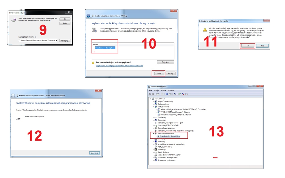

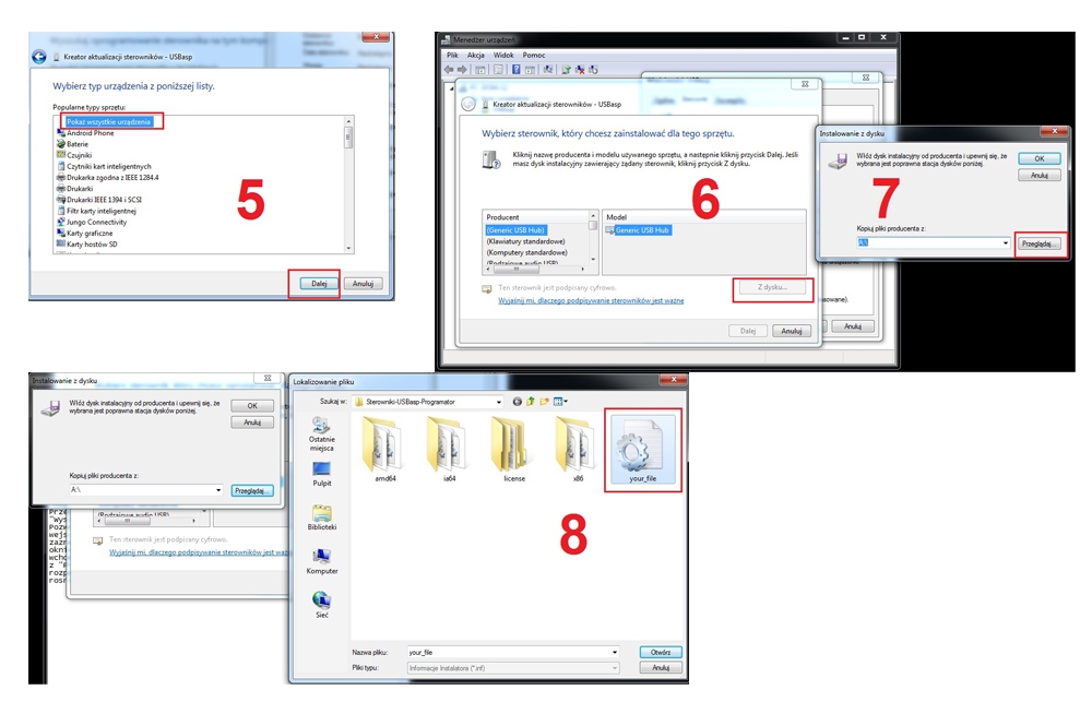

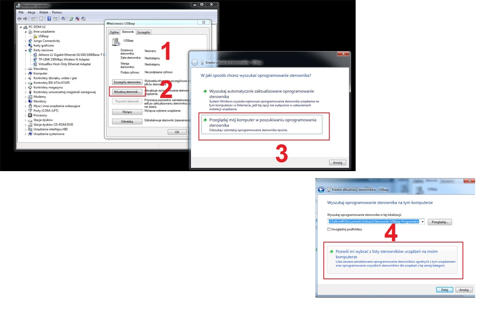

    Step by step - Installing the USBasp Programmer driver
    The programmer is used to install the software if it has been damaged for some reason or to upload the program without using the environment, eg IDE
    The USBasp programmer placed in the USB, preferably always the same USB in the PC, is for the future. We install drivers for the USB programmer manually from the Device Manager.
    In Device Manager, click "Right Mouse" (PM) on "USBasp" with a yellow exclamation mark and drop down the list from the list, select "Properties" in the "Properties: USBasp" window in the "USBasp Properties" window, select "Update Driver", a new window appears "Driver update wizard -" USBasp "here you select the option" Browse my computer for software ". In the new window "Search for driver software on this computer" you select the option "Let me choose from the list of device drivers on my computer". After entering this option, the next window appears with a list of devices, here you select the option "Show all devices" and then go "Next" in the "Select the driver you want to install for this hardware" window you enter the "Have disk .." option and in the next window (7) "Installing from disk from" Browse ... "you select the directory with the USBasp driver (previously unpacked) Drivers-USBasp-Programator.zip and you are looking for a file with the * inf extension, i.e. "your_file" (and it will be your_file.inf file), select this file and accept it with "OK", in the next window you have already confirmed the USBasp driver "Isert device description", click further confirm the warning and after acceptance, you have a window about successfully updating and uploading the driver software for the USBasp Programmer. You close all windows and check in Device Manager if the USBasp programmer driver is installed.
    Step-by-step screenshots of the USBasp Programmer instance stage
    Usbasp Programmer Driver Issues: Arduino Mega 2560, ATmega2560, Zadig, Fischl.de & mkAVRCalculator Usbasp Programmer Driver Issues: Arduino Mega 2560, ATmega2560, Zadig, Fischl.de & mkAVRCalculator Usbasp Programmer Driver Issues: Arduino Mega 2560, ATmega2560, Zadig, Fischl.de & mkAVRCalculator
    greetings kiss39

    Michal1848 wrote:
    Installing drivers from the arduino environment does not change anything and I know what a properly connected arduino looks like because I have a working Leonardo
    Everything indicates that you have this module damaged. Unable to read descriptor indicates this. Probable connection error, maybe bad USB resistors, or maybe the IC itself is dead. I would start by checking if the pins from the USB port have a "transition" to the chip.
    Sometimes it also happens that the Chinese install wrong resistors on USB circuits, especially those from USB- to the supply voltage. There should be a resistor of about 1.5 kOhm
