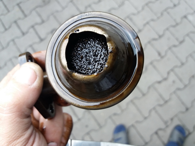

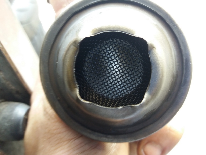

    When was the engine made? Maybe it's worth having a look at the dragon in an oil pan - you know the ailment?
    Just like a colleague writes and this is exactly what it looks like.
    Audi TT 1.8 Turbo 180km 1998: Red Circle Light and Oil Pressure Indicator Post-Engine Shutdown
    And it should look like this ;) and this photo is also 1.8T
  • #9 17020004
    jazo2121
    Posts: 12
    Ok, I will check the dragon thanks
