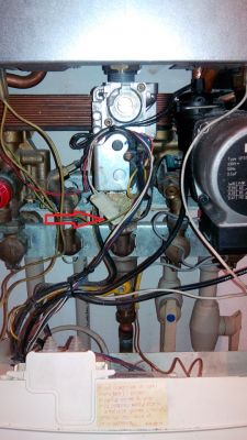

    I have a stove as in the subject. For several days the house in which it is installed has not been inhabited. So I turn on the stove almost every day for about 2 hours.
    I noticed that as I enter the next day into the room where the pioec is mounted gently and only under the stove you can feel the gas!
    This only happens when I leave it turned off with a round transparent on / off button on its housing or with the plug removed from the socket, but the gas valve open.
    I suspect:
    - a leaking gas valve head, but only in the "open flow" position ... only that then between the gas consumption / heating cycles it should also escape
    - traces coming from the furnace itself, for the conditions described above
    After starting the furnace I am in close proximity to it and I don't feel gas at all. Similarly, during ordinary daily work, when the house is inhabited.
    Do you have any idea?
    Inspections carried out regularly by an authorized Junkers service every about 1-1.5 years. Checked and reliable technician.

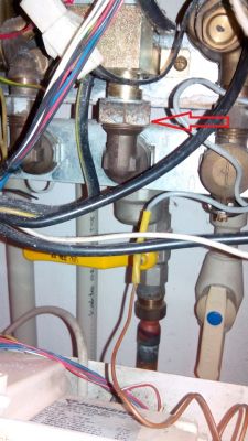

    I am making up ... the called gas filler checked with a gas sensor that the leak is under the screw connection of the assembly marked on the drawings:
    Smell of gas sensed under the Junkers ZW14-2DV KE combi boiler Smell of gas sensed under the Junkers ZW14-2DV KE combi boiler
    After replacing the seal, it is approx.
    In addition, the "union" removed, which was installed BEFORE the shut-off valve ... can be seen clearly in the pictures. We have such professionals !!!
    Which is VERY IMPORTANT ... with the gas sensor in my hands, I checked the installation. It turned out that there are still 3 leaks in two buildings !!! Surprisingly, there was no smell of gas at all, which, after all, is very strongly odorized - even putting your nose under unlucky places.
    Check the installations as you get the opportunity !!

    There should be absolutely no screw connections or long threads upstream of the shut-off valve, as these are potentially leaking places (especially so-called long threads). This screw connection marked with an arrow (behind the valve, so in the right place) had to be damaged (crack on the cone, etc.), unscrewed or the pipe positioned incorrectly. By the way, there are also fittings with O-rings that ensure 100% tightness (until the O-rings grow old).
