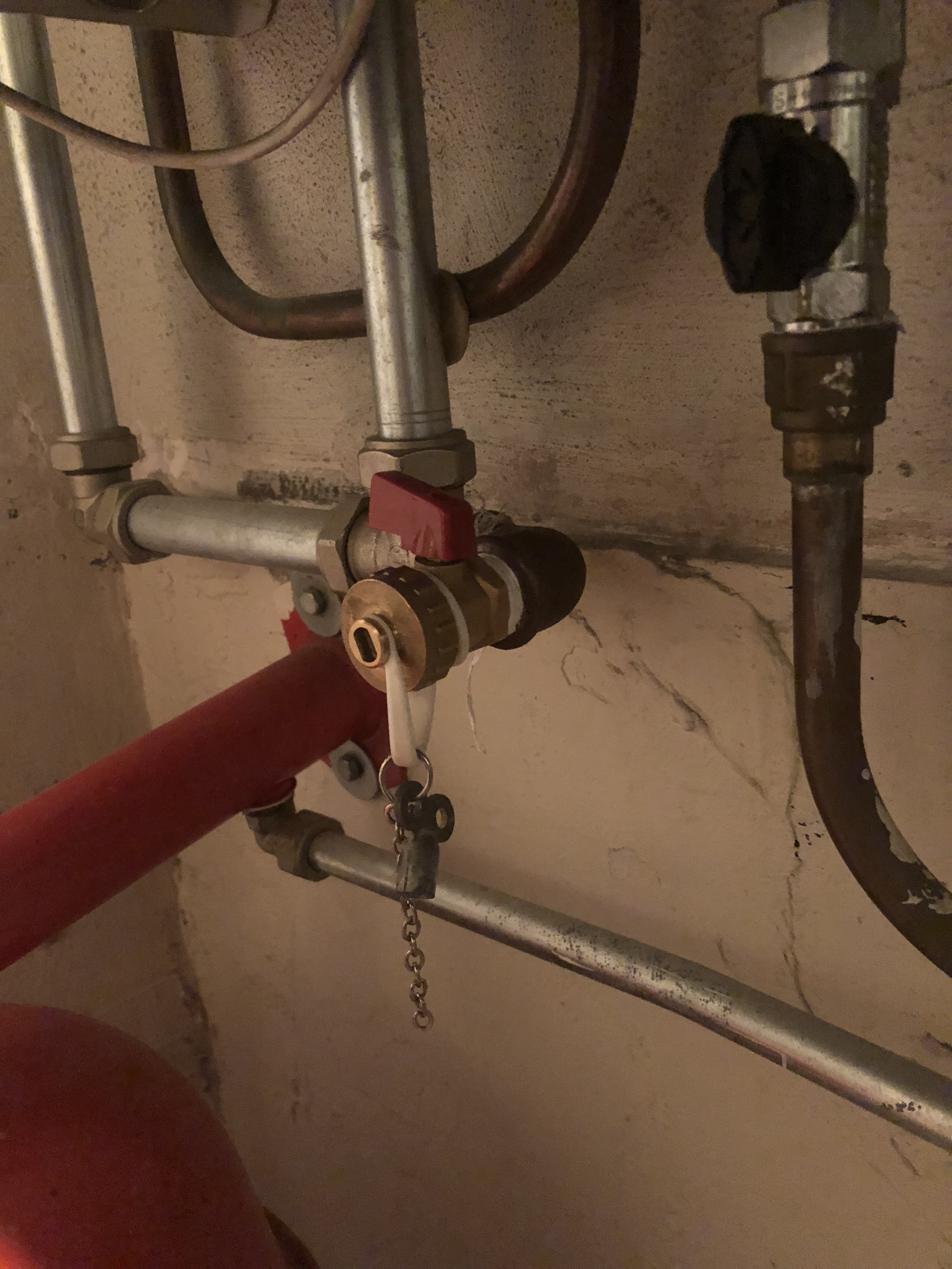

    A few days ago I replaced the valve with the help of which I knocked water on the stove, drained the water, replaced the valve, poured water, bled radiators, everything works, the stove heats, only strong noise is heard, in the pipes, in the oven. I suspect it's air.
    Please help
    Is the stove venting too? If so how?

    I unscrewed the furnace, and you can probably bleed it only by the screw on the circulation pump.

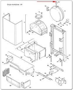

    Rear venting device on the expansion vessel (invisible, access difficult).

    As a colleague wrote above, the expansion vessel is in the back of the furnace behind the combustion chamber. The vent marked in the figure with number 12.
    Slightly unscrew (loosen) the cap at the top of the breather, the air will escape and tighten it again.

    It is in the apartment, but in one room vent tubes ran under the ceiling.
    Thank you, the operation was successful.
