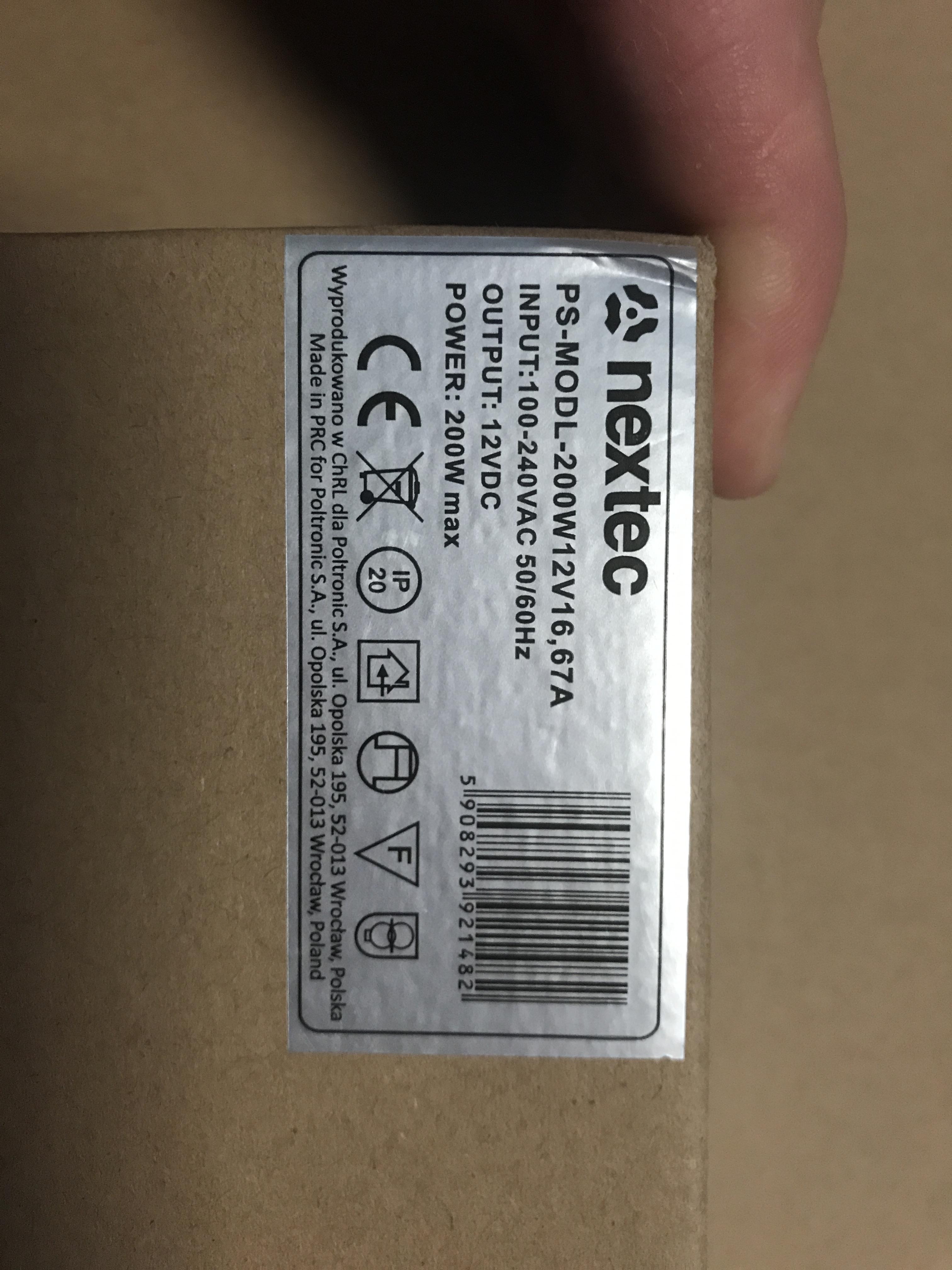

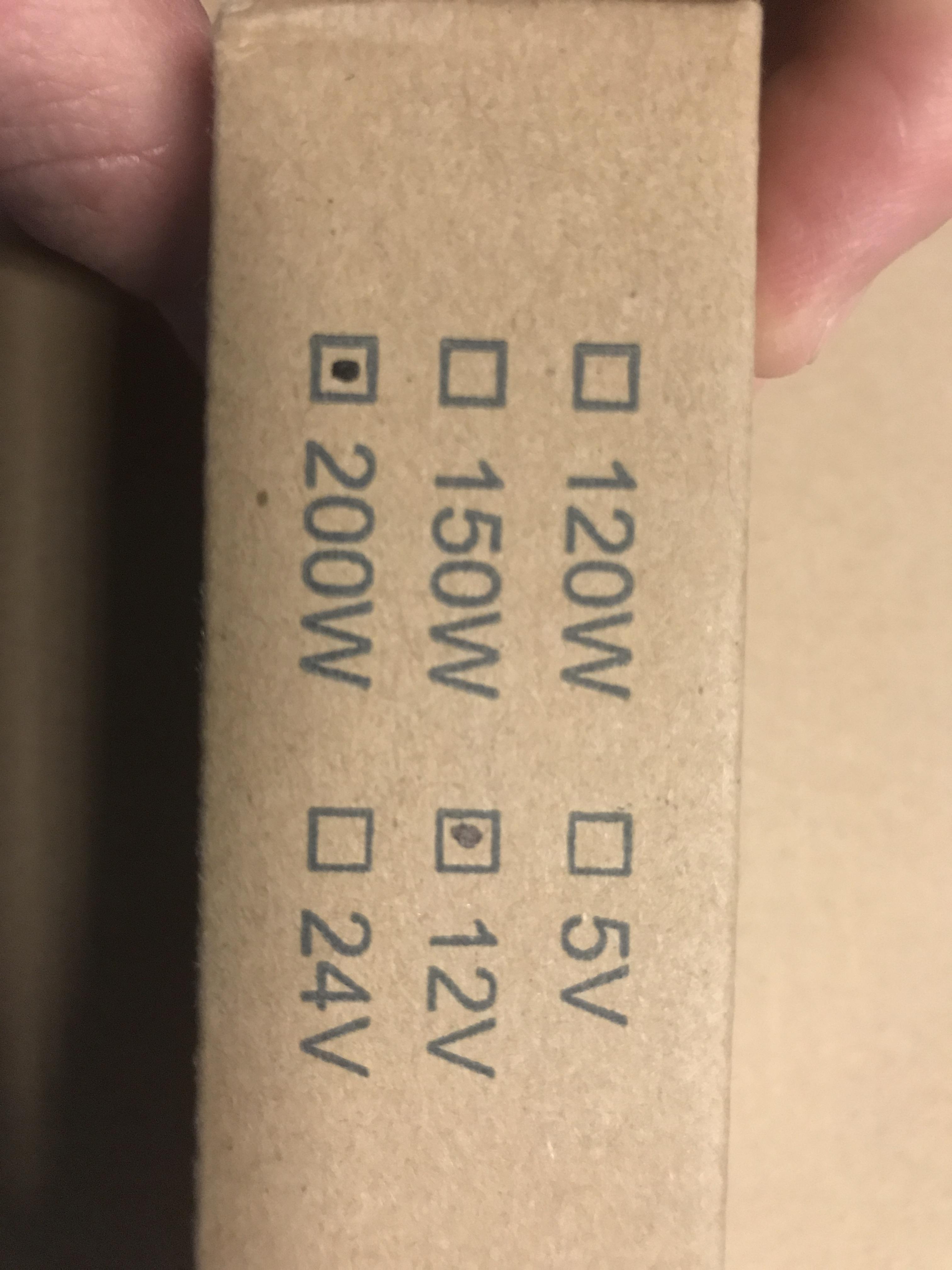

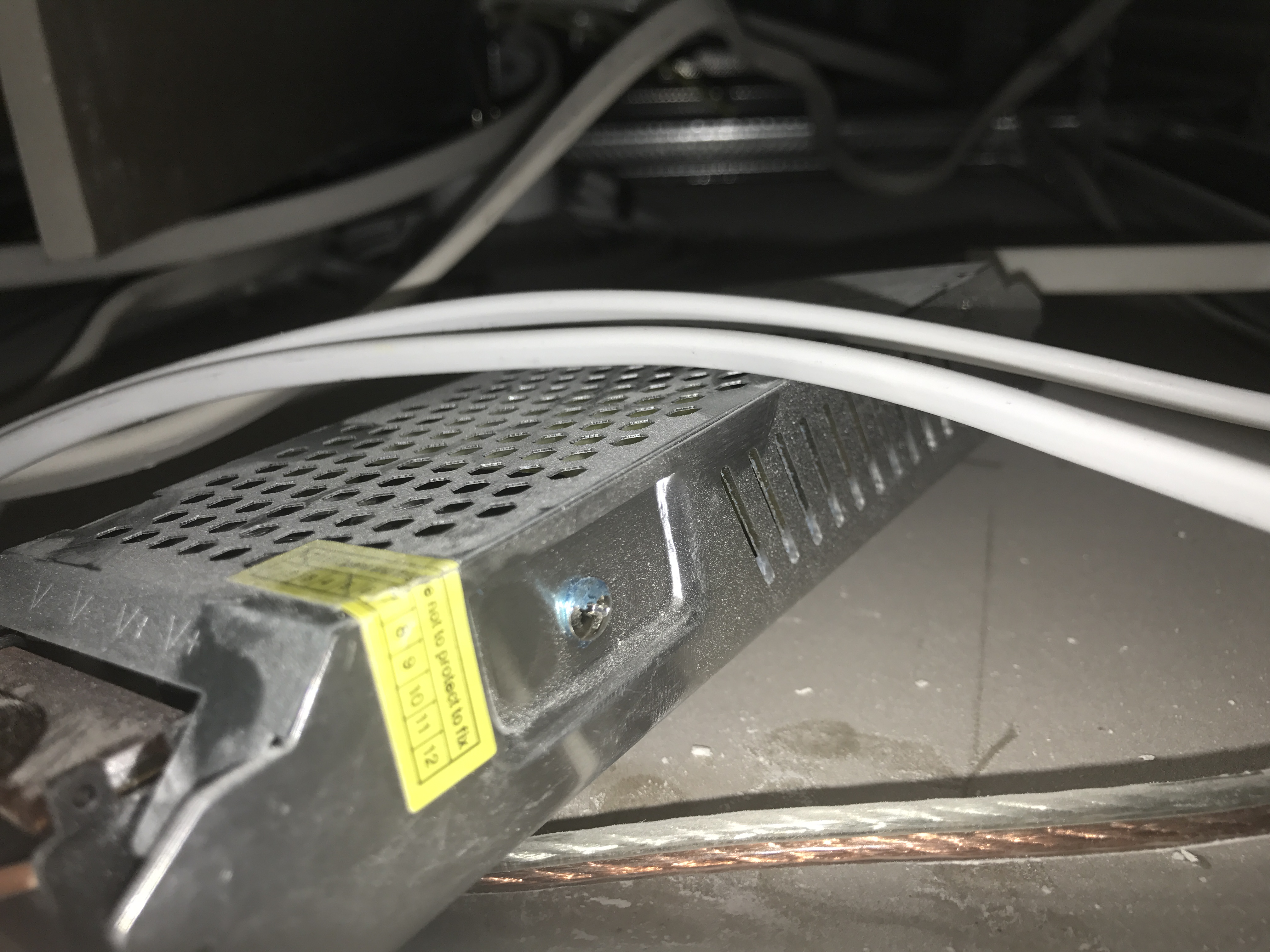

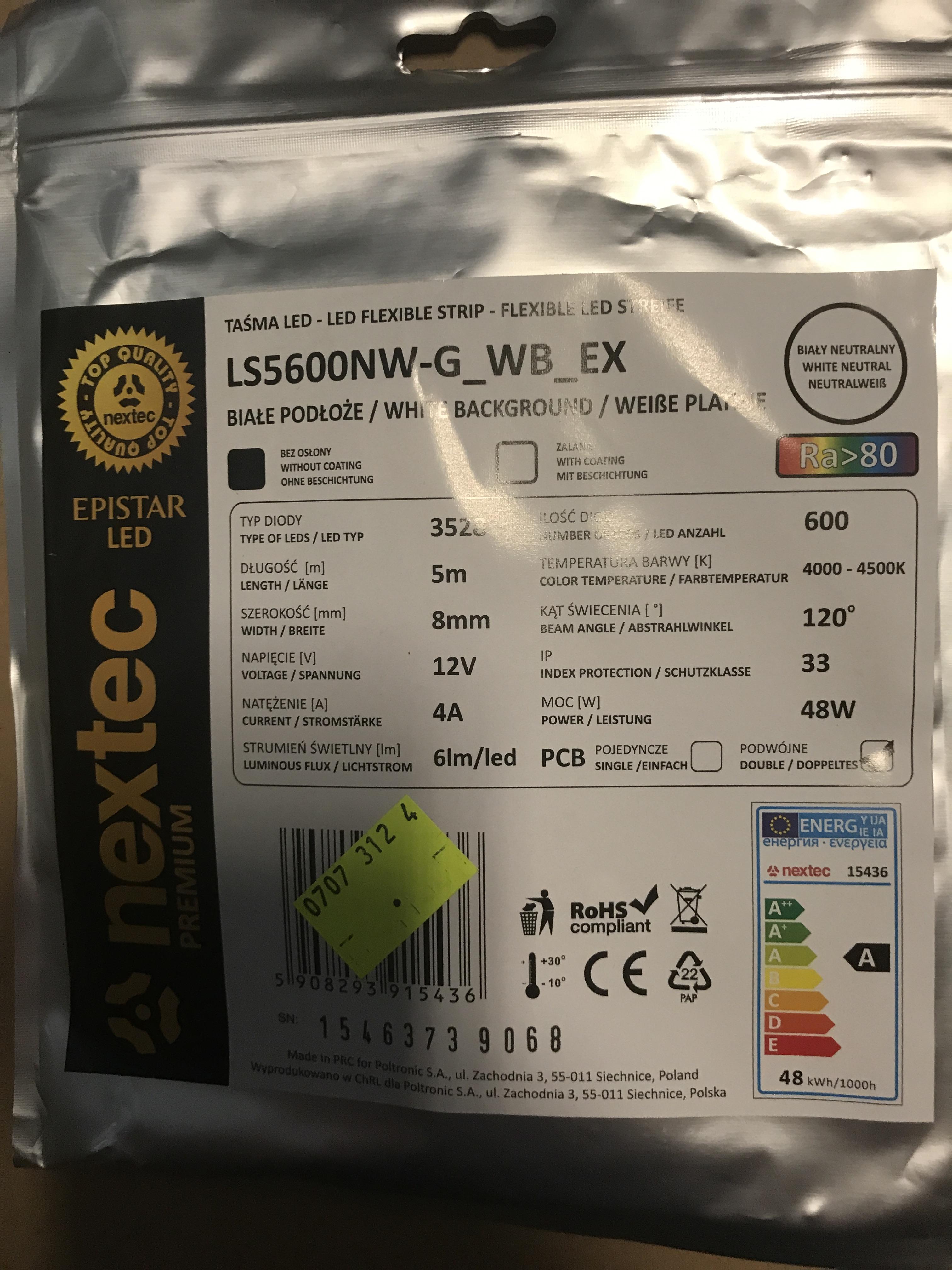

  • #8 17024837
    Kkkp1305
    This is how it looks
    • Radio Interference from LEDs: Solving 230 Halogen, 12V LED Strips & KB Sound iSelect5 Issues IMG_4176.JPG (1.85 MB) You must be logged in to download this attachment.
    • Radio Interference from LEDs: Solving 230 Halogen, 12V LED Strips & KB Sound iSelect5 Issues IMG_4175.JPG (1.55 MB) You must be logged in to download this attachment.
    • Radio Interference from LEDs: Solving 230 Halogen, 12V LED Strips & KB Sound iSelect5 Issues IMG_4169.JPG (984.31 KB) You must be logged in to download this attachment.
    • Radio Interference from LEDs: Solving 230 Halogen, 12V LED Strips & KB Sound iSelect5 Issues IMG_4170.JPG (964.39 KB) You must be logged in to download this attachment.
    • Radio Interference from LEDs: Solving 230 Halogen, 12V LED Strips & KB Sound iSelect5 Issues IMG_4171.JPG (696.21 KB) You must be logged in to download this attachment.

  • #12 17988301
    diantus
    Level 32  
    Posts: 1446
    Help: 203
    Rate: 277
    fzyga43 wrote:
    Use good quality converters included in the kit
    fzyga43 wrote:
    Switching converters in the mains voltage zero
    You write nonsense here. The converters are supplied with DC voltage from the rectifier bridge and operate at a frequency of several kHz. There is no switching at zero here, moreover, it would not have any effect on the operation of the converter in the LED power supply.
    You confuse the concept of power supply with group power control.
    The source of interference are these converters - there are no suitable LC filters at the output.
