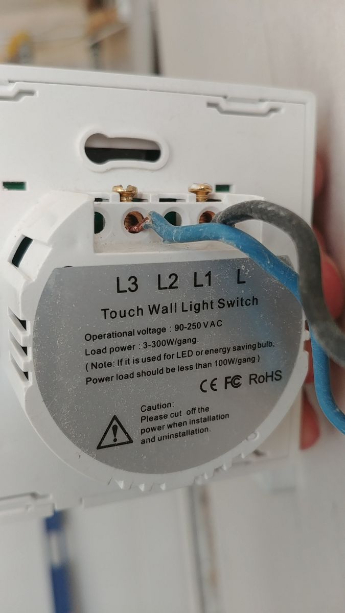

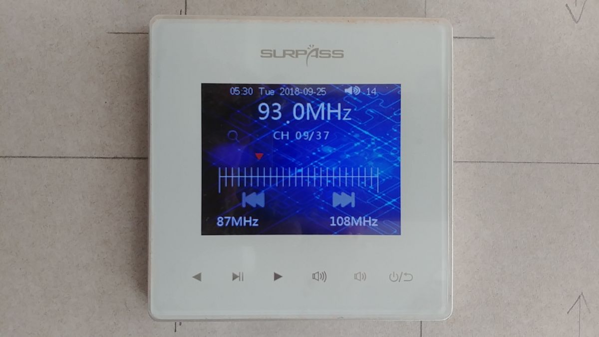

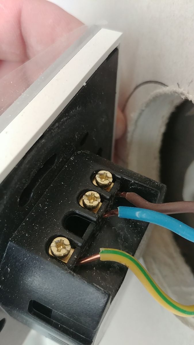

    During the renovation in the whole flat I installed touch switches powered by 230V ( photo no. 1 ). Everything was working until I installed a flush-mounted radio model: Surpass PW215F 2CR310 also powered by 230V ( photo no. 2 ) After starting the device is still ok. The problem starts when I fire up the radio, bluetooth, Mp3 etc. The lighting throughout the flat starts to go crazy. The lights switch on for about 7 seconds and then all go out. When I start the lighting via the switch the leds turn on again for 7 sec and darkness. I should add that the led lighting is also powered directly from the 230V mains. There is no power supply or transformer. The situation returns to normal and correct operation when I switch off the radio and the main menu icons on the unit are displayed. Does anyone have any ideas on how to remedy this. Apparently everything is modern and it turns out that when I turn on the radio I have to sit by a candle to listen to it ;-(
    Interference with LED lighting when Surpass PW215F+2CR310 flush-mounted radio is activated Interference with LED lighting when Surpass PW215F+2CR310 flush-mounted radio is activated
  • #2 19981276
    jdubowski
    Tube devices specialist
    Posts: 21595
    Help: 2511
    Rate: 2808
    This "radio" how is it powered and what model is it?

    Posts: 18
    The Surpass model PW215F 2CR310 is powered directly from the 230V mains.

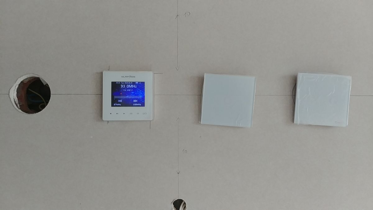

    The radio is installed in an open living room with an annex. The switches (3 pcs) and the radio are exactly 9 cm apart. On the other hand, I also have switches installed in 2 rooms, which are separated from the radio by a wall and then the distance is about 2 - 3.5 m, depending on the room, and they also activate when the radio is turned on. The radio itself works very well, it catches the frequencies nicely and has no noise. As for the PE connection, I don't know what it is (probably not the European Parliament ;-) There were capacitors on the switches but after connecting the LEDs started glowing so they worked exactly the opposite of what they should. Without capacitors, the lighting worked perfectly until the radio was connected. You write about electromagnetic compatibility. Is there any way to compensate for this?

    tangobravo wrote:
    The radio has no ground because the manufacturer has only powered the radio via 2 wires. As far as the contacts are concerned, they are of course grounded. The whole installation was done by a specialist. The whole flat ( 40m2 ) was wired by a professional and divided the rooms into 5 independent sections.
    Show pictures of how they were fitted and connected. You will need to pull them out of the boxes a bit.

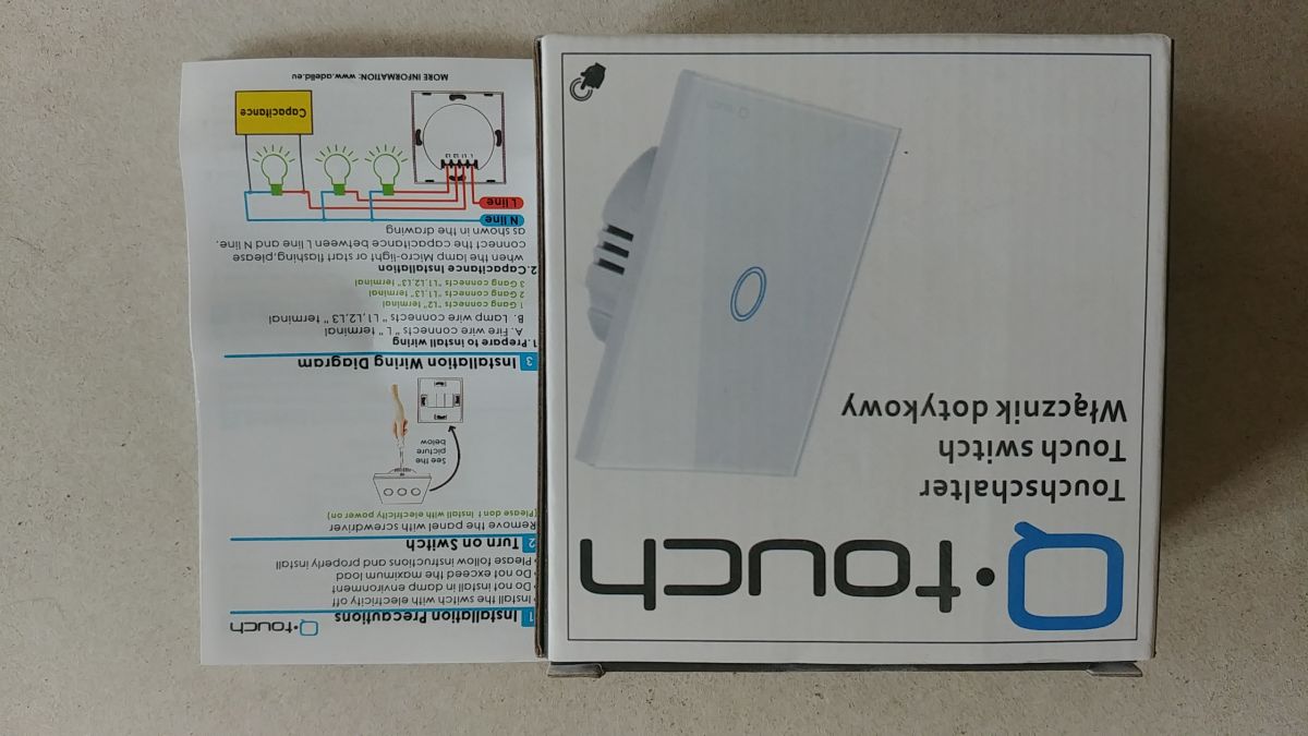

  • Capacitors at switch did not stop LED glow
    #13 19990593
    tangobravo
    Posts: 18
    Thanks mate for the answer.
    Neither the radio nor the switches are mounted in the boxes yet only on the cables. I will take photos tomorrow and send them. Only in the rooms are the switches already mounted in the boxes, but this probably won't be a problem since they are connected just like the others, and the effect is the same everywhere.
    I connected the capacitors directly to the switch and tried the light source. The LEDs always started to glow. Everything according to the diagram in the manual.

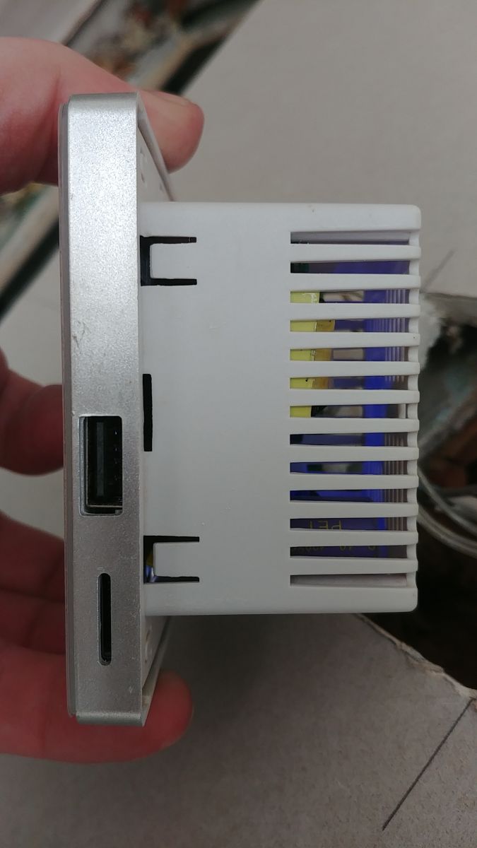

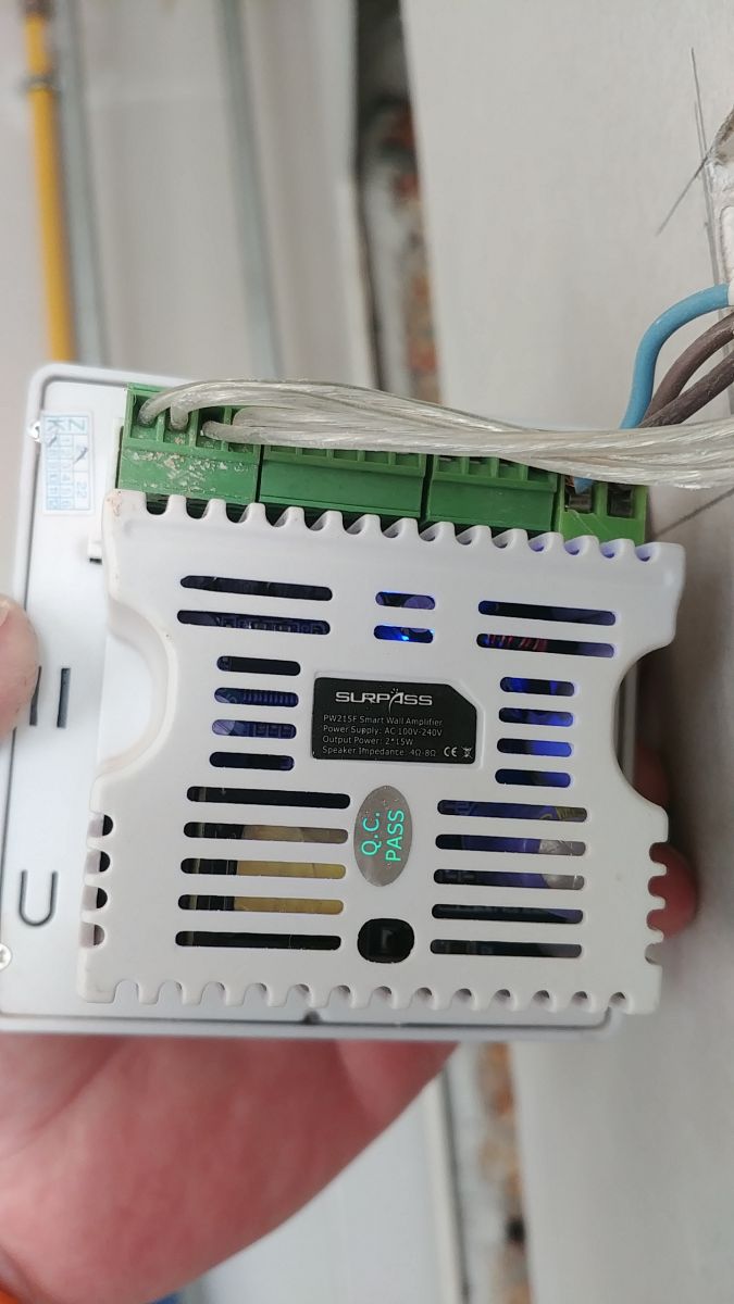

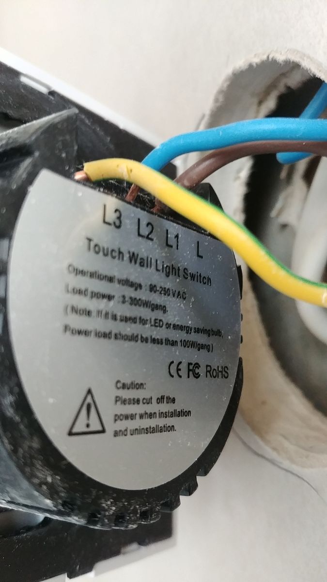

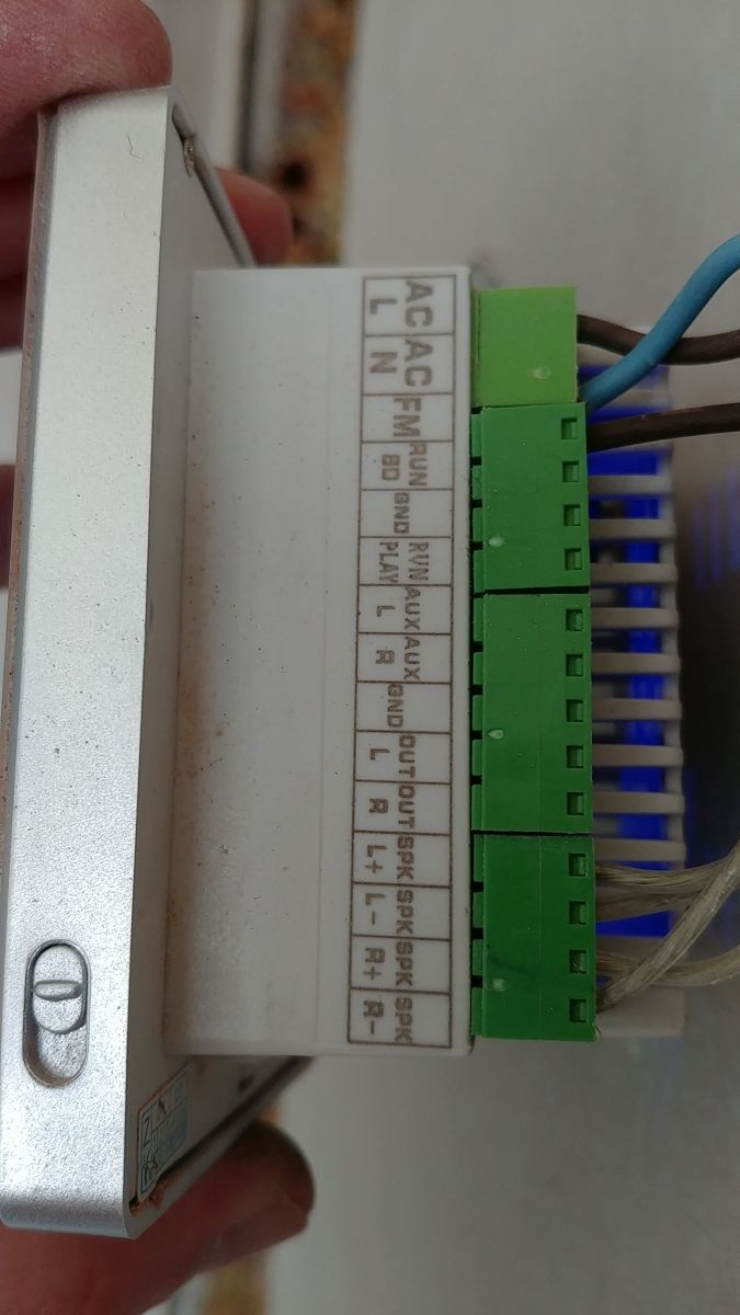

  • Photos provided for interference diagnosis

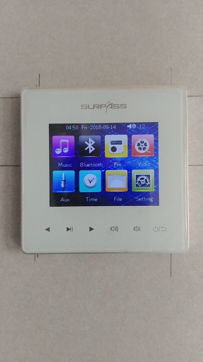

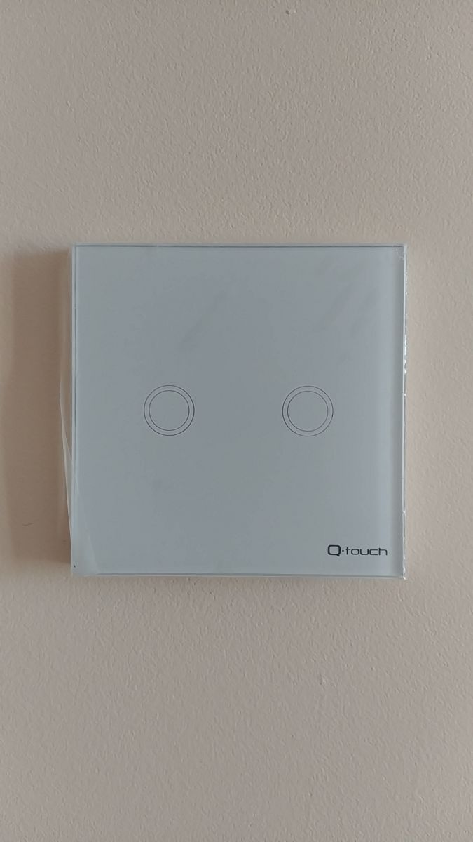

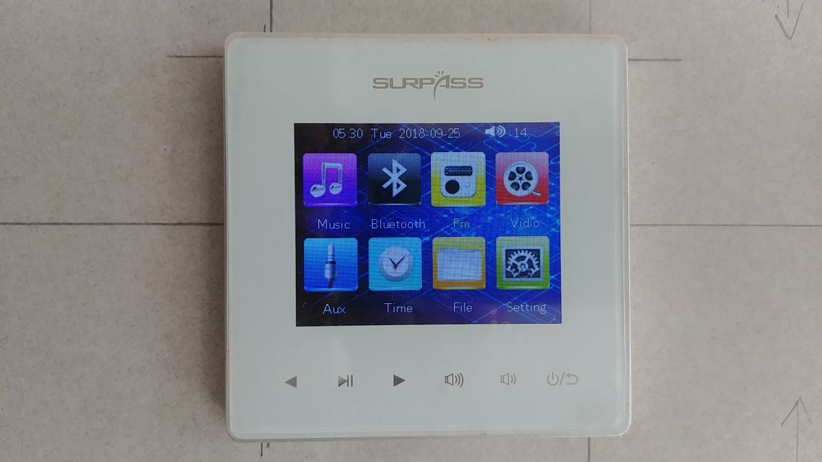

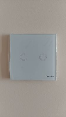

    #14 19991545
    tangobravo
    Posts: 18
    These are the photos I took. If you need any more I will send them to you.
    Interference with LED lighting when Surpass PW215F+2CR310 flush-mounted radio is activated Interference with LED lighting when Surpass PW215F+2CR310 flush-mounted radio is activated Interference with LED lighting when Surpass PW215F+2CR310 flush-mounted radio is activated Interference with LED lighting when Surpass PW215F+2CR310 flush-mounted radio is activated Interference with LED lighting when Surpass PW215F+2CR310 flush-mounted radio is activated Interference with LED lighting when Surpass PW215F+2CR310 flush-mounted radio is activated Interference with LED lighting when Surpass PW215F+2CR310 flush-mounted radio is activated Interference with LED lighting when Surpass PW215F+2CR310 flush-mounted radio is activated Interference with LED lighting when Surpass PW215F+2CR310 flush-mounted radio is activated Interference with LED lighting when Surpass PW215F+2CR310 flush-mounted radio is activated Interference with LED lighting when Surpass PW215F+2CR310 flush-mounted radio is activated Interference with LED lighting when Surpass PW215F+2CR310 flush-mounted radio is activated .
  • #15 19991555
    K3
    Level 30  
    Posts: 1686
    Help: 153
    Rate: 429
    Do I see correctly that the phase is connected to the FM antenna input? :o
  • #16 19991589
    gkwiatkowski
    Posts: 4692
    Help: 650
    Rate: 1232
    Certainly this installation was not done by a professional.
    The green and yellow wires were not used as intended.
    The blue wire is also the phase.
    For all intents and purposes, this installation should not have been accepted for technical inspection due to non-compliance with regulations.
  • #17 19991593
    tangobravo
    Posts: 18
    There is a piece of cable about 80 cm connected to the antenna input. The color is similar but the phase cable is connected correctly this is the first one on the right

  • #19 19991598
    tangobravo
    Posts: 18
    I have already connected exactly as marked in the diagram. The lights then glow.
    #20 19991613
    gkwiatkowski
    Posts: 4692
    Help: 650
    Rate: 1232
    Strange.
    And how do the switches then respond to the radio?
  • Radio activation causes LED backlight to glow
    #21 19991616
    tangobravo
    Posts: 18
    From what I've read on the forum the capacitors work well in mechanical switches with LED backlighting. In my case they were added in the set. I bought the switches in a Polish shop. Up to the moment of connecting the radio they worked flawlessly and they still do, as long as I switch off the radio. I don't even have to switch it off completely, just go to the menu in picture 3 and everything lights up beautifully.
    Exactly the same. Lighting comes on for about 7 sec then doesn't go off just glows.
    To clarify. The lighting switches on at 100% power for about 7 sec then goes out but the LEDs glow.

  • Suspected faulty switches or radio causing interference
    #26 19991858
    tangobravo
    Posts: 18
    I have already tried and unfortunately nothing has changed but thanks for your interest in the topic.
    Greetings
    Added after 22 [minutes]:
    gkwiatkowski wrote:
    Unfortunately it is probably the switches that are faulty after all.
    https://www.elektroda.pl/rtvforum/topic3776410.html
    Possibly, admittedly they have an EU certificate and power parameters of 90-250V but it's clear they're Chinese. Tomorrow I'll take the glass off some more and look if there is any change. I can also power the player directly from my neighbour's flat (extension cord), but I personally think that this will do nothing because the problem is either in the radio or in the switches. I am ruling out the electrical installation. I would bet on the radio because I have a few other electronic gadgets installed in my flat (smart alarm, wireless PIR detectors, wi-fi 360 PTZ camera and a few others) and everything worked fine until the radio was installed.
  • #27 19992284
    jdubowski
    Posts: 21595
    Help: 2511
    Rate: 2808
    tangobravo wrote:
    When the antenna is disconnected, nothing changes.
    The radio probably "sows" from the inverter, and the switches are also some kind of Chinese product.
    I would replace the switches with some branded product for a trial.

  • Radio interference suspected on distant touch switches
    #29 20763720
    ArtGraf1
    How did you deal with the problem? I have a similar situation. After connecting the surface-mounted radio, I have a problem with the two touch switches (both single). When the radio is playing they cannot be switched on and off, but when the radio is not playing everything works fine. One switch is on the other side of the wall and the other is about 4 meters away. Both are on different circuits. The double switches, which are closer to the radio, work without any problems.
    My opinion is that the radio is generating some interference.
