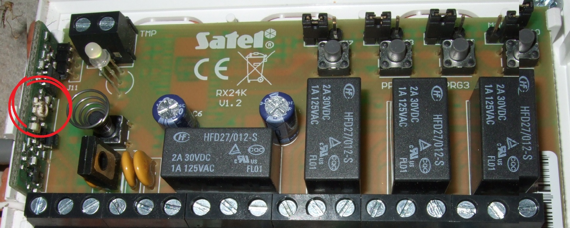

    I have purchased a SATEL RE-4K control panel. The control panel is mounted in a polystyrene cut-out, on the facade, about 6m above the ground. A 7-wire cable enters the house and runs down an unused chimney flue to the basement where the gate control is. The control panel is powered by a MeanWell 12V power supply. The control panel will work when first connected. It was possible to control 4 channels from the basement.
    The next time, it no longer works. I.e. it works, but the range has dropped to a few metres. The batteries in the remote control have of course been replaced with new ones.
    The control unit is located approx. 40cm above the electrical connection, the cable from the pole is fixed and goes into the wall. Could this location have a negative effect on the radio line?

  • #7 17834867
    elektro16
    Posts: 172
    Help: 10
    Rate: 63
    If you start to combine with the antenna it can be worse .In this module is a superreactive receiver and can jitter . I use two such modules .One on the chimney at a height of about 8 m connected to the integra with about 5 m cable - range of about 200 m .The second at a height of about 2.5 m real range of about 25 m .
    If the batteries are weak the control panel displays the alarm .Both modules work inside on the roof concrete tile I would suggest checking on a new remote control I had similar stories - the diode flashes and does not work . I replace the remotes on average every 2 years . And the power supply pulse or transformer ?
    If you have impulse power supply (which you probably have) then replace it with transformer . Generally these modules are powered from the control unit . Is the same power supply for the actuators and the module ? Does the LED flash red when you transmit ? Many questions ...

  • #10 17836589
    adversus
    Level 32  
    Posts: 1607
    Help: 188
    Rate: 597
    It would be worth checking the signal level with a tester. I generally mount Elmes radiolinks (in my opinion better range and more reliable operation), and here I use the RFM4 tester in difficult conditions.... I just don't know if there is anywhere to plug in the satellite receiver. The indicator works sensationally, because in addition to the signal strength it also shows the noise at the receiver site, which can prevent it from working properly.

  • #11 17836640
    crisdean
    Posts: 141
    Rate: 31
    elektro16 wrote:
    Control unit and remote controls new or used ? Using a power supply with a current capacity of 6.3 A to supply only the module with a current consumption of 65 mA max ?
    Yes, I used one that I just happened to have at home.
    adversus wrote:
    Basic question is whether you bought a new radiolink (receiver) or is it used, on the radio receiver board in the radiolink you have a trimmer, see if it is not damaged. Is it possible that during installation/testing you inadvertently managed to disrupt the radio? Also check for cold solder on the antenna, i.e. gently dismantle the whole radio board and see what the soldering points on the radio board look like underneath, it is soldered on goldpins and cold solder happens there.... In the picture below you have it marked with the trimmer I mentioned earlier.
    Yes, the control panel was new. The board looks perfect. the solders are liquid tin coloured. They are OK. All I can do is re-solder the antenna. The trimmer, in a slightly different form, is there, bank not touched. Also, after assembly, a few days before I switched on the voltage - after switching on I checked - it worked from the basement, about 20-30m through thick walls and ceilings. after a few more days it only works when you control a few m from the receiver. The price is not knockdown, but the point is the connection to the house itself, did it "upset" the radio?! i have no idea if it can have a negative effect.

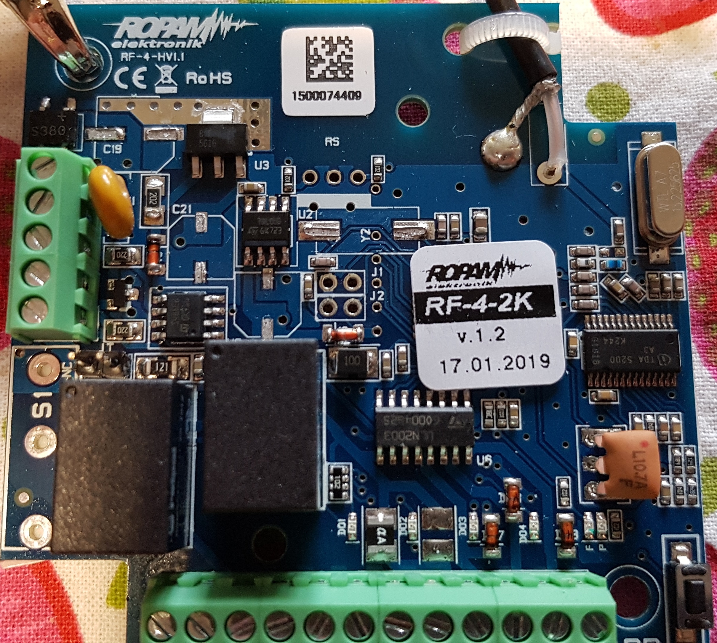

  • #15 17836719
    crisdean
    Posts: 141
    Rate: 31
    Just purchased today, will return if necessary:
    ropam RF-4-2K .
    We'll see how it performs. Someone recommended it to me because of this antenna.

  • #17 17836967
    crisdean
    Posts: 141
    Rate: 31
    I have been extremely unlucky. I just received a package, opened it and there was a surprise. A DIY kit. 4 pieces fell off the board. I no longer have any doubts. I return the money and reach for Elmes. Photos to prove it.
    I do not reveal the identity of the seller - I trust that it is a simple, unfortunate coincidence.
    Satel RE-4K Radio Panel Range Issues: Installation and Interference Concerns Satel RE-4K Radio Panel Range Issues: Installation and Interference Concerns Satel RE-4K Radio Panel Range Issues: Installation and Interference Concerns .
